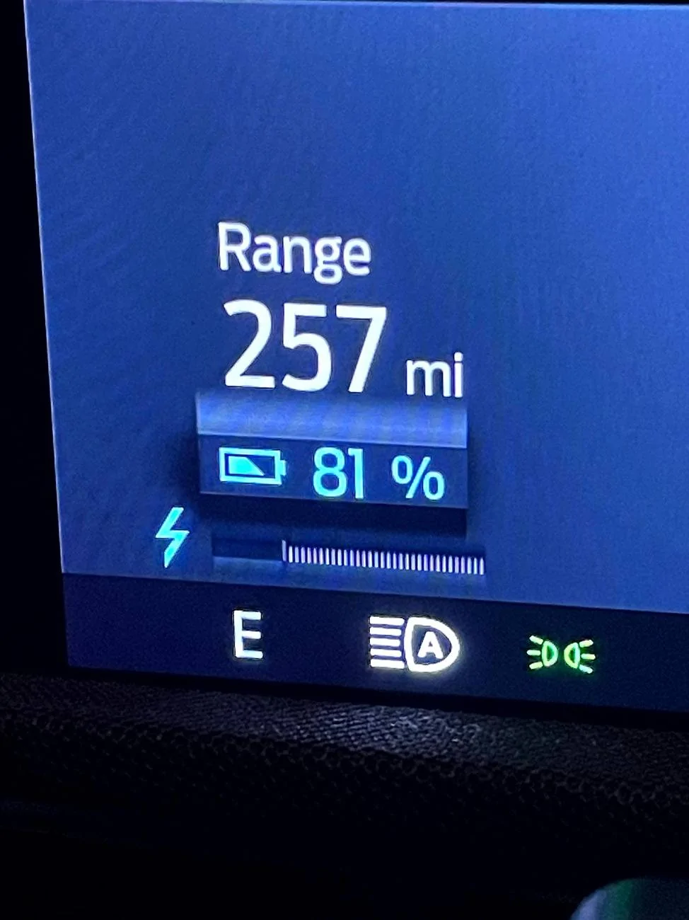

So I enabled the power meter months ago and it worked great.
https://www.macheforum.com/site/threads/how-to-enable-power-meter-on-non-gt-mach-e.18783/
This last round of FDRS updates I did seem to have broken it. While the updates were being applied all sorts of errors were thrown by the car, normal for FDRS updates. One of those updates seems to have lit up all the jail bars.
In its current state it only shows the green bar during regen but never shows the blue bar during use.
Should I undo the change using Forscan?
Should I use Forscan to force the IPC to reboot?

I have exactly the same problem after doing the latest FDRS updates. I used FORSCAN to turn off the power meter, then turn it back on but no joy. I did not try the reboot but probably should.
The updates were for PCM, SOBDMC, SOBDM, BECM, BCM and DSM. I have no idea which individual update caused the problem.
A pain.

I am thinking it was the BECM. That one threw a temporary service vehicle now message during the programming for me.

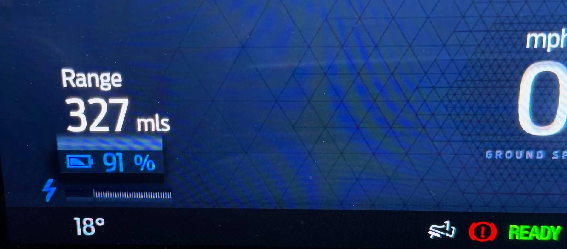

A sad +1 in the same situation.
Had my HVBJB replaced at the dealership yesterday under the 23S56 recall program. They updated my powertrain software as part of that, and when I got the car back today my FORScan enabled power bar has also now become a re-gen only bar.
Shame as I really liked it the way it was before.
