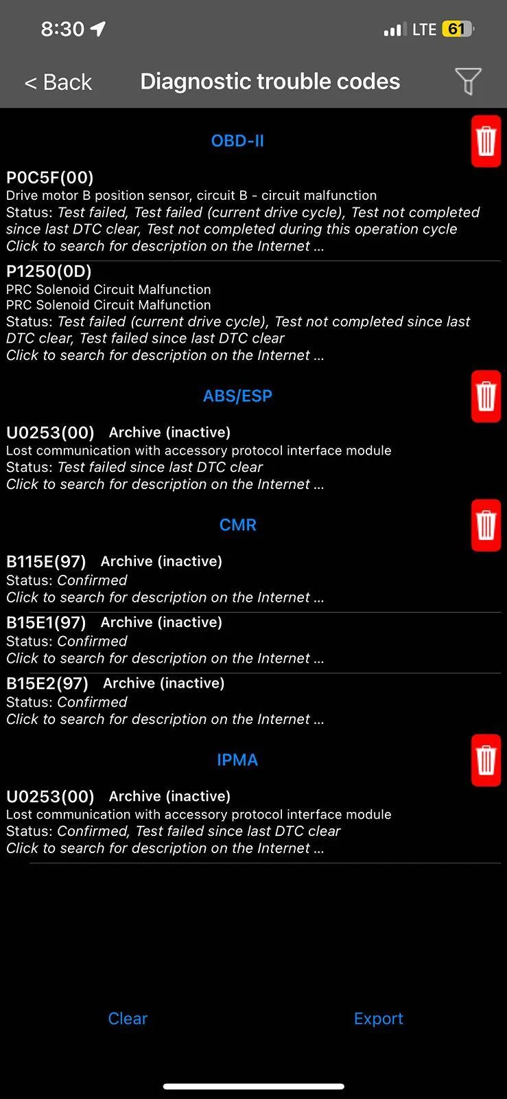

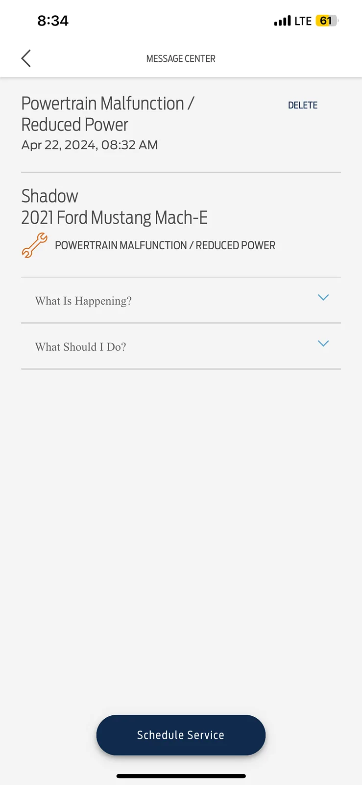

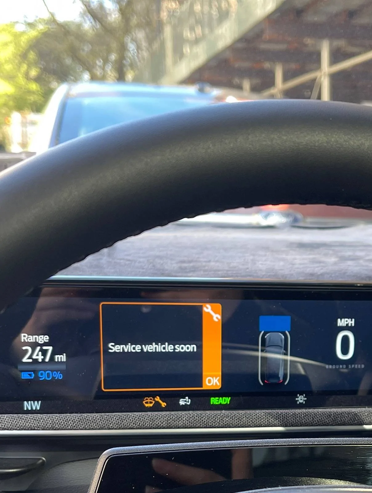

Hey, so just turned my car on this morning, after driving it on Sat for a few hours and fast charging. Everything was fine this weekend. But now i turn on my car and see the warning messages.
I just ran the codes, I aslo see this error? Its different codes each time I run it, so idk whats accurate or not.
Ford Mustang Mach-E Powertrain/Service vehicle soon error? IMG_2600
Anyone know what it could be? Turned the car off then back on and no more serivce icon appearing.

There are more codes you’re not scanning, check all modules.
:( Last time I ran all the codes, someone said they were not for my vehicle. So I just left it on the way the carscanner had it already set up. Im not by my car the moment, but when I go to my car, just select all the options and dont run the ones already preselected in carscanner?

Service vehicle soon trumps the recall and gets higher priority. Do you mind sending your VIN so I can see what’s going on?

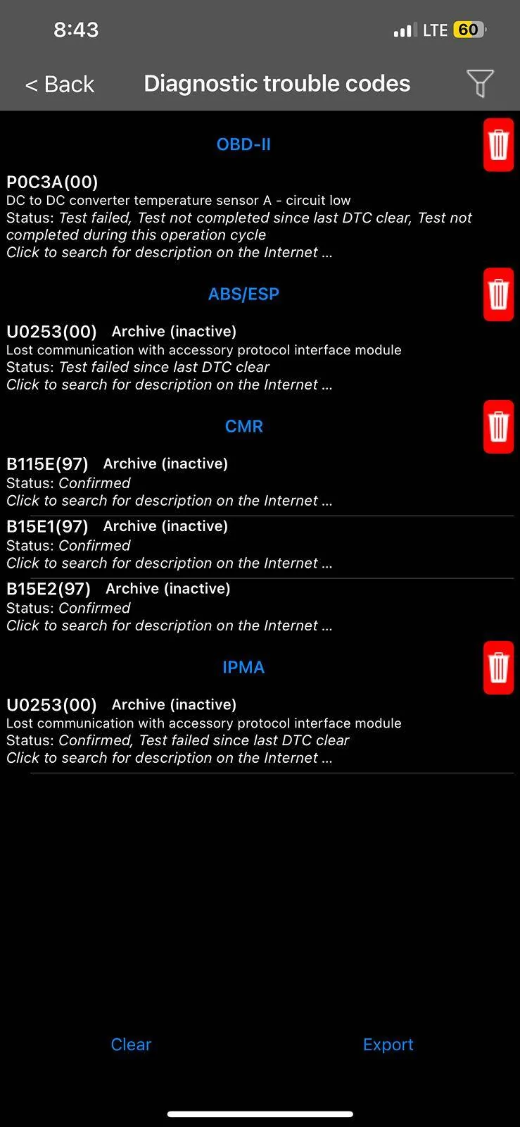

You must have cleared the codes yourself (so dealer won’t find anything). In the history I see a P0929 code. That is the gear shift bug. Don’t turn the shift knob without putting your foot on the brake first or you’ll get a powertrain error.
Dealer needs to update the GSM module and or replace it of its from a bad batch. See this SSM: https://www.macheforum.com/site/thr...ht-with-dtc-p0929-77-stored-in-the-gsm.23309/
The problem was NOT caused by the HVBJB.
I made sure not to clear anything. I was just running the codes, but maybe I did do something? Its just weird cause whenever I ran it, the same codes never show up.
I did see this at one point as well.
