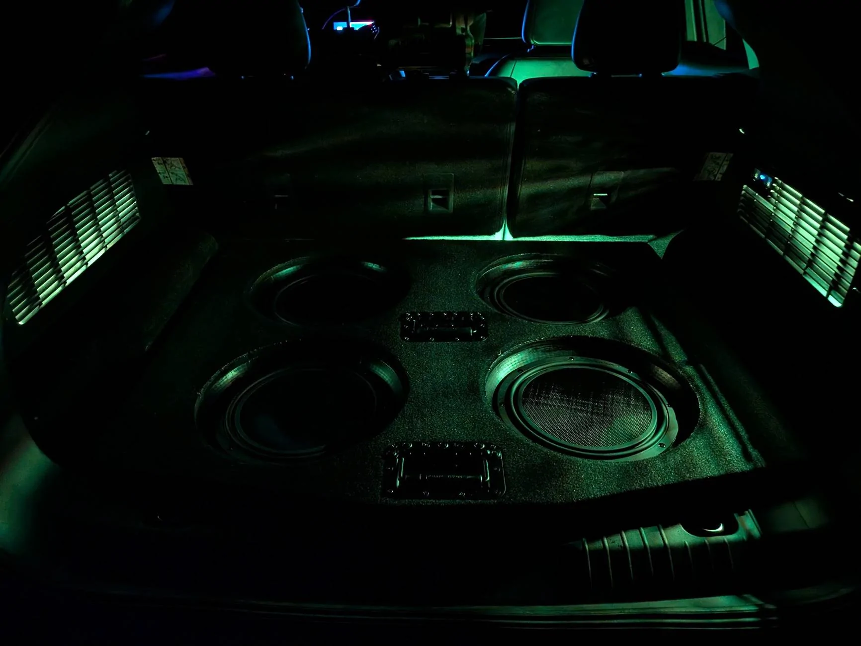

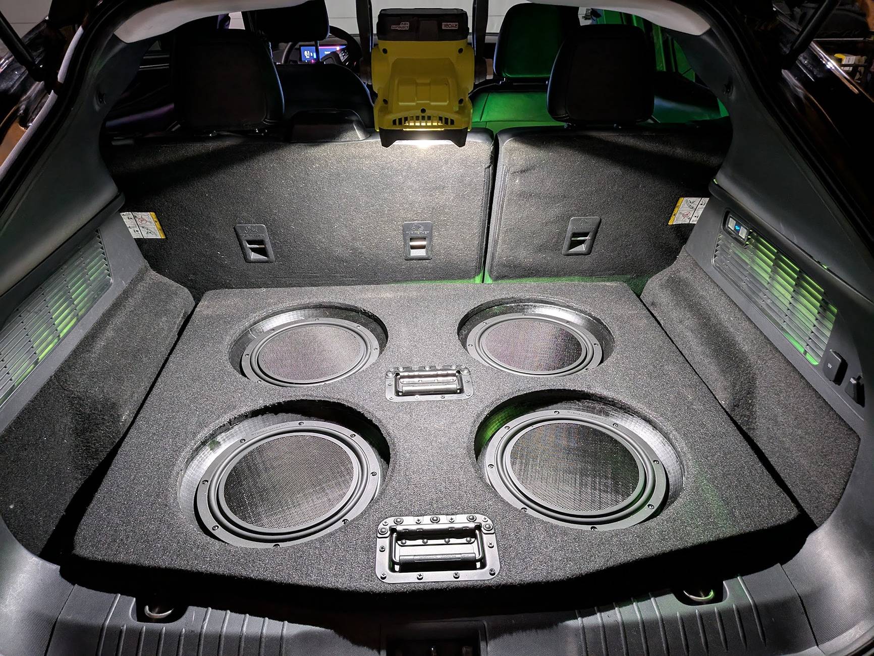

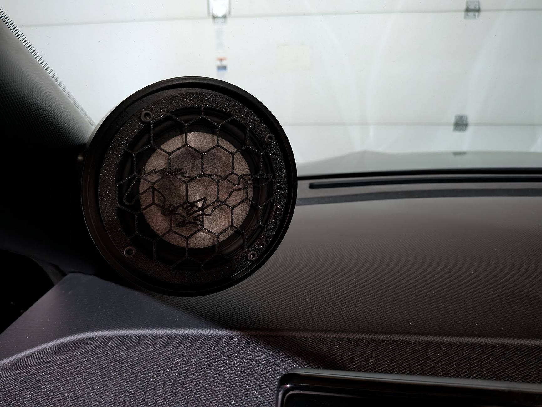

BTW consider this an invite to come visit and have a listen at AXPONA! I'll make a post with full details, but I'm in crunch mode for a few more weeks prepping. Once the work is done I'll share more, but here's a taste!
Ford Mustang Mach-E Prepping car for convention dashpod grille
Ford Mustang Mach-E Prepping car for convention new sub 3
Ford Mustang Mach-E Prepping car for convention new sub 2
