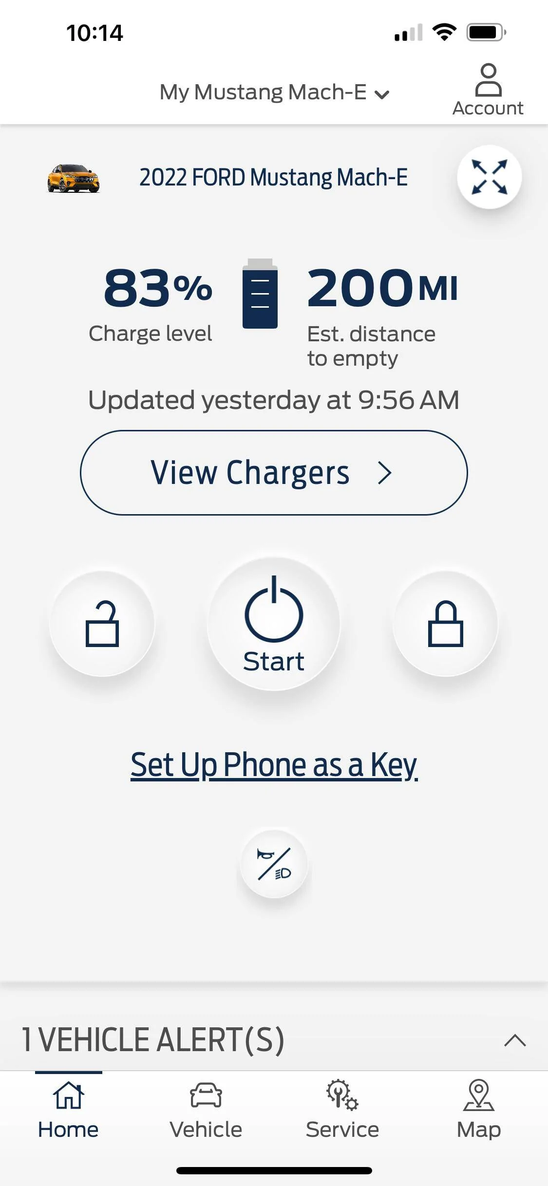

After an overnight OTA update on Friday, the icon on the FordPass app would not successfully open the frunk. After working with Ford support for more than an hour on Friday (deleting/reestablishing my account; deleting re-downloading the app), now I’ve lost four of the five icons on the FordPass app. waiting for response from an escalation within the Ford software team. anyone else experiencing this?

this is how the FordPass app looks now

Each icon/button that’s disappeared is directly tied to Paak (BLE functions).
You’ve mentioned that you’ve deleted and reinstalled the app amongst a few other things. Have you attempted to reconfigure Paak?

no, I do not know how to reconfigure PAAK

in your vehicle, there should be a list of settings where you can reset phone as a key. you want to go there and try to reset it up.

thanks, resetting PAAK solved it.

You could start by pressing the link "Set Up Phone as a Key" in FordPass, and it will walk you through it.
Also, FordPass is sometimes blippy and waiting it out is usually a better strategy than deleting / re-installing apps and accounts.

thanks, resetting PAAK fixed it
