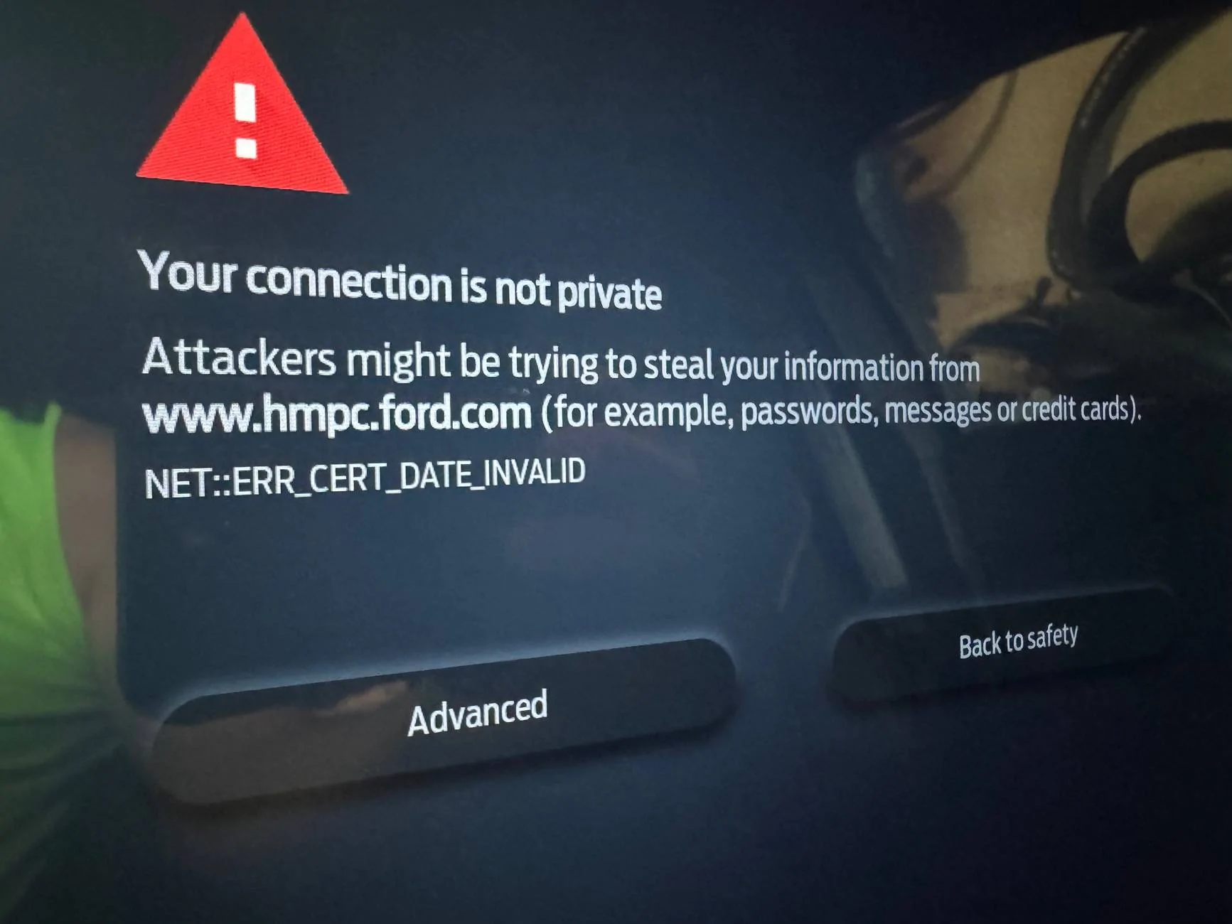

Anyone know what to do when I opened the Public Charging app and this shows up?
They are using an internal version of Chrome to launch a web page. The entire public charging app is basically just a website inside an app container. So like on the desktop, you could probably click “advanced” and “proceed anyways”.
Since the error pertains to an invalid date, check your vehicle time/clock to make sure it is correct. If it is, then it’s likely a server side issue.
Thank you. I just did a 12v battery reset prior to this and did not realize the time were off. After changing the setting to auto update time it work. Much appreciated.
