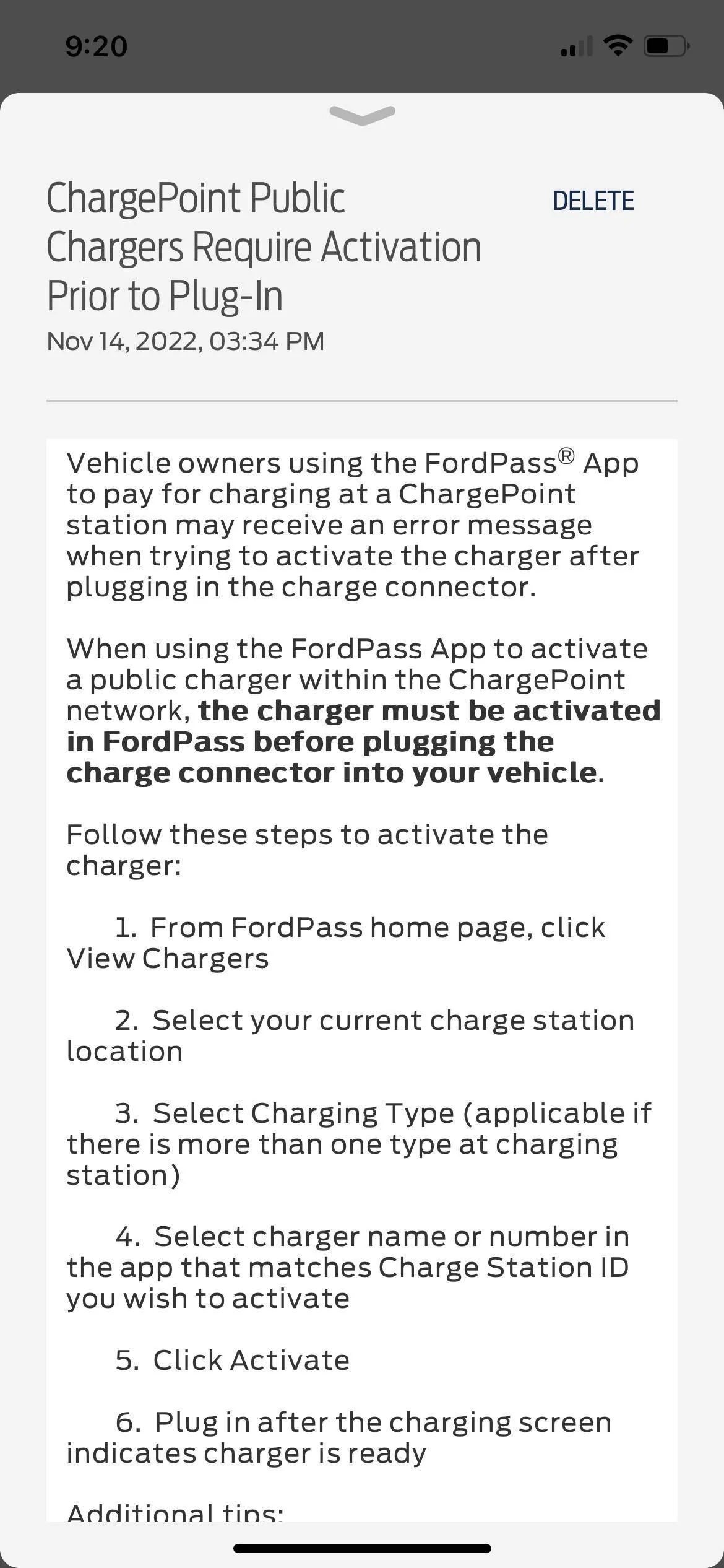

  1. Check PlugShare reviews before leaving on a trip. Avoid any stations with issues reported.
  2. Hopefully you saw this, otherwise use the ChargePoint app:
    Ford Mustang Mach-E Public Charging Fault Errors AF98D75B-695C-492E-9F8E-25492B9E05F2
  3. Remember to plug in fully. Partially inserted plugs generate charge faults.
