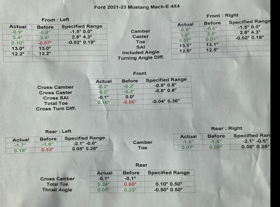

Posted here are the before/after alignment results.
Problem is that the car is slightly pulling the right before the alignment, and persists after. I let go of the wheel and within 2 seconds the lane-assist is popping me back, and that repeats until I have to sit and hold the steering wheel. Numbers seem OK - any ideas?

Those readings look good to me, shouldn’t be the geometry that’s affecting anything.

I would have the shop take a look at the car again. I recently experienced a similar issue after an alignment. A second visit addressed the issue after I expressed my concerns and experience.
I don't know what they did the second time to fix the issue, but I suspect that my steering wheel wasn't centered when the alignment was performed the first time.
