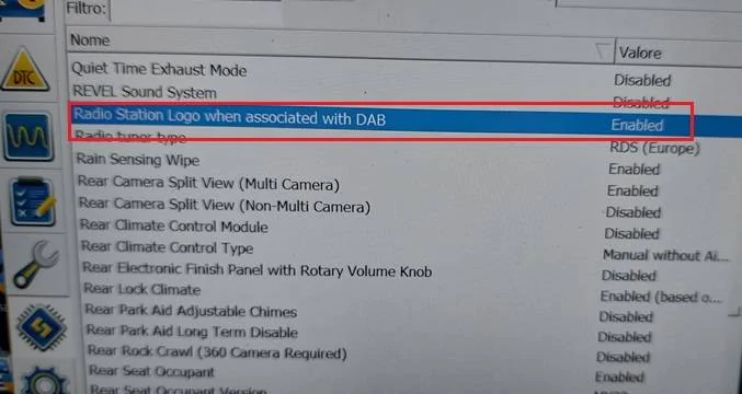

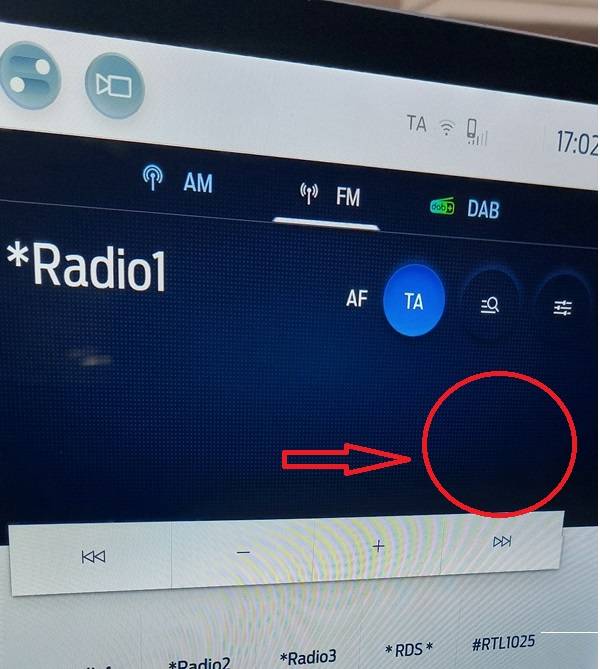

After a SYNC update all the radio icons disappeared, not only on the buttons, also on the selected radio station window for any radio FM or DAB. Storing again the radio or a SYNC soft reset does not solve the issue. Is there a way to proceed?

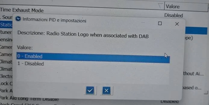

SOLVED
Finally I restored the radio icons using Forscan in the APIM programming mode. The missing icons in the photo appeared saving the radio station again.

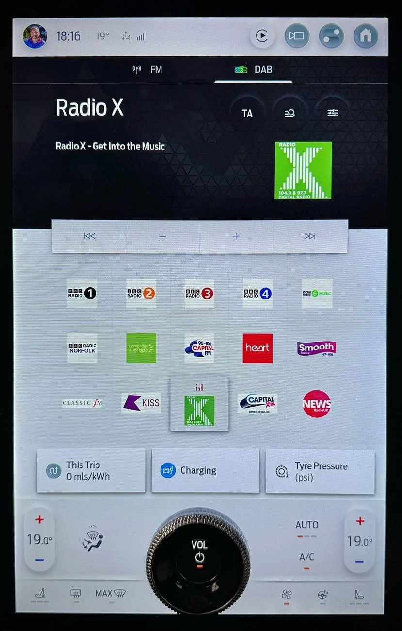

A huge thank you - I got my station icons back at long last today thanks to this post :love:
