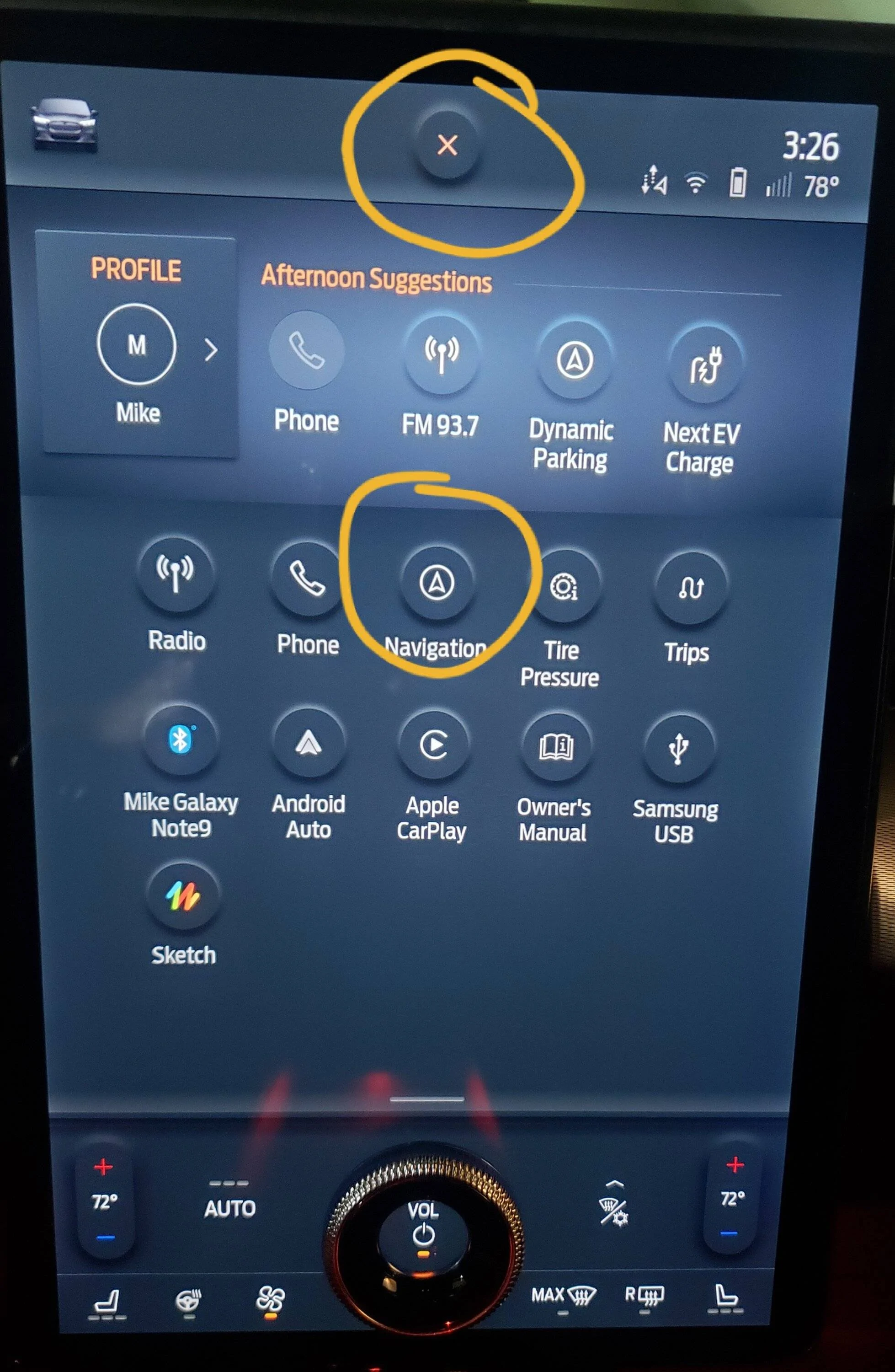

Did you select your profile icon and see what is in the list of applications/links there? I am sure you tried that, so just confirming. Maybe you can take a picture of what that looks like and share it with us. We might see something that can help.
I don't think I found it there, but I could be mistaken. It is usually (always?) in the lower tiles on the display screen, and it was no longer there, hence trying to open navigation via voice command. Thanks for your input!

A lot of people don't seem to understand the difference between the cards (tiles) and the App Drawer. It makes perfect sense to me, but judging by the number of people that post here about their apps disappearing, it must not be as intuitive to everyone as it is to me.
Never depend on the tiles, they're just shortcuts to recently used apps. The apps permanently live in the App Drawer.
I've been "learned", but unfortunately it takes a failure on either Ford's or my part to keep getting smarter. Now, if I can only figure out how to check the oil.
I thought that might be the issue. Touch the profile icon at the center top of the screen and then you will see the list of apps available.
