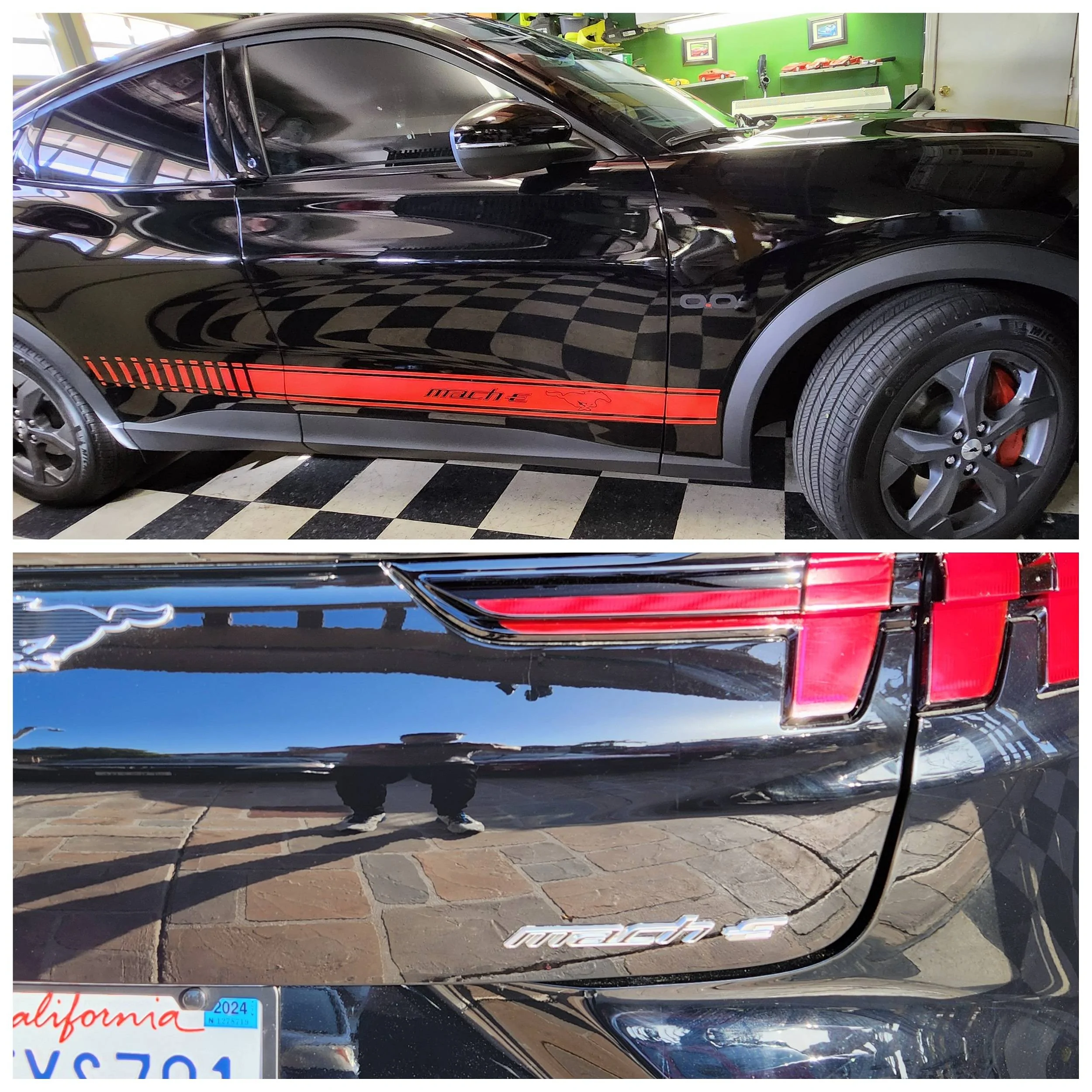

Replaced side badges with stripes and moved badge to tailgate.

It looks great. I was thinking about debadging the doors. Never thought about putting on the back. I like it.

Removal was super easy, barely an incovenience. Heat gun surrounding area, use dental floss to lift it off, then the remaining adhesive easily rolls off when rubbed with finger.

I very much like the way the stripe sets off the red calipers. Nicely done.

Thanks, "Wednesday" theme dictates all black with touches of blood red. Did it with the brake lights as well. :)
You had me at Wednesday!

Beautiful work! May do the same once mine comes in. What method did you use to change the colors on the calipers to red? That's one of the first mods I wanna do

I used POR Caliper paint (~$20). Just tape up the area, use a narrow and wide art paint brush, and apply multiple coats.

Cool, thank you!
