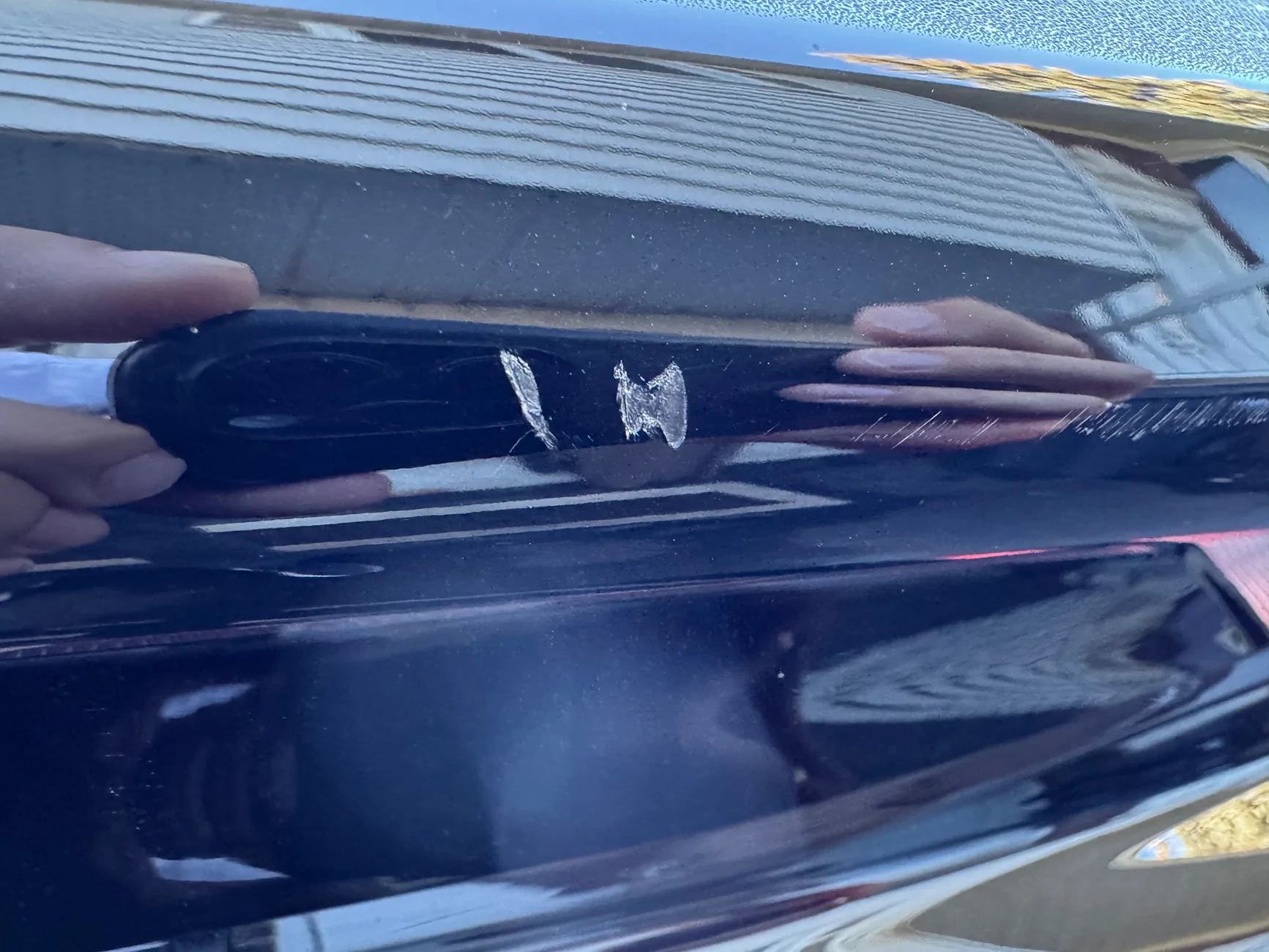

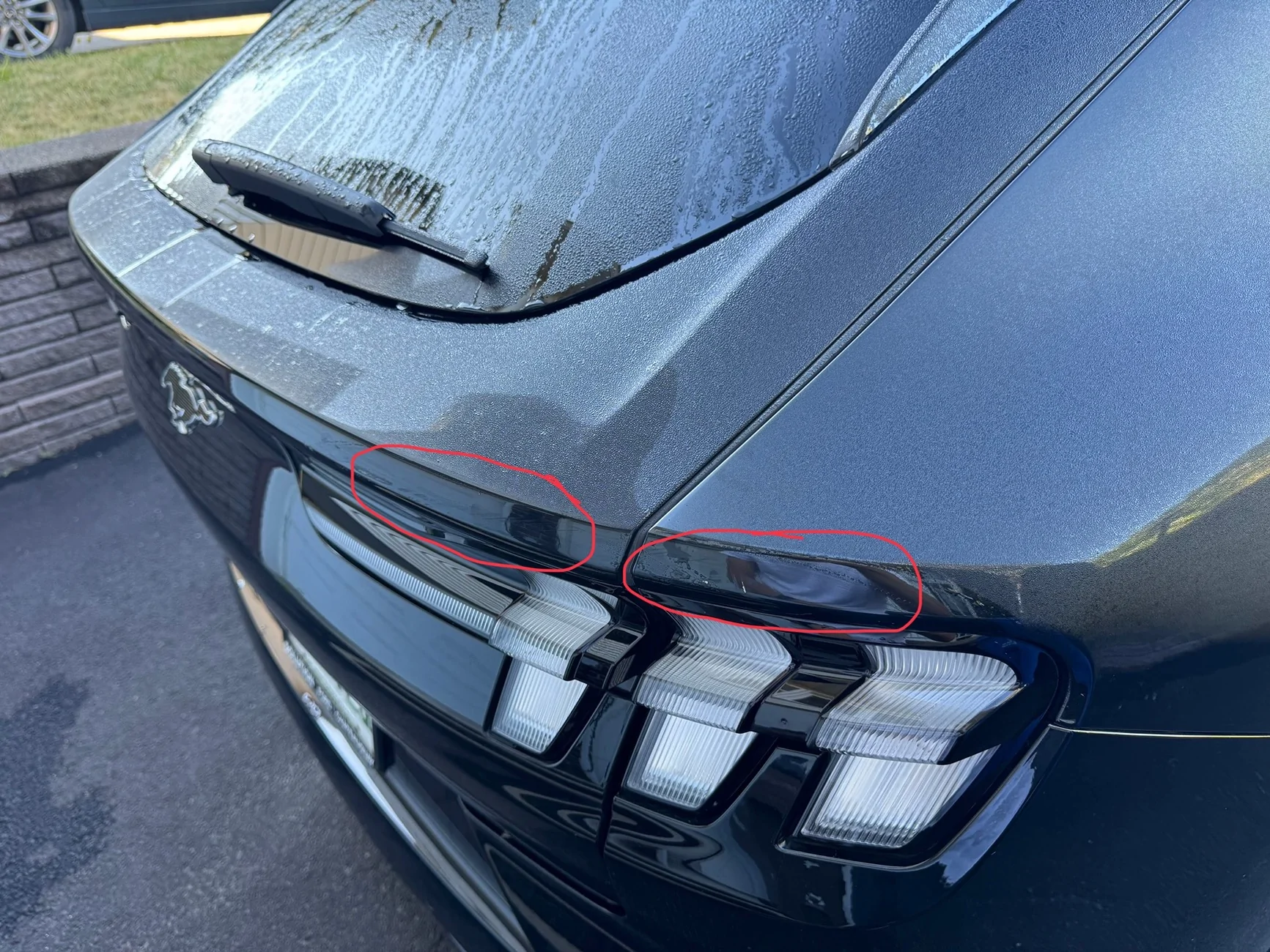

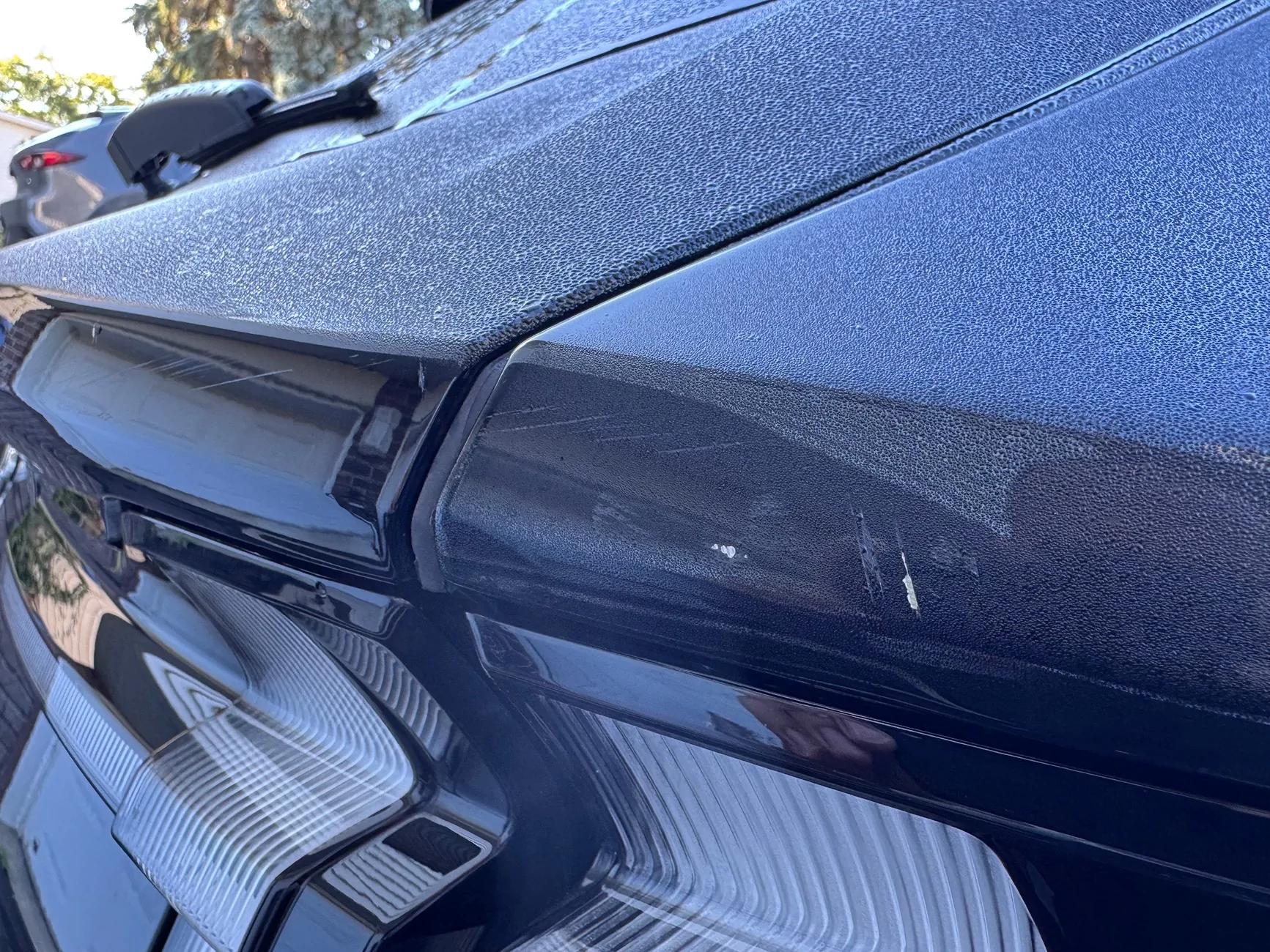

While backing up my wife scratched two rear panels. My question, can I wait fixing it? It seems it’s plastic but I am by no means an expert. Any insights? 2023 Mache Premium.

The liftgate is plastic. The quarter panels are steel. The chips in the paint don’t seem to have gone through the primer, so I would get some touch-up paint (I got mine through www.touchupdirect.com/) and fill them with paint and clear coat. 🤔🐩

Thank you! I will get this touch up kit.
