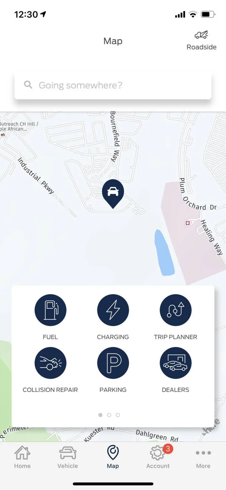

In Ford Pass, how do you send the navigation point to the MME?
I can’t find the option to do it. The only options are to make it a favorite or open up Apple or Google maps.
505
14,328
28,695
Choose Trip Planner
Ford Mustang Mach-E Send Navigation from Ford Pass to car BDE1DBFD-7058-4BB9-8B44-1603E0F40141
Once you’ve planned your trip, choose upload.
