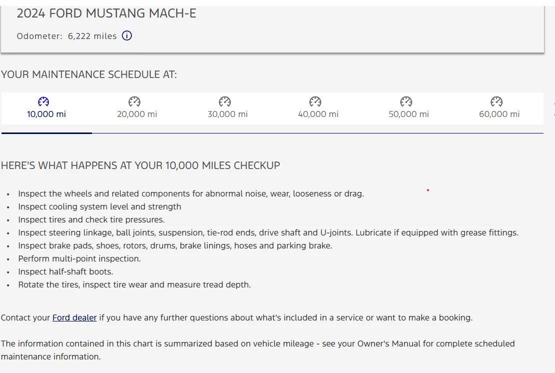

I found one for my 2024 on ford.com

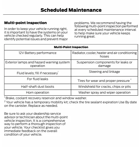

Found this on the Ford site
Ford Mustang Mach-E Service Interval 1756759753492-w5

10,000 miles seems like quite a long time to go between rotating tires? do people tend to stick to that recommendation?

Depends on the tires you have, your driving style, and a lot of other factors. When I had a GT-PE, I rotated every 3K-3500 miles because the tires were Summer Ultra High-Performance tires. Since those wore out and I'm now on much wider All-Season UHP tires, I am rotating every 4K-4500 miles (probably could go out to 7K or longer). It helps that I'm rotating them in my driveway though. 😁🐩

I normally go 10k between tire rotations. I have the 2023 GTPE with the PZero's. Hate to admit this but I haven't rotated my tires yet and I have +30k miles on the so far, and looks like I can get another 10k out of them. 90% of my driving is on Hwy 95, so they get minimal wear. Always fully inflated.

I had my tires rotated at my Lincoln dealer for $26, and no charge for the rest of the inspections. I think I will get them rotated about every 5,000 or 6,000 miles. 2024 Premium RWD Extended Range.

Rotate mine every 10k, if I saw uneven wear would rotate more often. Just crossed 50k on the original tires wearing evenly. Going to need to replace them before winter.
