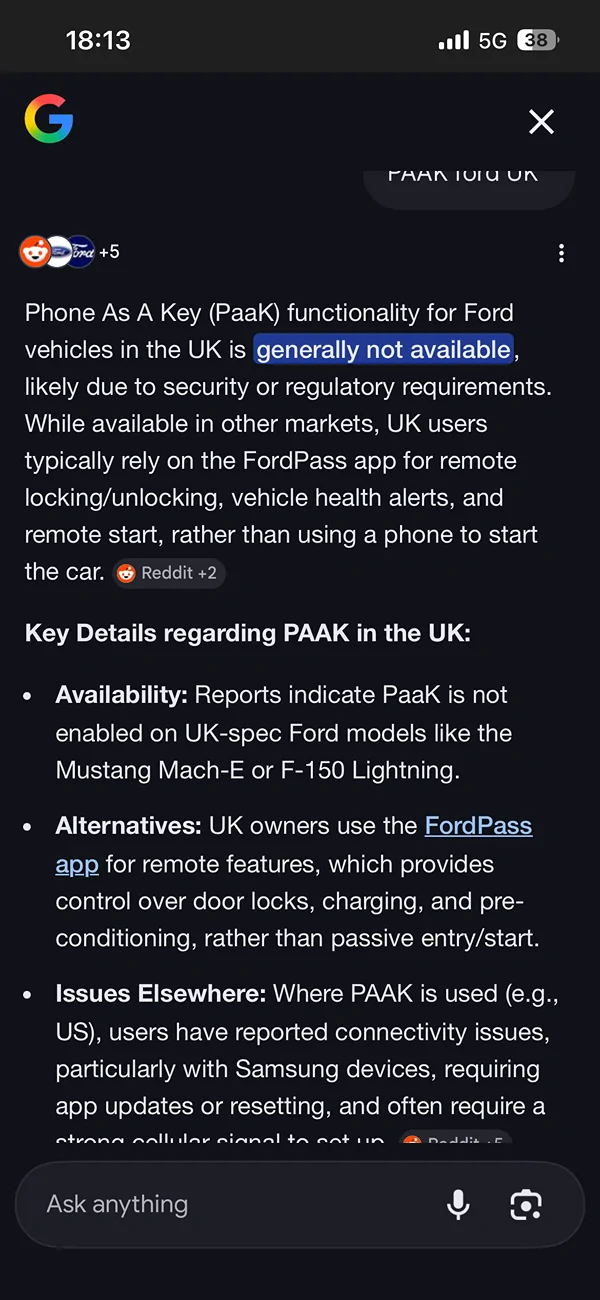

That’ll be why. I’m in the UK. Just another highlight of living in the UK these days.
