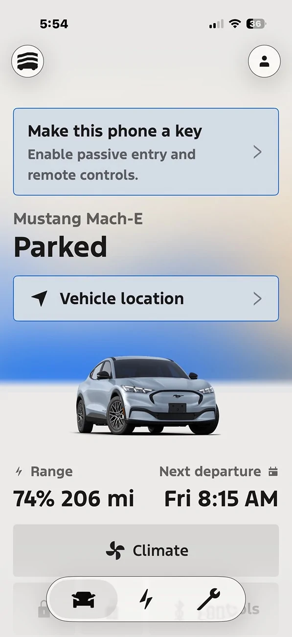

For some reason, my iPhone 16 will not complete the setup as "passive entry and remote controls" key. Worked fine a week ago. Also, the iPhone is paired with the car. Music, contacts, messages, and Nav through Google Maps work just fine. I've tried to go through the steps several times, I know I'm in an open area (same as when I first set it up)...what else can I look for to resolve this?

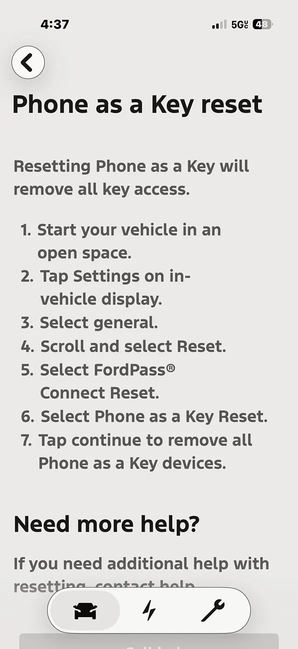

In the Ford app, scroll down to Settings, click on ā€œPhone as a Keyā€. Then scroll down and tap on ā€œReset Instructionsā€. Follow the steps.
Also, in the car manual, see the Phone as a Key section for more troubleshooting info.

Top is the message, of course, the bottom are the instructions I found when following the message at the top of the first image did not work... the "phone cues" would said "Pair Device", after starting the vehicle in an open area, and then showed a 6-digit key to download. Did that, but the the process never completed (did this at least 6 times).
I found the instructions by using the Settings and
Ford Mustang Mach-E Enabling iPhone 16 pro as a passive key IMG_2278
Ford Mustang Mach-E Enabling iPhone 16 pro as a passive key IMG_2277
