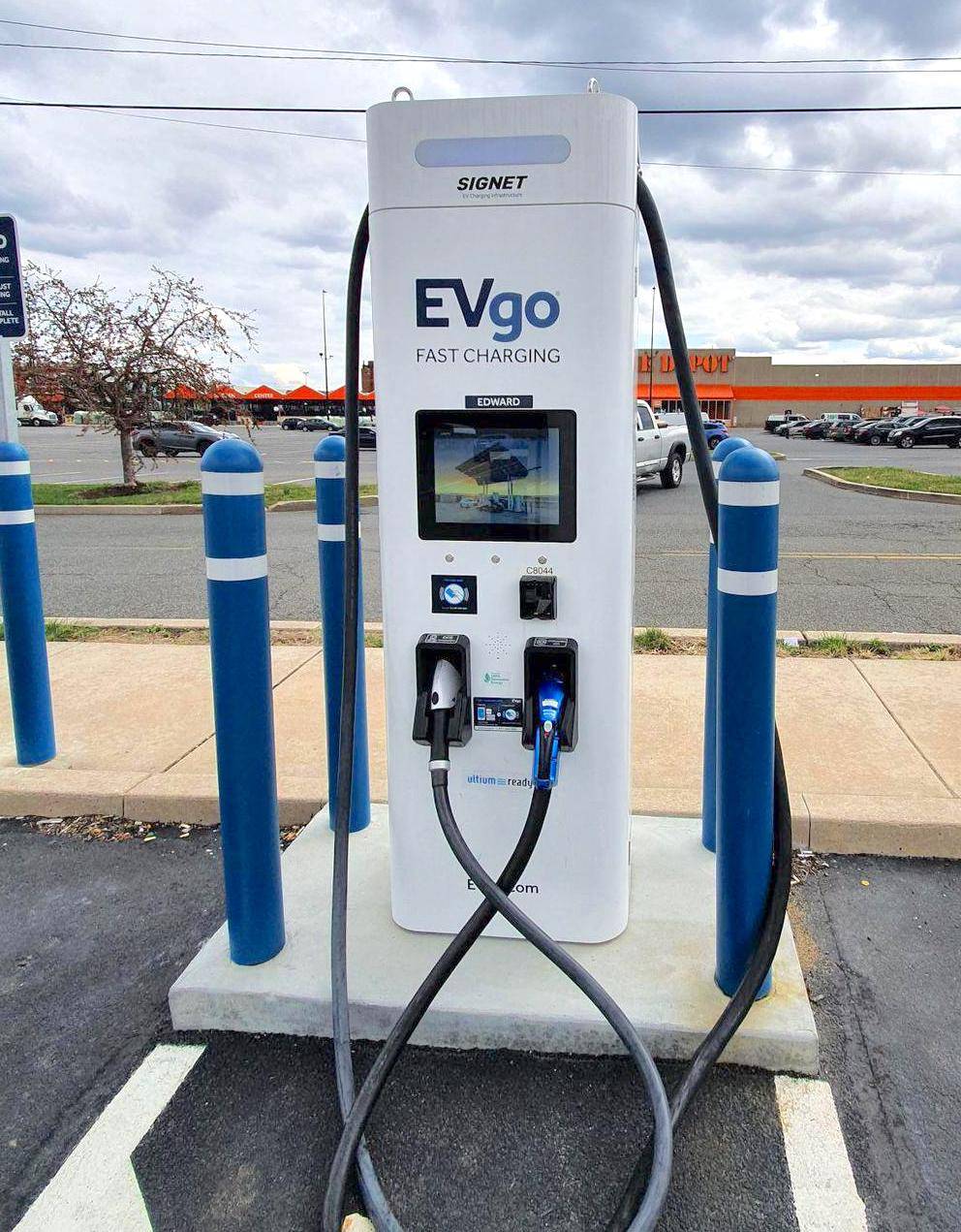

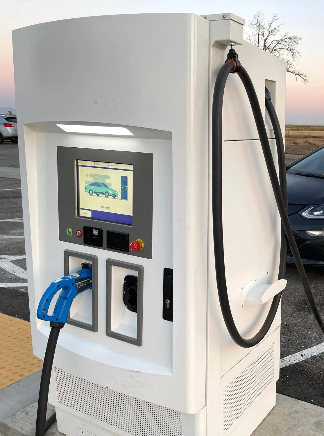

This seems like a duplicate of SSM 50923. Basically if you are having trouble with a certain brand or type of DC charger, it's suggested you have your OBCC updated. I think the latest updates will also help compatibility with 350 kW Signet EVgo station. Photos of these charger types are below.
50 kW BTC Power "Fat Boy" station:
350 kW Signet:
350 kW Signet:
