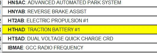

Well, still I hope that my car's battery does not have an issue at all ;-)
There used to be an internet page where you could insert your VIN, and the page returned you all features of your car. But unfortunately, this page is not alive anymore (-> see here).
In this list that I kept for myself, I can find this mentioned minor feature code HTHAD:
Ford Mustang Mach-E SSM 54388 - NCM Battery - HV Battery Module Replacement 1764536059510-4
But I think that I read in the German forum that there are other pages that shall offer the same. Only that for them I did not kept their addresses.
