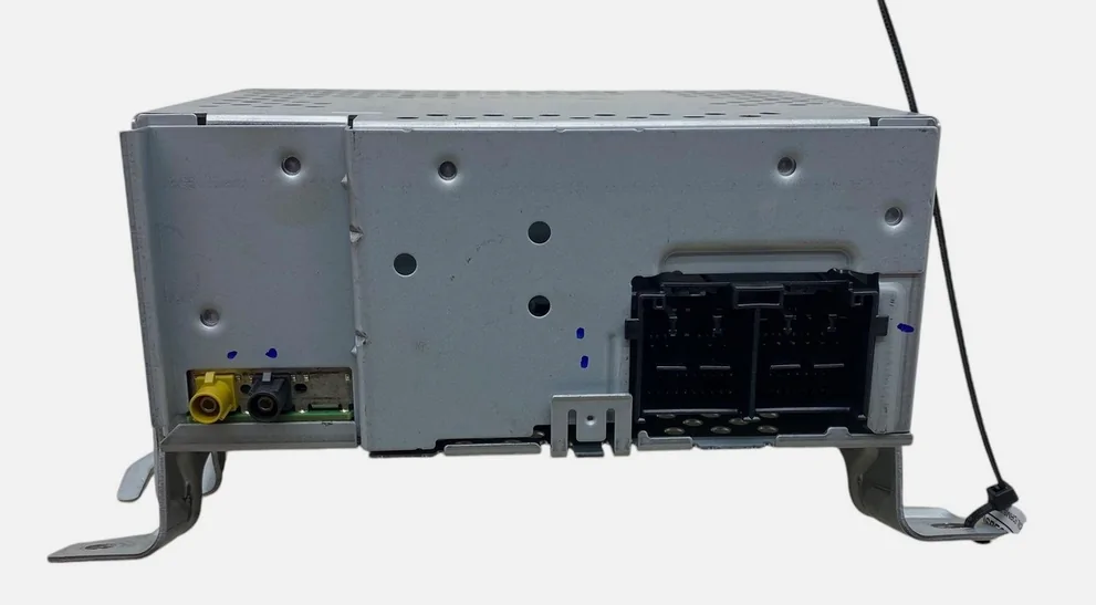

If all sources have the same issue it is assuredly the head unit.
Looks like this:
Ford Mustang Mach-E Static / Dropouts in Audio System 1782603890096-x5
21-22 pn looks to be Lj8t18k810ahk but you should verify...
No separate amplifier...

Thank you for the help, I've had that out and shook the wires around it checking for a loose connection. Mine is part # LJ8t-18K810E-AHE

looks like you have navigation... this is the latest...
Radio/Audio System.
Part Number: LJ8Z-18K810-K
Supersession(s): LJ8T-18K810-AHK; LJ8Z-18K810-E; LJ8T18K810AHK; LJ8Z18K810K; LJ8Z 18K810E

So that part number or any of those superceeded parts would work? I'll need to copy some information to it with Forscan right?
NY_Cade69
Cade
Mar 26, 2026
834
1,031
PA ON NY
they should. not sure about Forscan, maybe someone else that has replaced theirs will chime in.
