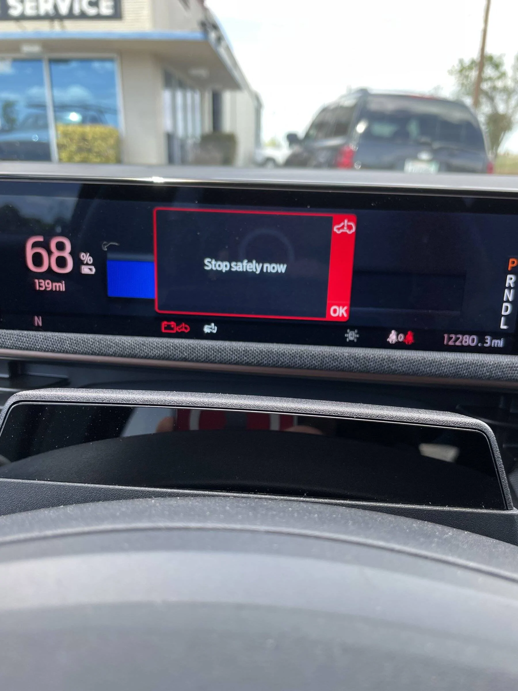

Stop safely now popped up

Had to have my GT towed to the dealer on Monday. Told me yesterday that the relay on top of the battery is bad, I have seen this as a problem here on other posts. They also said that this caused my car to not be able to fast charge to 90% when I said that they didn't do the update when they had it in for the 10k service. This is the first car I've had leave me on the side of the road since my 2011 GL350. Ugh
