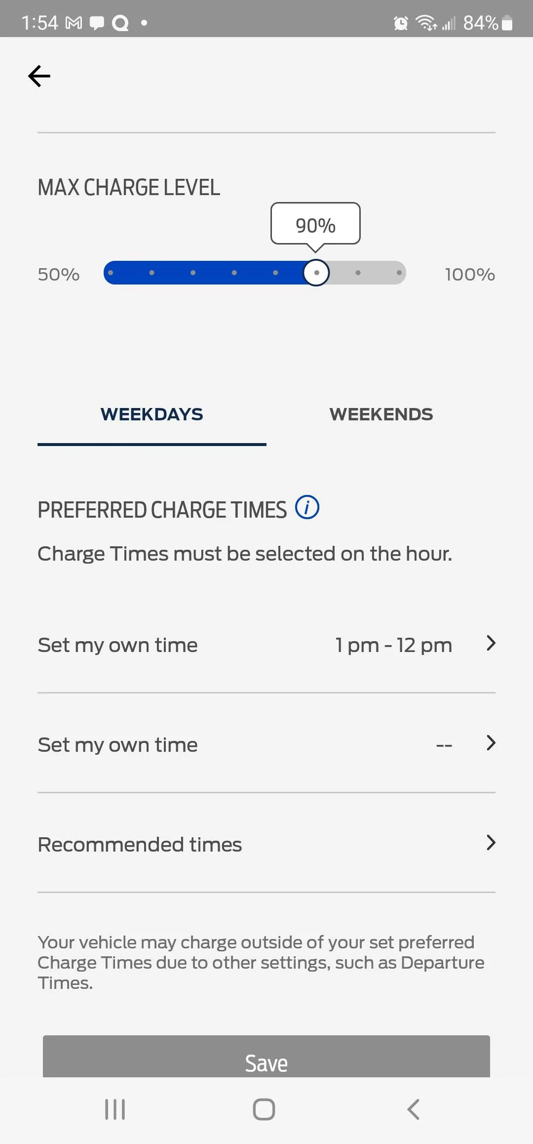

This is where it diverges:
I have the MAX CHARGE LEVEL (set to 90%) and the selections of WEEKDAYS or WEEKENDS
Under that is "Charge Times must be selected on hour" and then I have two "Set my own time" options and a "Recommended times" option
For each of the "Set my own time" options there does not appear to be any way to delete them:

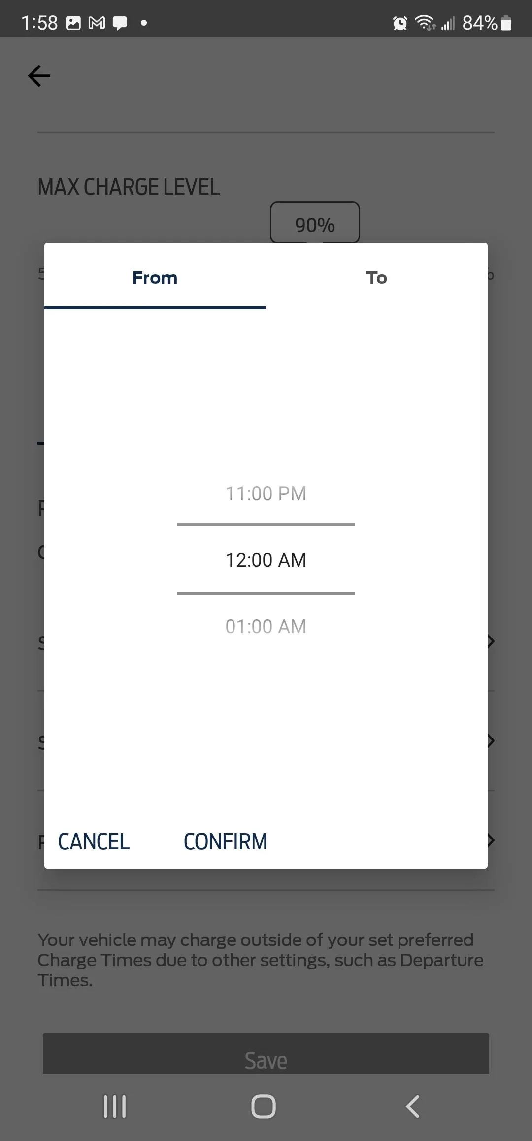

If I try to edit either I get a screen From/Top with time and "CANCEL" or "CONFIRM" options

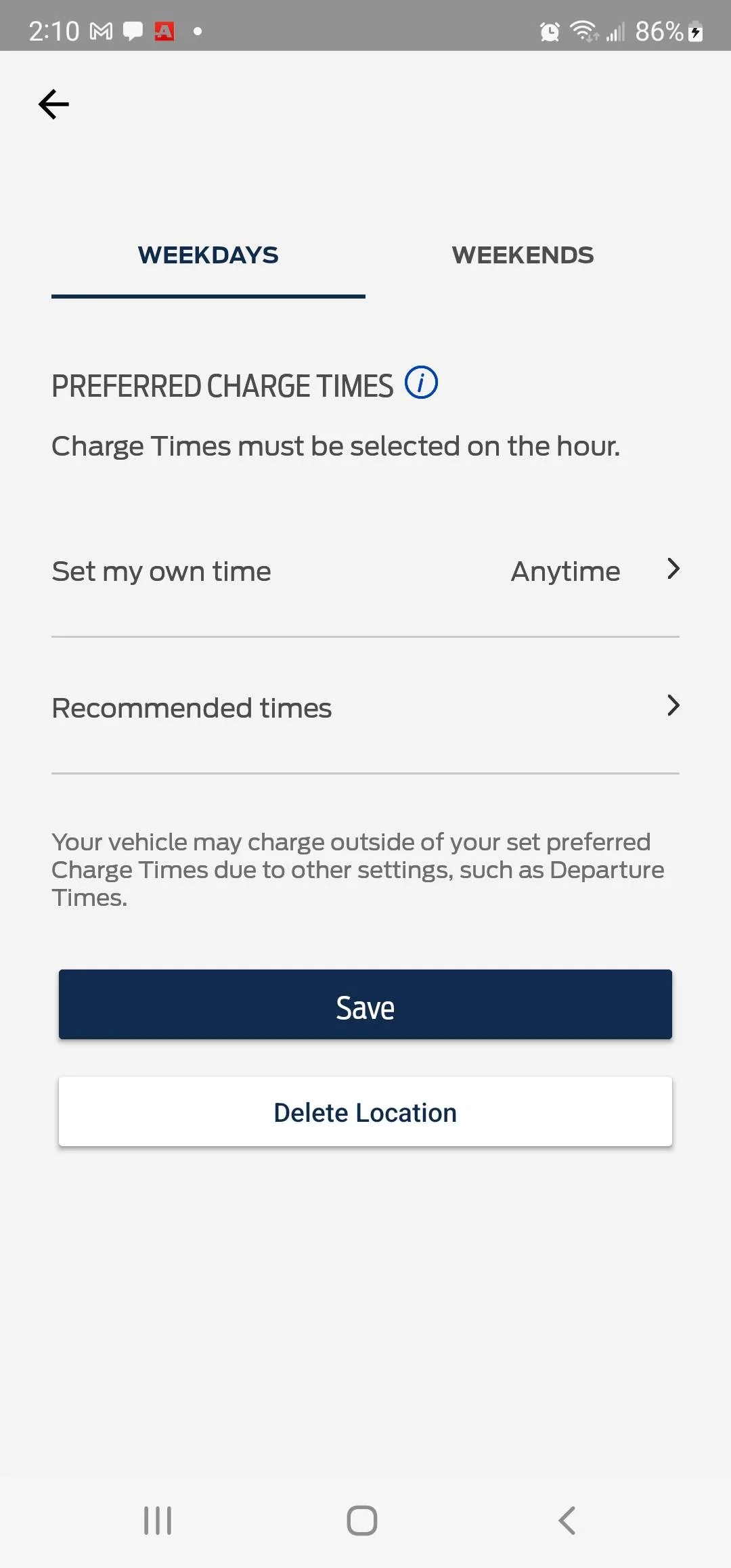

Now that is where it gets interesting.
If I edit BOTH times to 12:00 PM (and confirm each) it does go back the previous screen and MAGICALLY the "Set my own time" is now set to "Anytime"
Note: If you choose 12:00 AM for both changes are not saved!

Yes, now it works. I went back and did the same for "WEEKENDS"
