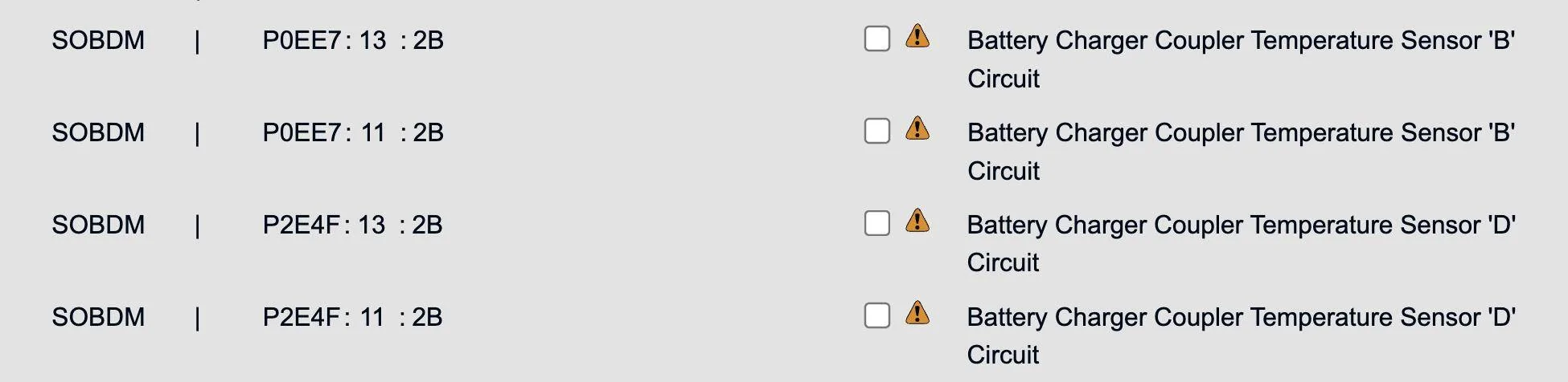

Thanks! What would I look for when using an ODB scanner?
I'm out of the bumper to bumper warranty and not sure if the charging system is included in the 5 & 8 year warranties.
11,353
24,981
You have a problem with the temperature sensors in your charge port. You have P0EE7 and P2E4F codes for both circuit open and short to ground. There could be a problem with the charge port, the wiring, or the SOBDM charger module. Because it can't read the charge port temps correctly, DC charge rate is limited to a safe low value. The charge port and SOBDM is covered under the 8yr/100k EV warranty, other components may not be. You should make an appointment with your dealer and start a case with the BEV team.
