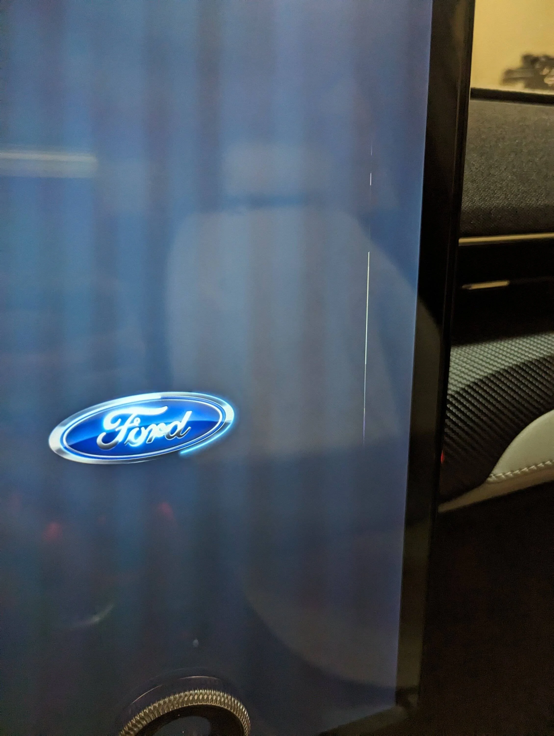

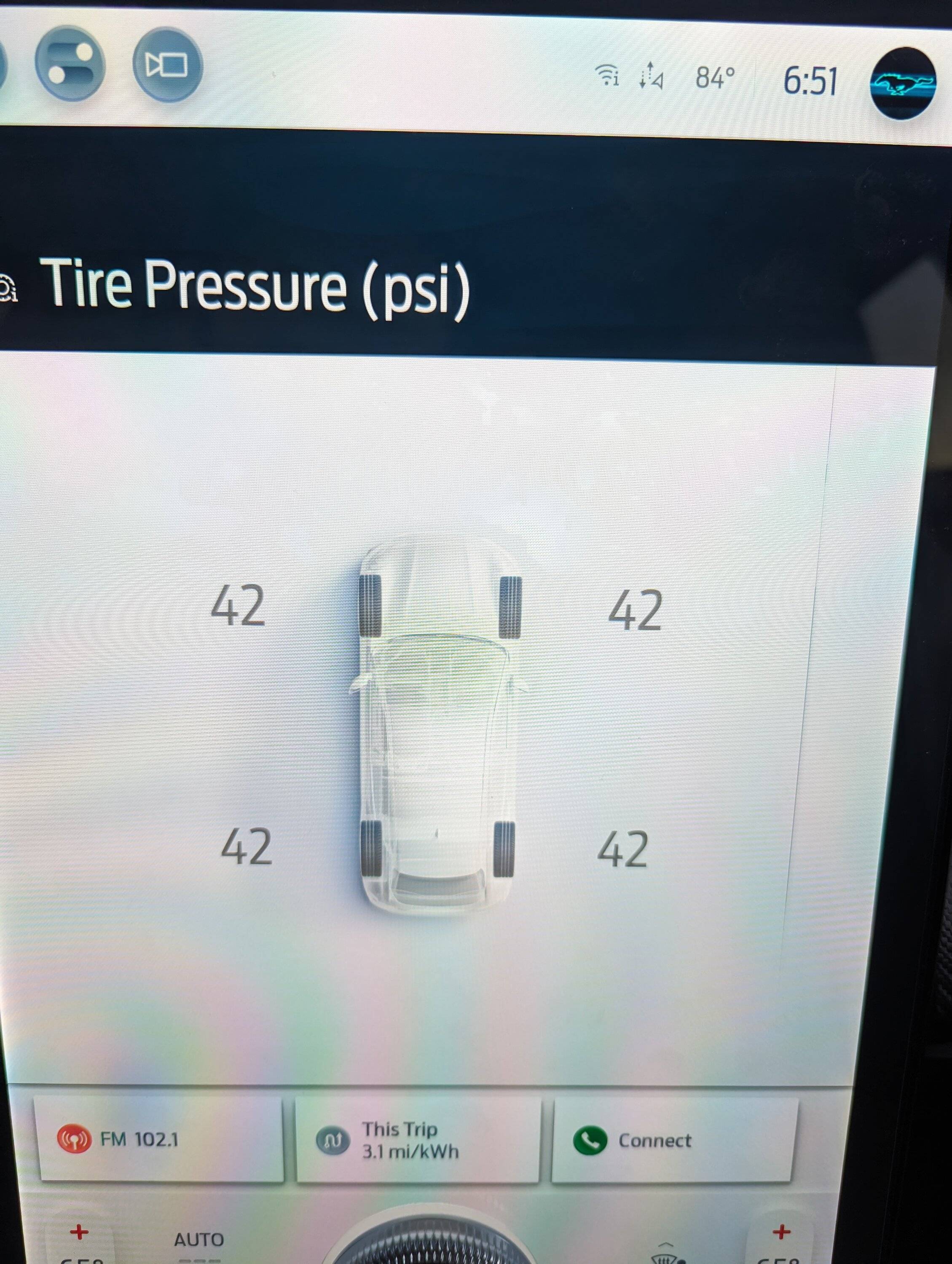

My MME (PR ER AWD) has blank/freeze screen issues. When these issues disappear for a period of time, the screen is very slow to turn on and the lack time is unbelievable. To top of the issues, my MME screen has a long line that looks like bad pixels. I just saw the line today when I was backing out from a parking spot. If the screen was blank, I would not have seen the defect. :( It will have to go back to the dealership for the third time. Does anybody else have the same issue?

Thank you for the suggestion. I restarted the car and the line was still there. I will try to reboot Sync 4. I have never done that before but I should find the instructions on the forum.

Rebooted and it is still there.
