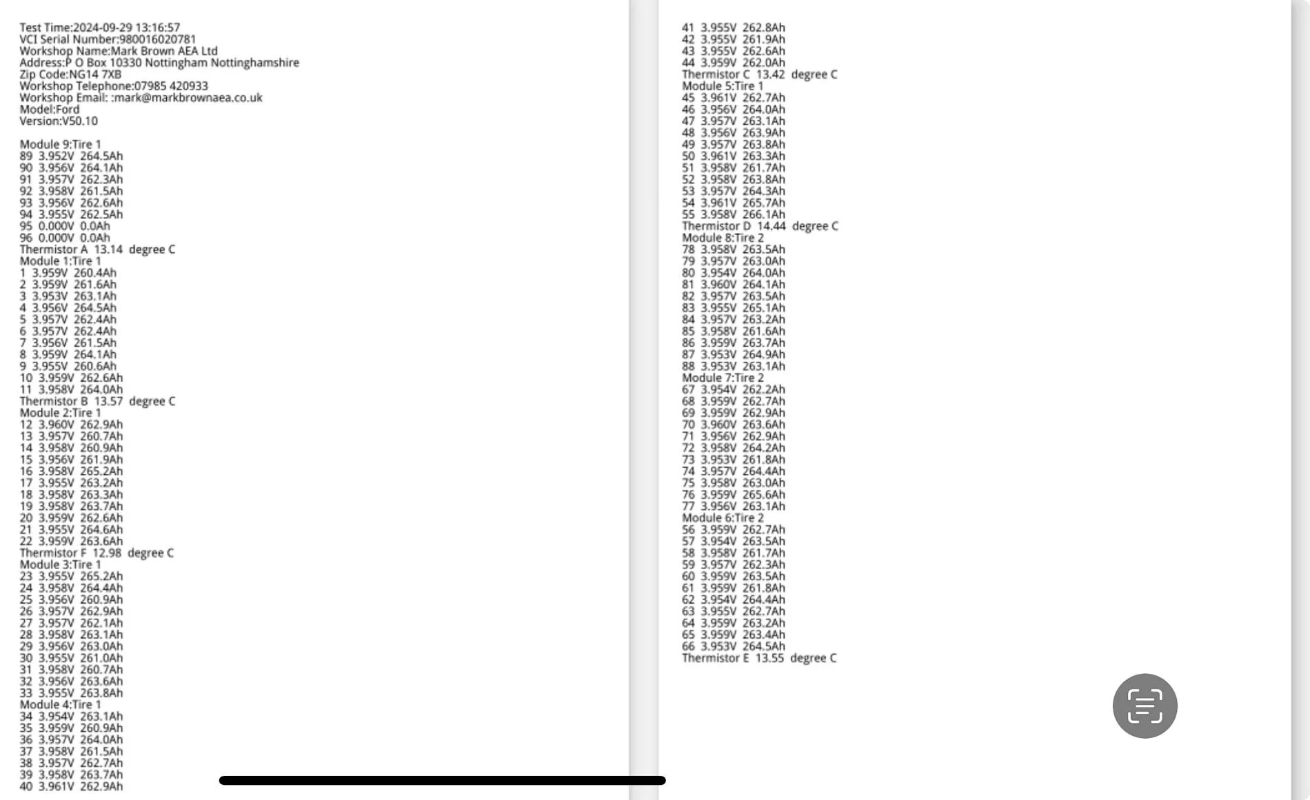

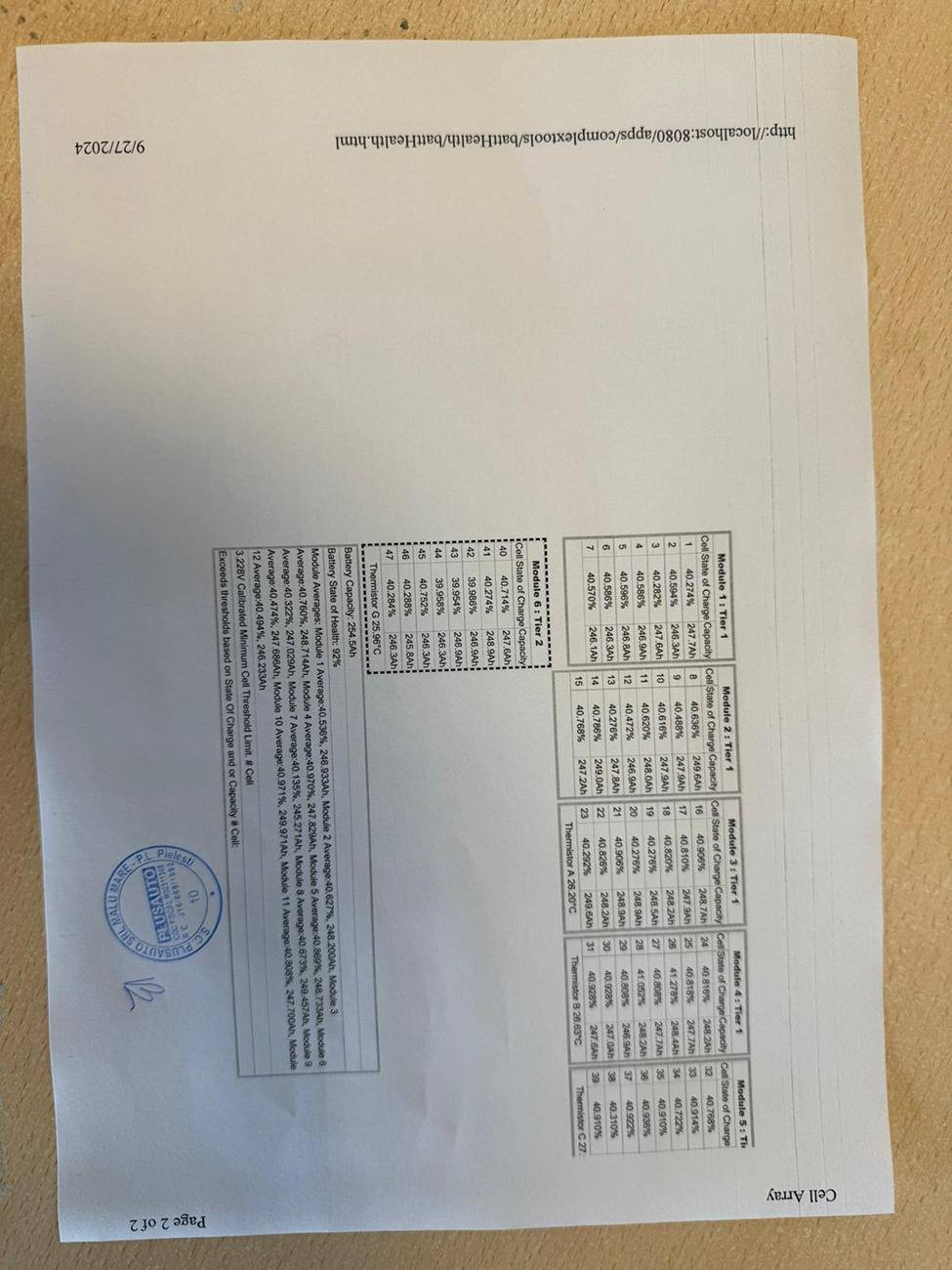

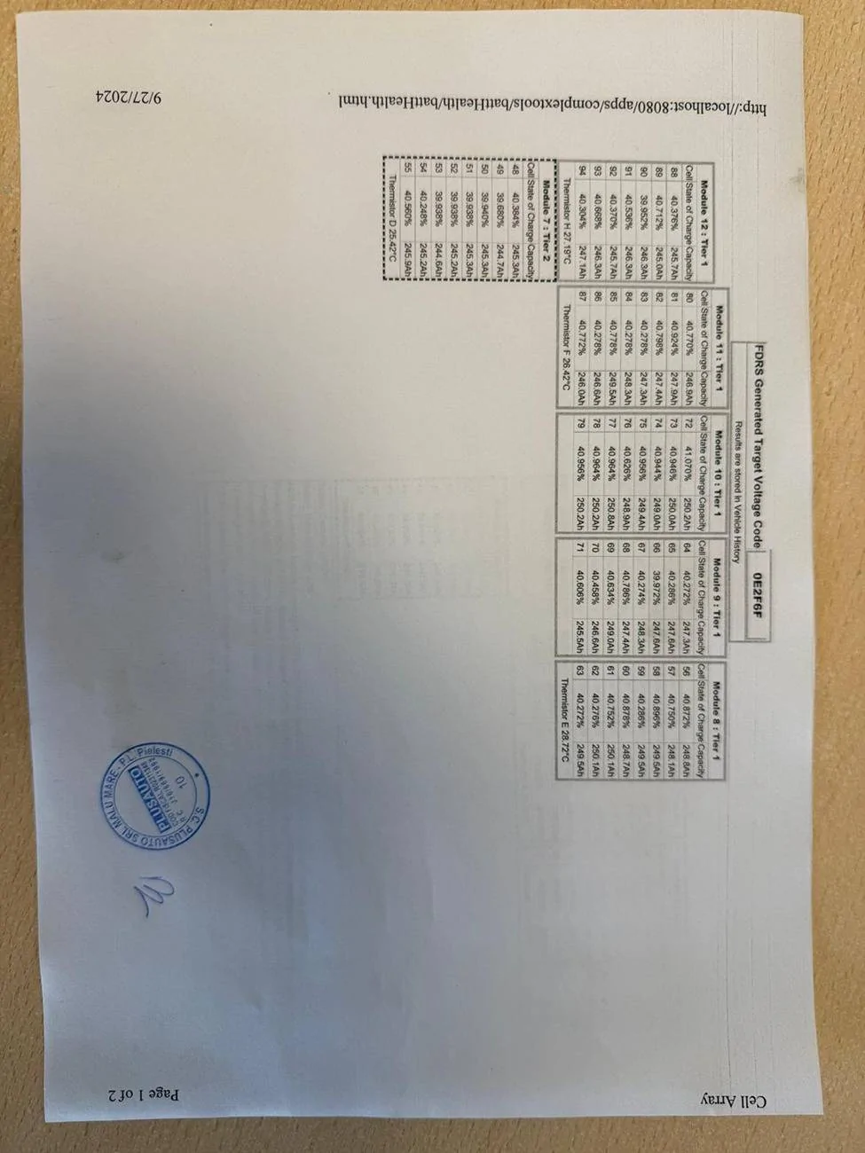

I want to buy a matches in 2021 35000. Km. These are the battery life values. What is your advice. Thank you in advance
Ford Mustang Mach-E To buy or not?? 1000030361
Ford Mustang Mach-E To buy or not?? 1000030360

No idea why you’re worried about the battery, since warranty is 100k miles, and they’re lasting much longer than that. Maybe one of the engineers would know if those numbers are good or bad.

1.4% variance in measured ah capacity between highest & lowest measurements is nothing to be alarmed about, I think.
Don’t think my readings are much different from what I can remember running this check on mine.
It’s the SoH I think you need to look at.
I’m currently at 94% SoH at nearly 97,000 miles & 39 months on an ER RWD so am confident the battery will outlast the car.
