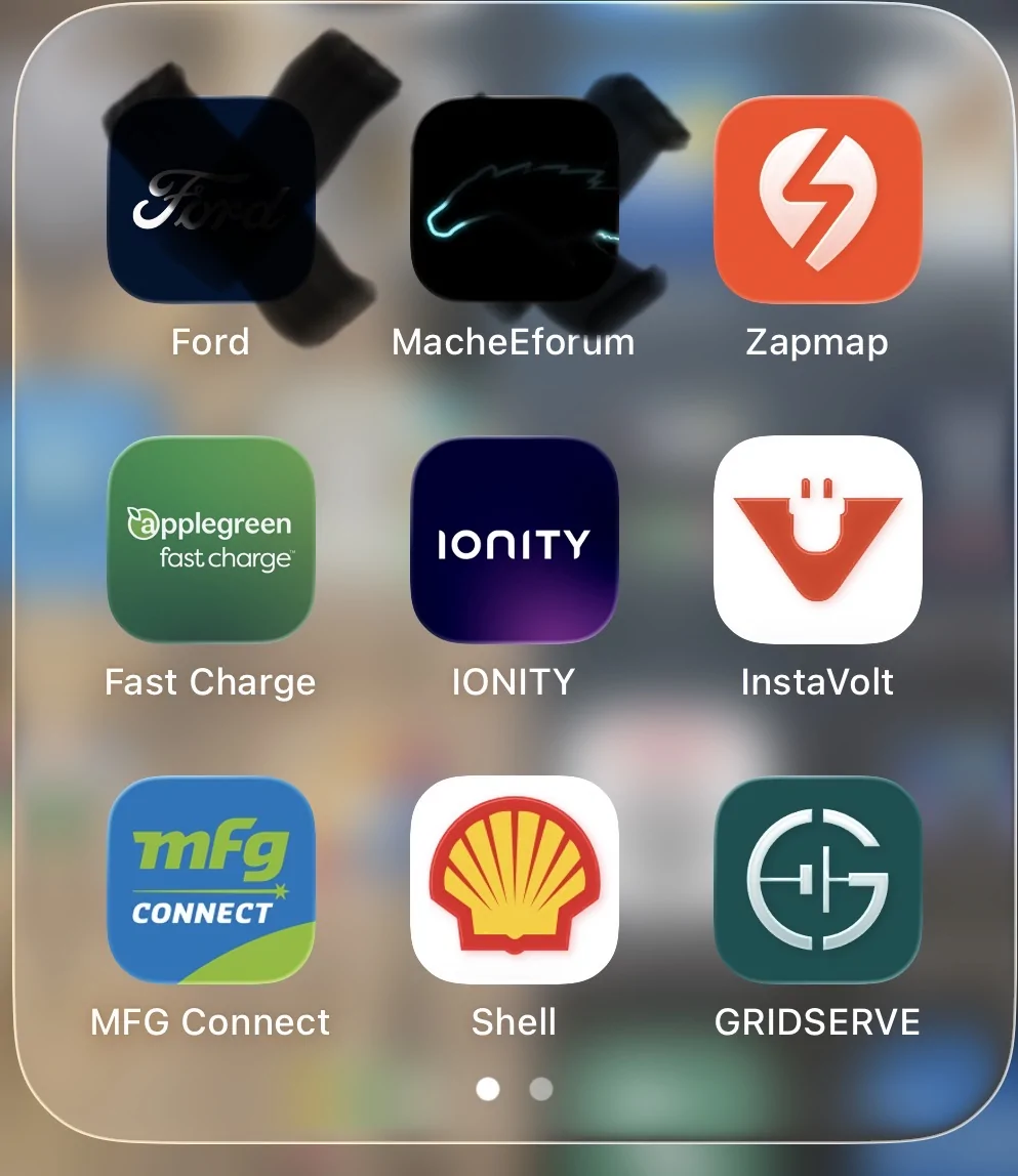

However, I what I would advise is do bother to download and enter your payment details in the apps, in particular the main ones in the attached plus PodPoint, and Charge Scotland and other regional ones if you’re over the border for example.

I use ZapMap without subscription to identify which charge network serves my requirement en-route and then turn to the network’s app for availability.
The apps give you live, happening availability info to avoid disappointment, queuing etc though in a lot of locations, particularly Applegreens, so many points are available there is minimal risk of this.

Ford Mustang Mach-E UK OWNERS - Public Charging? IMG_1246
