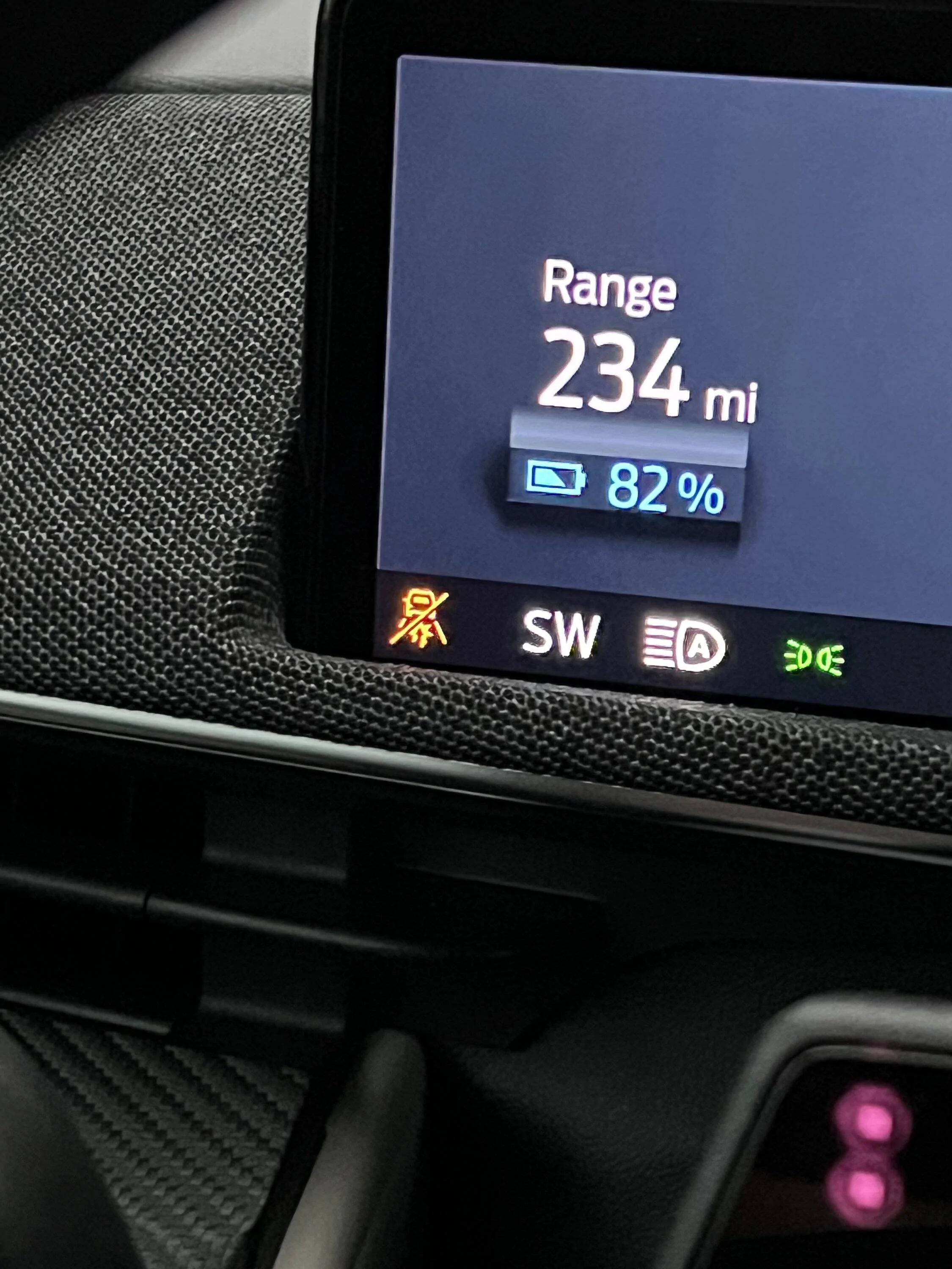

Does anybody know what this warning light is? TIA
aKaClamp Member First Name Joe Joined Aug 17, 2023 Threads 2 Messages 5 Reaction score 1 Location Cleveland Vehicles 2023 Ford Mustang Mach-E Premium Extended Range Sep 2, 2023 Thread starter #1 Does anybody know what this warning light is? TIA Sponsored
hybrid2bev Well-Known Member Joined Dec 4, 2019 Threads 78 Messages 4,644 Reaction score 12,792 Location USA Vehicles 2026 Rally Sep 2, 2023 #2 aKaClamp said: Does anybody know what this warning light is? TIA Click to expand... Pre-collision assist is disabled. Sensor that is located in between the front air vents on the lower portion of the grill could be blocked. I’ve had that happen before when the radar sensor was covered with snow/slush. And also when driving through heavy rain.
