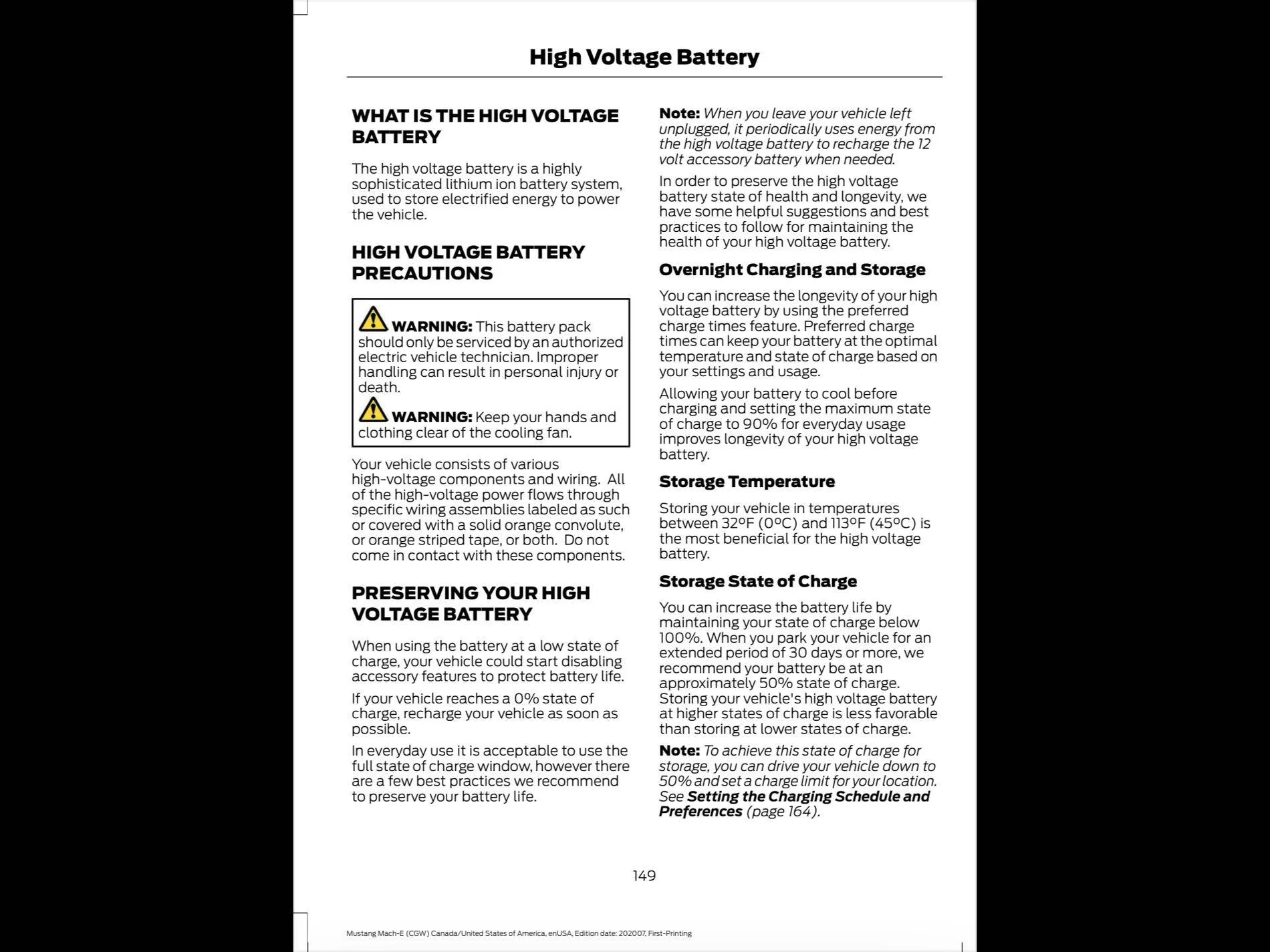

90% Page 149 of the Owners Manual. 100% only if leaving immediately upon charge completion.
“Improves longevity” but undefined what that means, probably because Ford won’t know what that means for another decade or two. Based on info from the battery supplier for our 36,000 lb capacity BEV forklift that my company builds (same battery chemistry, but not the same BMS as Ford), 100% charging daily overnight 5 days per week yields more than 10 years of life. Since I charge my MME about twice per week, I choose to charge L2 at home to 95% (I live on a hill, so gain about 2% on the way down to the city), so about 100 charges per year. Even if that practice shortens longevity by some amount, I expect 20 to 25 years to be above 80% capacity still. DCFC is another story, however. I expect to use DCFC half a dozen times per year, so don’t expect much degradation effect from that. YMMV….
