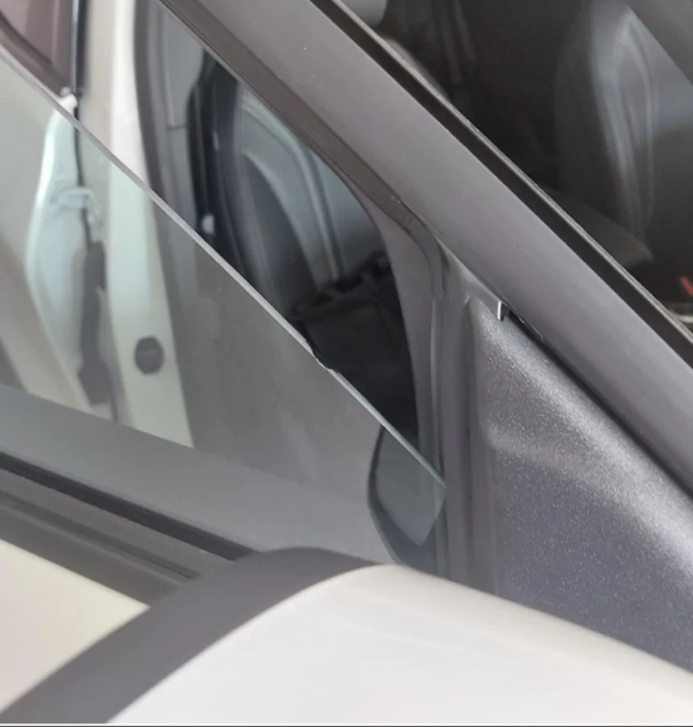

I would like to share my experience with the front right side window of my RWD EXT Mustang Mach-e.
THE FACTS
The car is one year old. Build date: May 2021.

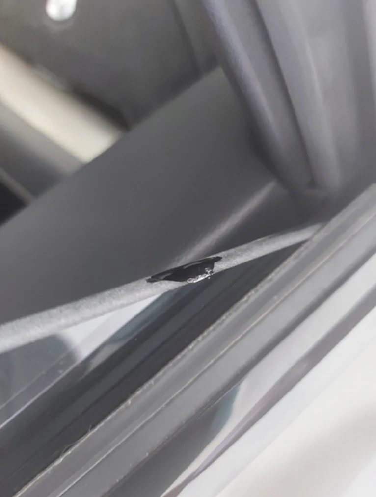

Two weeks ago, during my community trip, I rolled down the front right side window and listened a small ā€œcrackā€ coming from the glass. When I looked at it, I saw a 1,5 cm chip on the top edge. There were no other damages. The weather was nice and warm with no high temperature changes.

I took the car to my local dealer. They never have seen something like that but checking the software, they saw a ā€œfront window positioning sensor alarmā€ (but they didnĀ“t know which one of the two front windows was). After checking the rubber seal they didnĀ“t see any stone or welding problem.
So I called my insurance company and they accepted replace the glass without cost.

1.- A tiny stone or dust could break the glass but my car is always shiny and clean. Bad luck!

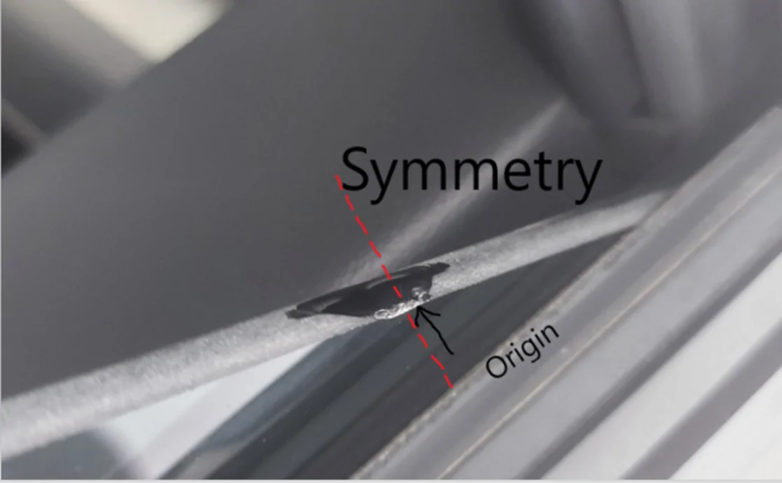

2.- Maybe the frame and the glass are not perfectly aligned. So, when the window is closed, it“s under a high pressure. After a few months, the glass breaks due to fatigue failure. In this case (fatigue failure), the breaking strength is about 400 kg/cm2 which is so high.
3.- The day before I washed my car by hand. I only use water without any kind of soap or chemical product. The next day, I rolled down the glass and saw that the lower rubber of the window was wet because the glass was full of water. At few hours later, after roll down the glass again, I heard the ā€œcrackā€.
Could be the upper frame rubber glued to the glass? Where I live, the water is very hard (carbonate hardness) what can increase the effect, but the typical breaking strength of glass is about 1000 kg/cm2 which is too high. Don“t forget that glass usually breaks due to traction, not compression. I“m not an expert but if you look at the picture, I“d say that the chip begins from outside to inside. It“s also strange the symmetry of the chip.

That is an oddly placed chip, for sure. Could be you rolled something up on it that put point pressure on that edge and napped off a chip. Manufacturing defect that stuck to the rubber gasket is also plausible.
I wouldn't worry too much about it happening again (but I would still check the window every so often, just to be sure)
