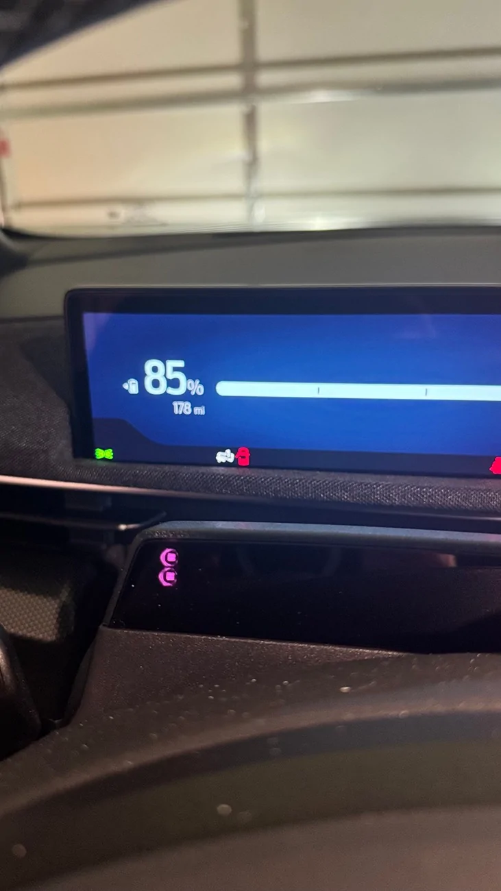

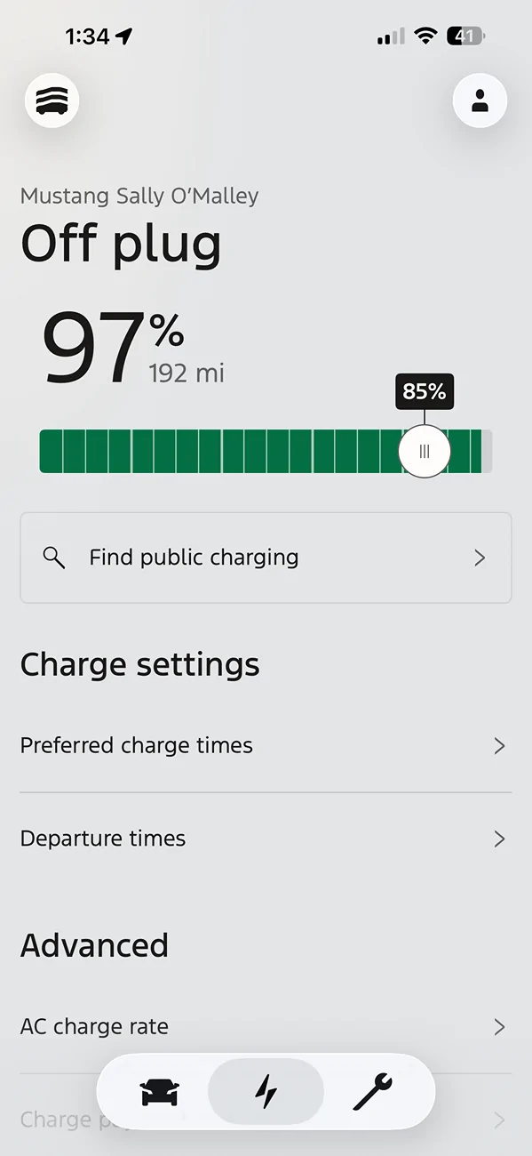

I've tried downloading and re-downloading the app, soft reset, wifi changes--nothing will change on the app. It's still charging fine, but the app will not update or communicate with the car. Anything else I can try?

Ford Mustang Mach-E Zero communication with Ford Pass and MachE IMG_5451
