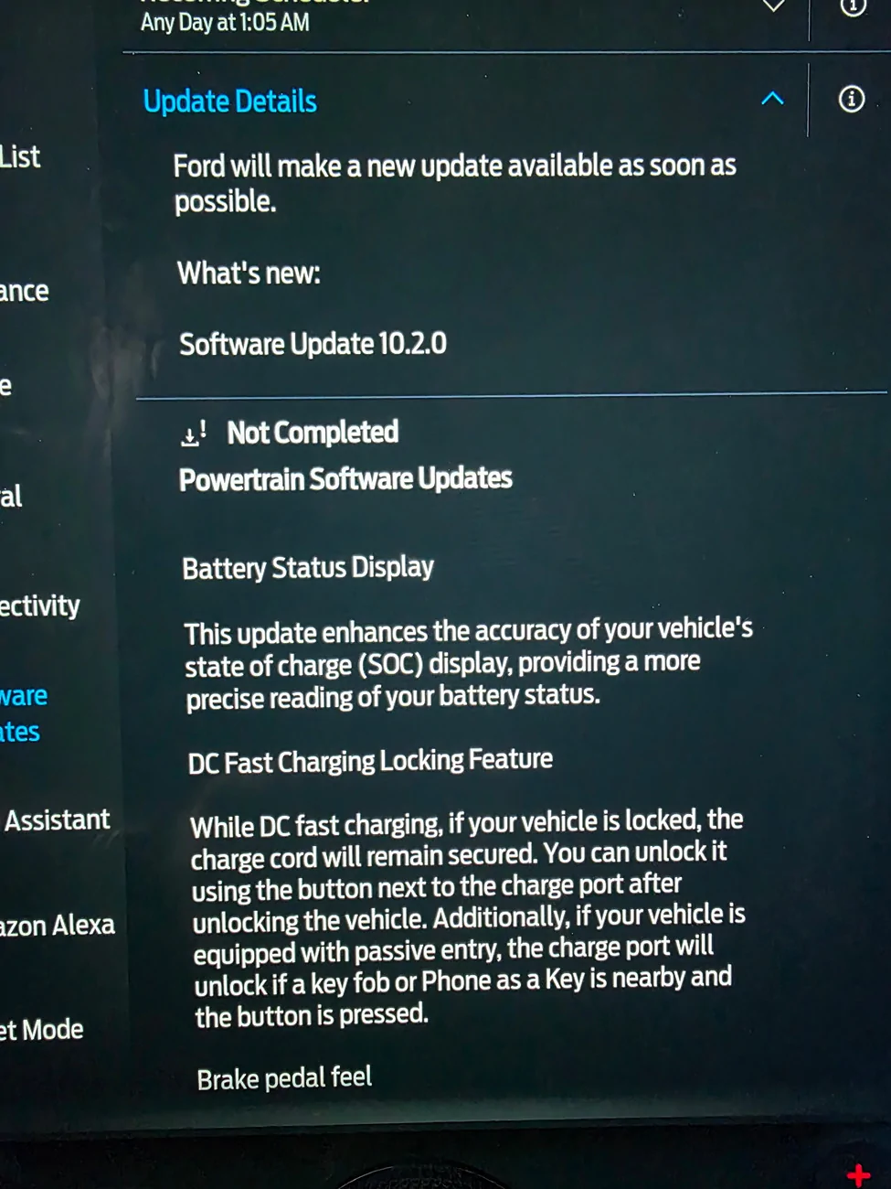

I am also interested in learning if this update got pulled. I tried to manually install the update early August as I got the same error as others about the battery being too low.
I had plugged in the car into my L2 charger.
Attached is what the Software screen is showing me since then.
Ford Mustang Mach-E 10.2.0 Update postponed 1000006619
11,365
25,022
For that update, the car needs to be unplugged. If your update isn’t installing, follow my guide to failed OTA updates.

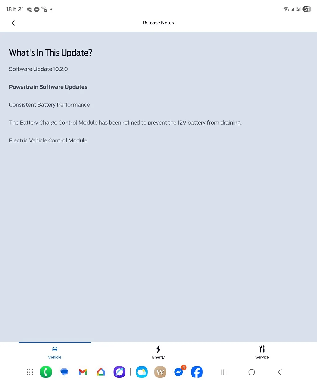

Ford Mustang Mach-E 10.2.0 Update postponed Screenshot_20250901_182153_FordPass
11,365
25,022
I did that update with the car plugged in. However I got a different version that don't have the brake pedal feel, etc. I wonder why my car in Canada is not aligned with the one in the US? Coming from a Tesla, coming to a stop is terrible in the Mach-e with 1 pedal driving.
Edit. Added image.
If you ran it at the scheduled time or your car was done charging then it might have worked, but if you are actively charging when you hit “install now” it can cause an OTA failure since the charger can’t be updated while it’s in use. There are also model year differences.
