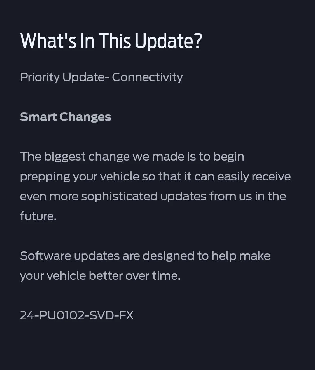

23-pu1113-unx-dc was the last update for my May ‘23 built Premium as well… until this afternoon. Just got ECG-24.2.4.9 while driving home from work.
