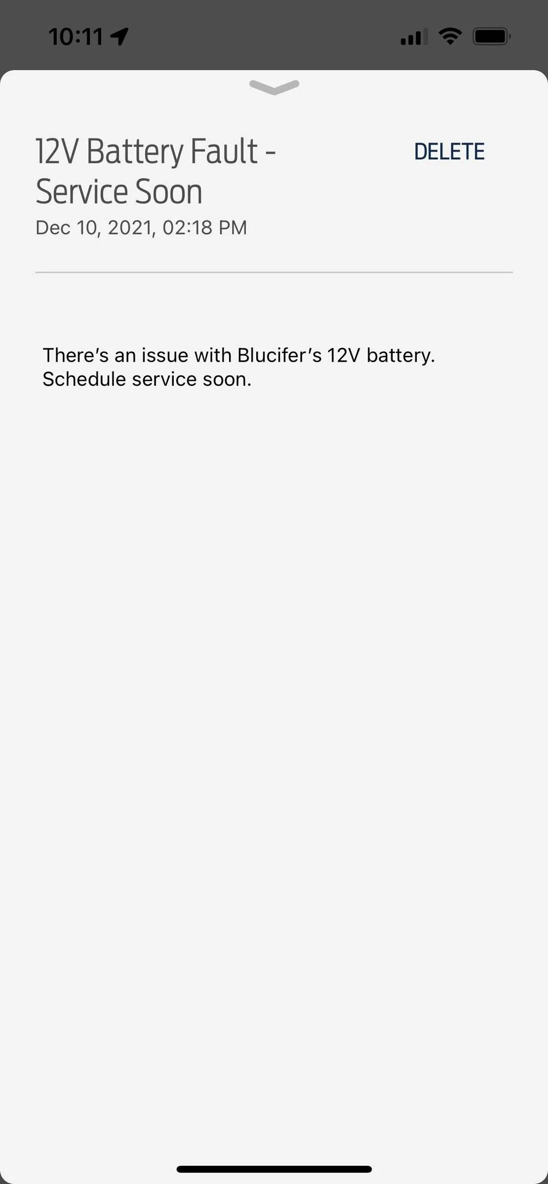

On Friday, I received this warning in FordPass (iOS, 3.35.0) while I was in my garage (car was outside but close). I recently bought a 12V plug in USB adapter to get the voltage meter and had it plugged in an hour earlier after remote starting the car for 10 minutes. That was showing 15.1V when the car was in Ready (started), and around 13V in accessory power mode. I turned off the car, the charger thing went dark.
So after getting this warning, I went to the car and unplugged that adapter just to be sure.
On Saturday, I plugged in an OBDlink MX+, ran their software and found only 4 DTCs, all related to IPMA. It also showed me a 15.1V when the car was running. I did a few 4-5 mile trips to do my errands, my wife following in her car. During this time, about 2.5 hours, I watched the battery meter on the OBDlink app, and it started at 15.1V, next trip 15V, final leg 14.9V. No new DTCs or anything of note.
So questions for the experts: should I have expected the car to register a DTC when the app warned me? I'm sure the dealer won't act on the battery if the car is not reporting anything.
And, a theory: I was in my garage, the car was outside, maybe 10-30 feet away from my position - I was moving around a bit. I wonder if the car was waking up because it received frequent Bluetooth pings from my phone, leading to battery drain? I have seen others talk about this same notification when their car was in a detail shop getting PPF applied, so it's very possible the same thing happens with the fob, which the detailer probably needed to have on their person since the car would walk-away lock and they wouldn't have access to PaaK.
