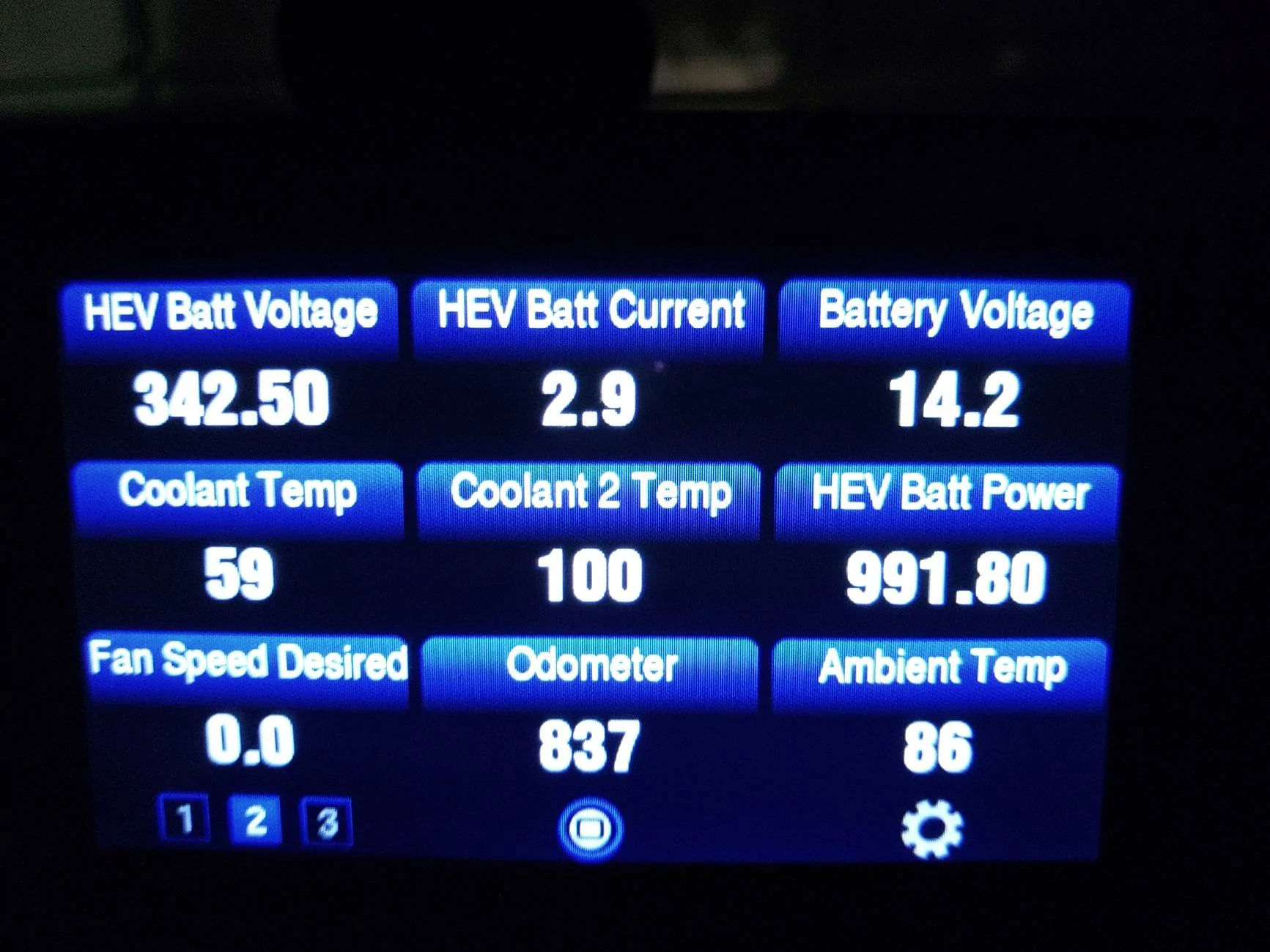

I guess the state of charge on the 12v battery is based on a reading people are taking off the Ford Pass? Your OB2 port has 2 pins in it that are the 12 volt battery voltage directly from the battery. This voltage is what powers the different things that people plug into the port. I monitor my 12 volt battery by it's voltage from that port. The wild guesses that come from tying a percent battery capacity to an actual voltage make me very suspect of what I am seeing with a percent reading. The same goes for the traction battery. I am old.
Ford Mustang Mach-E 12V battery-Ford Advisor says 50 SOC KIMG0081

Currently showing a 65% SOC but a 13.4V reading...those two things don't fit together.
The reading of the 14.2 volts on my scangauge goes down to ~12.4volts when the car is turned off & 30 minutes have passed. It drifts from the 14.2volts while driving. I have had the newest 12v software update on my 25 Rally performed.
