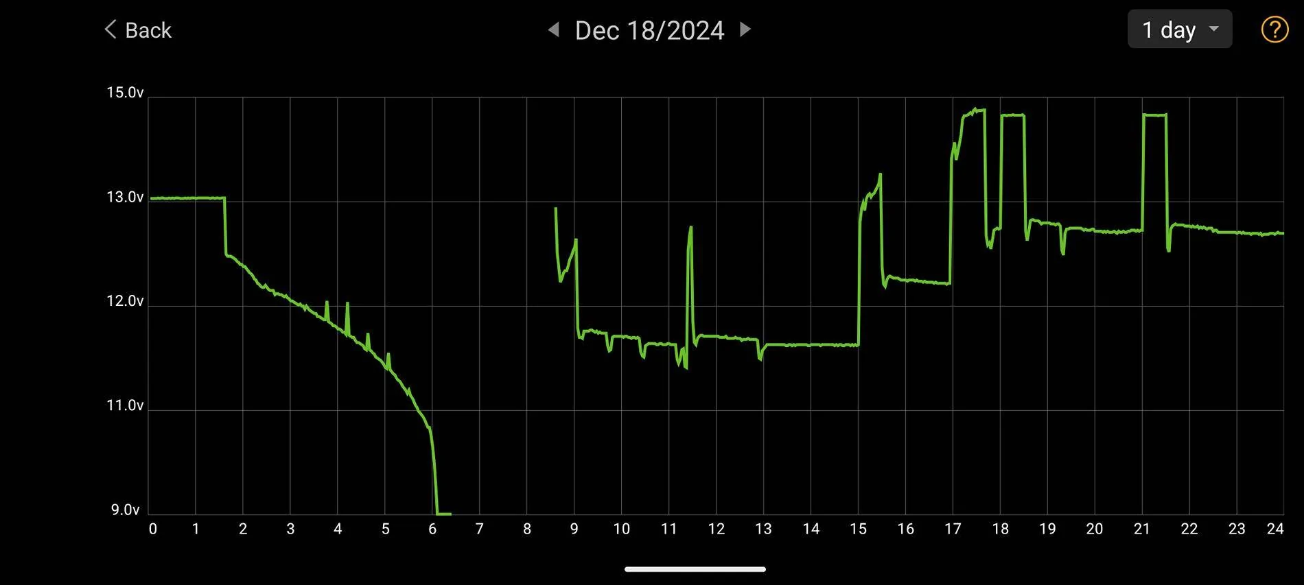

Would a voltmeter work?
Also, I could charge for 24 plus hours.
Neither you nor I know what the car’s charging strategy is. And a volt meter only gives voltage not state of charge.
That said, it will work without charging the battery separately. It just isn’t as effective.

Yes you get those two FordPass messages when the automatic 12V recharge is triggered because of a high drain.
The 12V battery is big enough, just not managed the best sometimes. Teslas only have 7 amp hour batteries now vs. our 35.
It's so strange that a H3 could be so dead, and without warning (FordPass notification) that a DC/DC converter charging event wouldn't make it possible to access the doors.
Or put another way, it would take almost a "perfect storm" to create the conditions necessary for not being able to access the doors and/or open the Frunk from the emergency leads in the front bumper. How can conditions be where neither option is functional?
