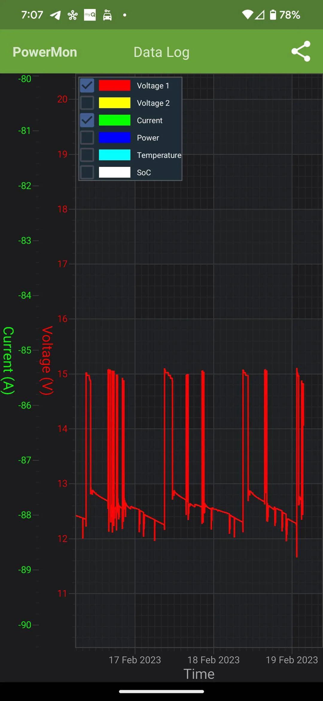

Here you go:
Ford Mustang Mach-E 12v battery 1682303911241

So your hitting 15v with yours… lol I feel like I might be a lil low then…does your dip while driving?
15v is only when it's charging the LVB which can be while it's being driven or L2/L3 charging. If the LVB doesn't need to be charged it will hover at about 13 even when it's being driven.
Again, I wouldn't worry about it unless you are getting warnings from the car.
