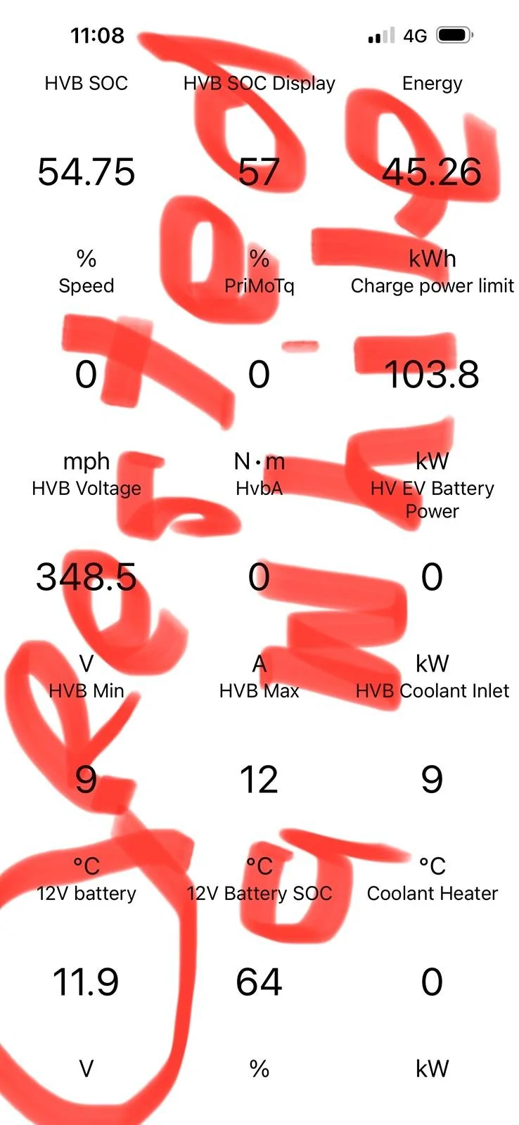

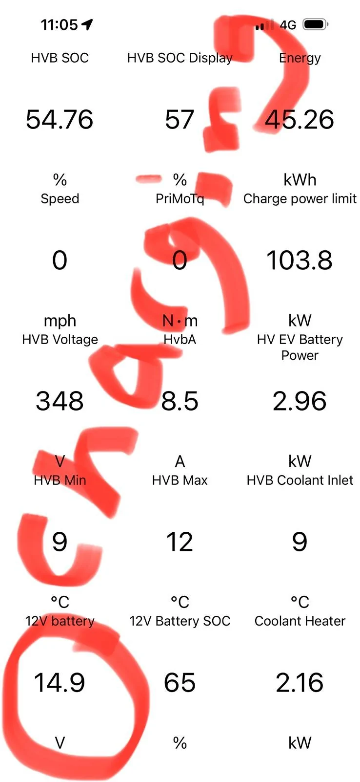

Just run a check and with vehicle On LVB charges, after a period of rest and vehicle Off is at 11.9V 64% not charging so all is fine.
my experience is that modules cease to communicate and operate properly if V drops to 9V or 8V depending on vehicle so 40% or even 30% shouldn’t be an issue so long as charge system’s working which I think OP found it was.
