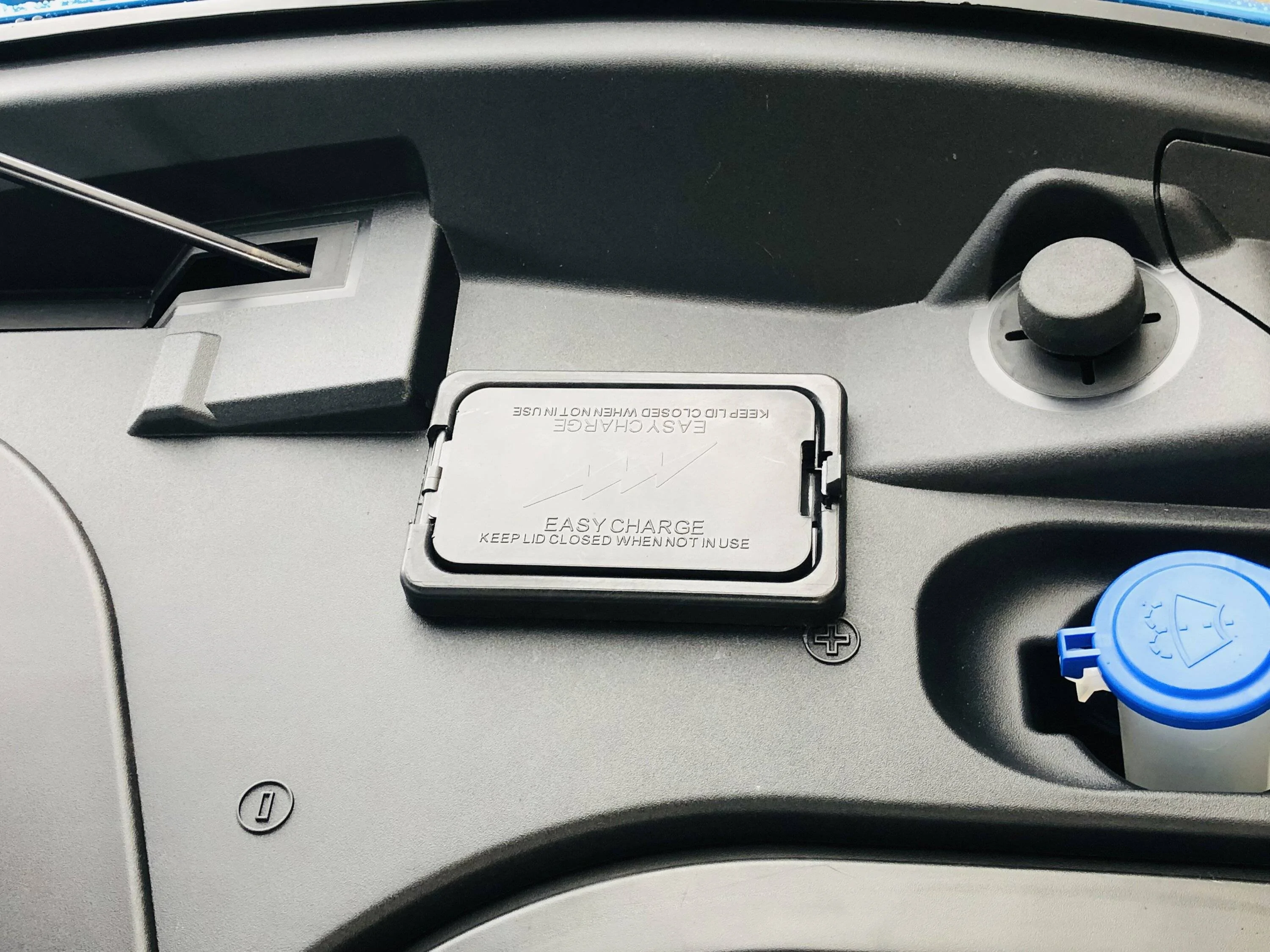

I also have the cutouts so I can attach clamps from the PL6100 battery power supply when updating the MME's software.

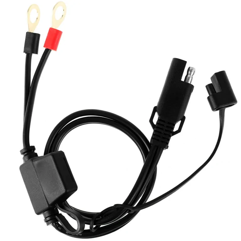

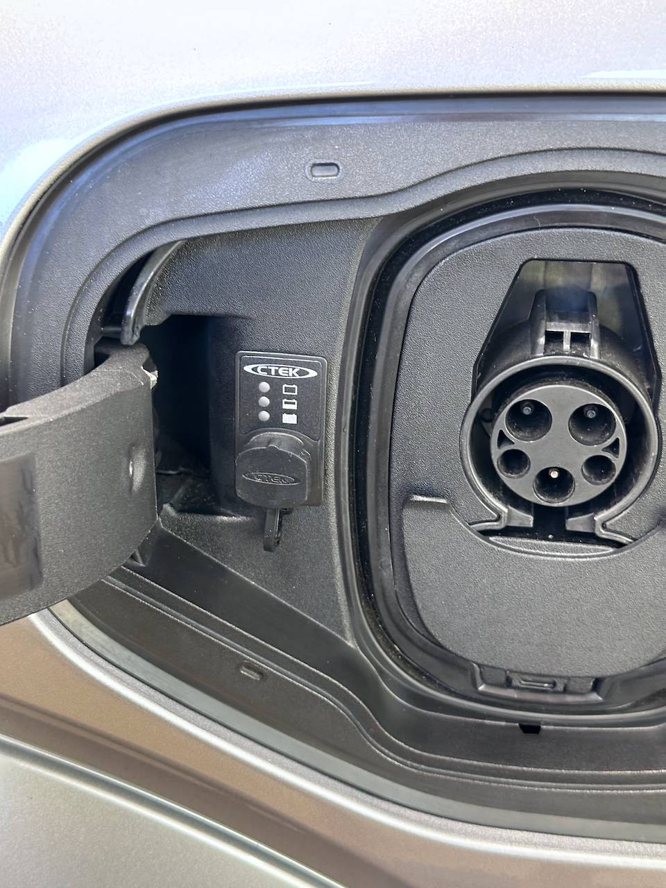

Ken, I'm getting back to you on the size of those eyelets on the CTEK 56-380 connector/battery indicator. They are large enough to fit over any of the battery's positive terminals and the main ground stud coming off the battery, going to the body. While I did not need to install this in my car, I figured since I had an extra one I would just in case I ever needed to charge my LVB without having to open the frunk or remove any panels. I also included the manual on the CTEK MXS 5.0 (1090) model I have in case you wanted to see the specs. The reason you don't see any of the LED's lit is they blink very quickly about every 2 seconds and none were lit at the time I took the shots.
I really like this modification because it allows access to the LVB without raising the hood. If the LVB is dead, just pop open the door and connect up a charger. There might be other reasons you can't or don't want to open the hood as well. Cool.

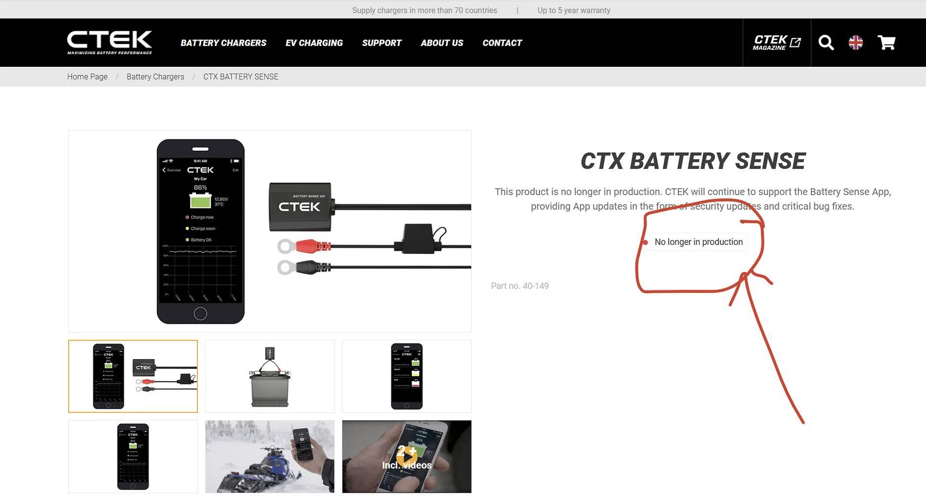

I really liked this idea too, but when I went to buy it this is what I found...
Ford Mustang Mach-E 12V Battery access? 1740004153610-si
They do seem to have a non Bluetooth "dumb" version still in production for $39, but I'm not sure you can get the same service from it? I already have a C-Tek maintainer for my vintage summer fun cars so it would be noce to have this option for the MME
Ford Mustang Mach-E 12V Battery access? 1740004153610-si-jpg
They do seem to have a non Bluetooth "dumb" version still in production for $39, but I'm not sure you can get the same service from it? I already have a C-Tek maintainer for my vintage summer fun cars so it would be noce to have this option for the Mach-E
That is correct Greg, it is no longer in production but there are other manufacturers that make a similar product and some members here are using them. I don't know the name of the product and hopefully someone with one of these will chime in.

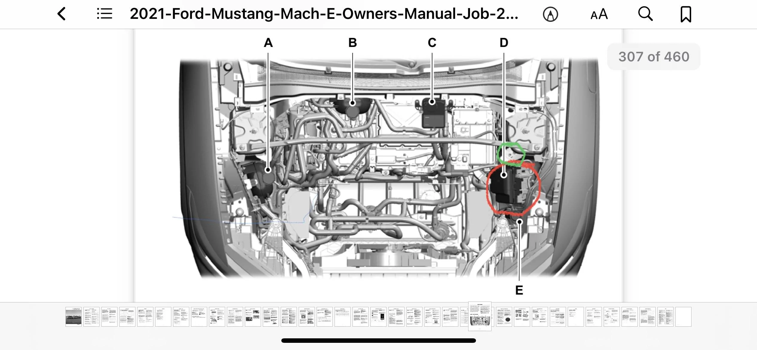

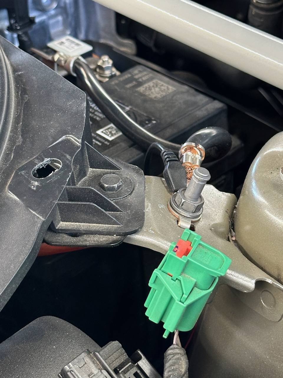

The 12V battery “jump points” are: Positive located near the fuse box (D, circled in red). Negative is a post on a tan that is mounted to the driver’s side strut tower (circled in green). You must remove two of the beauty panels to access them. Really dumb On Ford’s part. ??

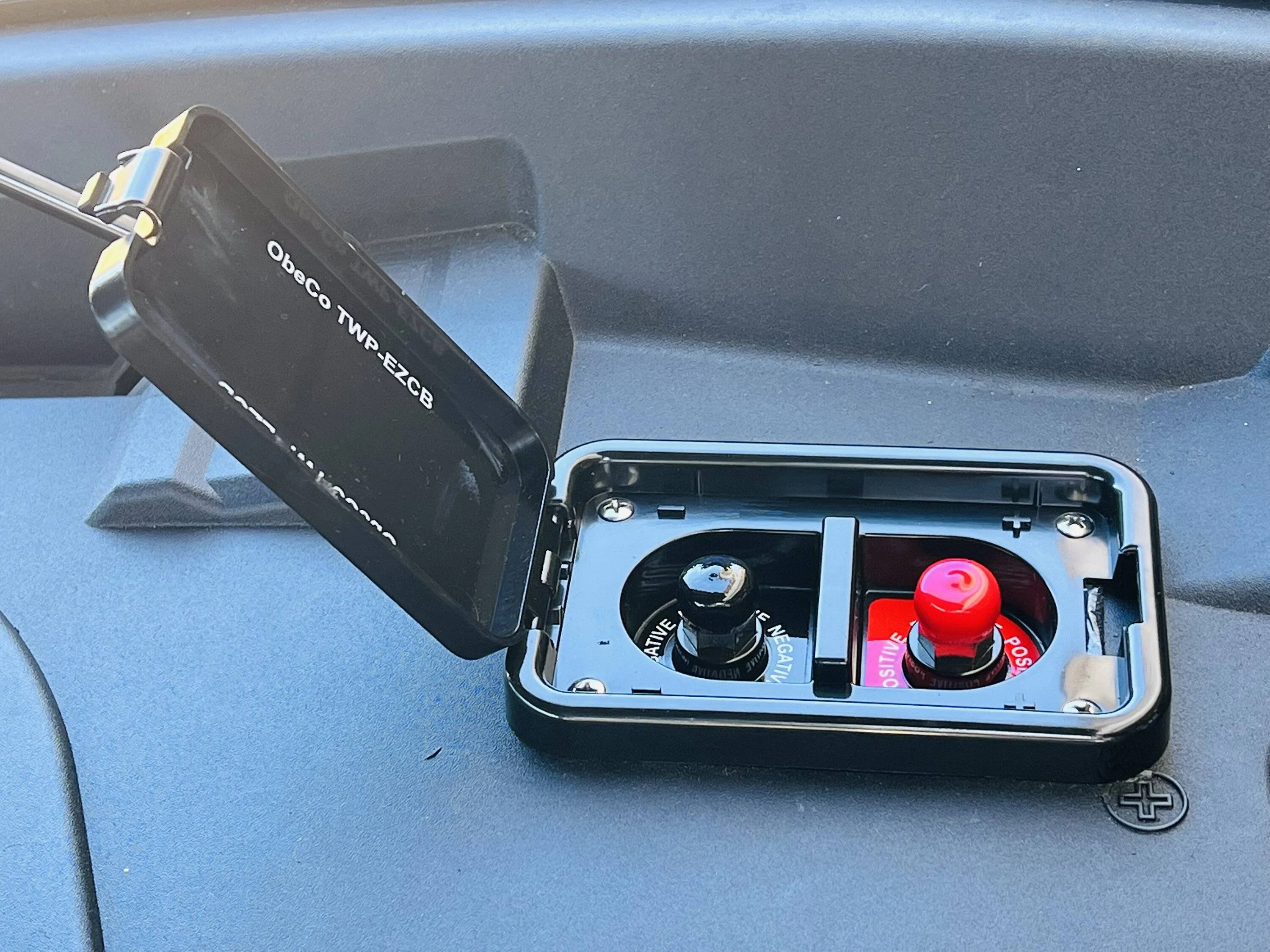

I added this:
Hunting Pudelster
Where did you get that cover for the battery terminals?
13,005
17,528
Hunting Pudelster
It’s a race car jump point, not a cover. With the right cabling, it will spin a 600+CI high compression engine. I got it from Eddie Motorsports. They’re selling it through Summit now, so a little cheaper than when I got my first one. ??
Thank you
It sounds complicated.
I know that my mach e has an accesible little compartment in the front bumper that has 2 jumper cables that stick out. Is that not the same as what you installed? Sort of?
13,005
17,528
Thank you
Not at all. The jumpers in the hole in the front bumper are for opening the frunk lid if the 12V battery is gonzo dead. They do not work to open the frunk lid if the battery has any juice at all left in it. My jump point is intended for providing 12V power while the car is undergoing FDRS updates. ??
