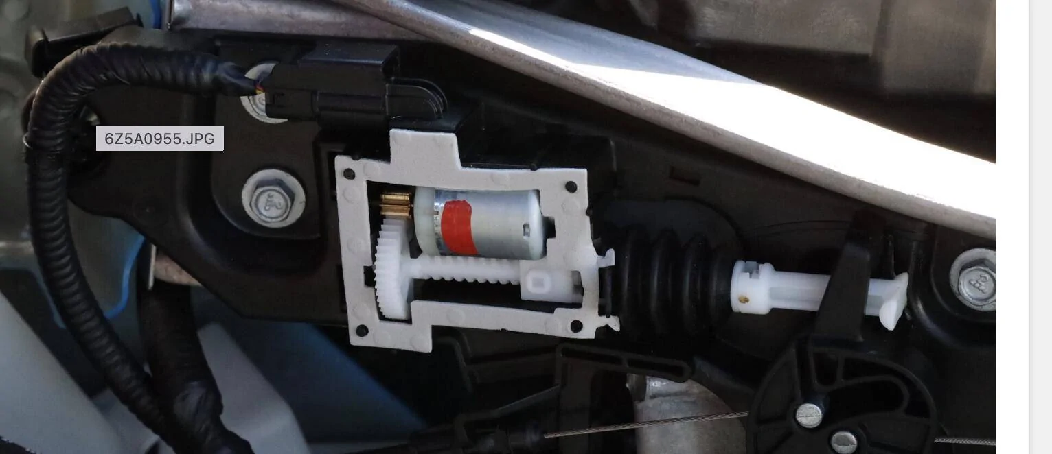

The actual waveforms might be interesting, but I am not sure how much more there is to measure or calculate. I guess through careful analysis we could define a more exact amount of power/energy required, say whether AAA would work or just AA batteries. Is it interesting enough to make more study of the frunk release, not sure?
The frunk release motor (runs twice to open)

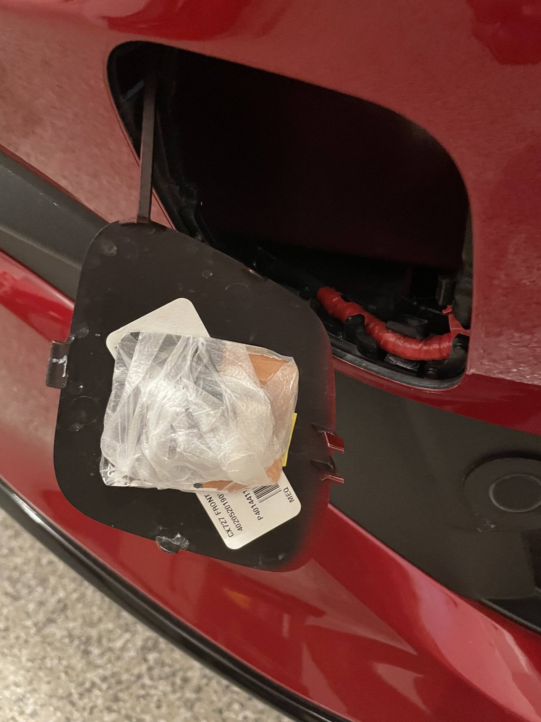

Yes and that very same thread is the one I was referencing above when I mentioned that operation of the frunk release mechanism requires about 1.2 amps @ 12v.
Those small 12v cells that were taped to the inside of the emergency frunk release cable access port on the front bumper cannot provide any more than 15ma - 25ma at best, which does not even come close to what's required to release pop the frunk. Those small cells are nothing more than several button cells (watch batteries) in series to provide 12v, but at extremely low current capacity.
With that said the conclusion to the testing done in that thread was that 8 AA's in a 12v series configuration battery holder seems to be the safest most reliable solution available.

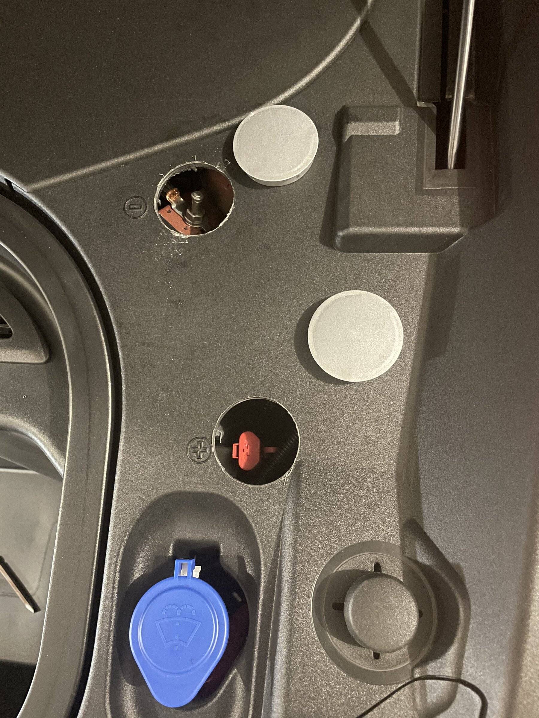

Took me about 6 minutes to complete the project listed in another thread and add access holes so I can jump start it myself. I then taped a $4 12V battery behind the bumper to open the frunk, and put my mobile jump starter in the frunk. Total cost about $18 for a hole saw bit, plugs and those batteries plus the cost of the mobile jump starter ($80).
That said, I agree it’s a stupid design by Ford and this shouldn’t be necessary, but it is, and at least it’s an easy fix if you think of it ahead of time.
The battery access project is very easy and thanks to all who gave me pointers on how to best do it, but I do need a little more advice to make it really perfect. I cut 2.5 in holes and got 2.5 in hole plugs and they fit too perfect as they are snug but not tight and I feel as if they will vibrate loose. Any ideas as how to tighten them some and also some way to be able to get them out with ease as the fingernails will not work once it is a little tighter and I do not want pry marks. thanks again to all for your help.
I used 2” plugs, and they are pretty tight. I put a small flat head screwdriver in the frunk with my jump starter.
Still need to decide on how I will get the frunk open though.
right, thanks. will one of the brick size battery boosters work to get frunk open

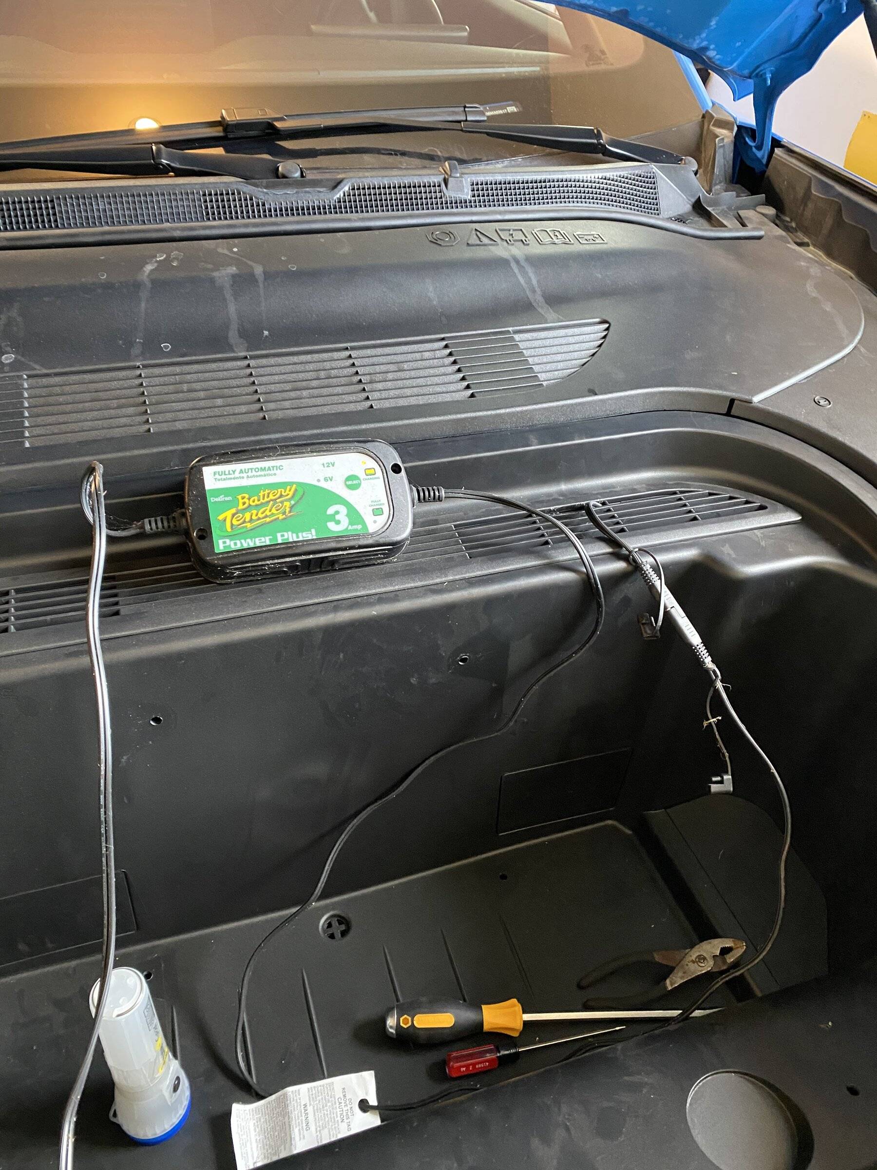

I had a major 12v issue last year (November 2020 build).
In my view, it still isn’t right.

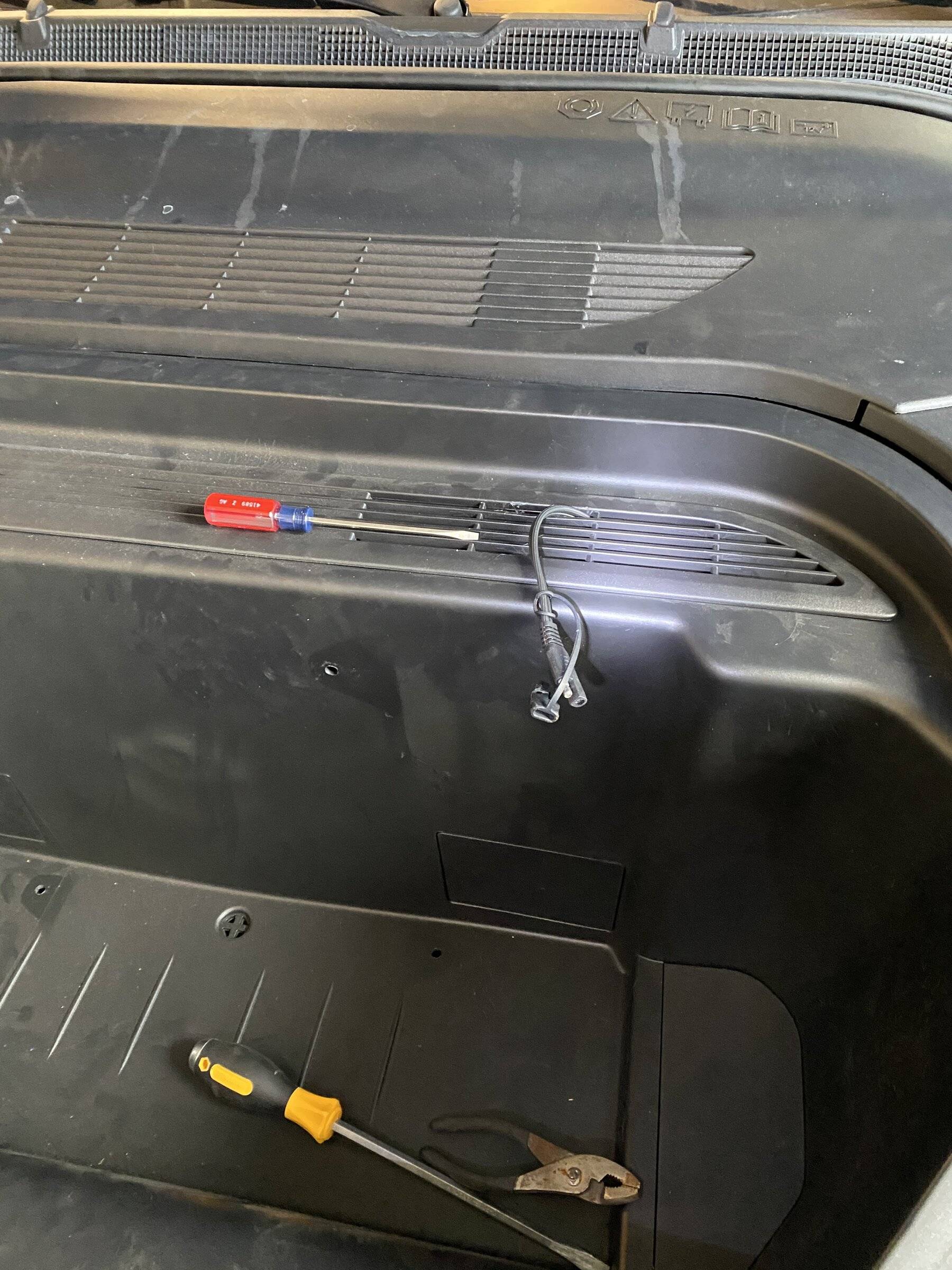

I initially ran a quick charge cable through the vent for easy access (see pics Below). Easier access would be to run the 12v quick charge cable to the front bumper access.
a battery tender hooked up to front access port won't do you any good at all. you MUST use the 'connection points' under beauty cover..... but if your HV is not charging the LVB when it hits 11.9 automatically, then you should get it actually fixed. Battery tender should NOT be needed.
He's talking about running cables from the connection points to the access panel in the bumper, not using the cables that are already there for popping the frunk.
This ^^^
If you buy a Battery Tender, you can then buy an extension, either 6 or 25 feet, which allows you to run it pretty much anywhere.
On my F-150, I run from the battery, across the front of the car, and down into the left front wheel well, because that's what I can access with the truck pulled into the garage. When not in use, I tuck the end of the cable up into the wheel well, so the end doesn't get covered in snow/ice/slush. It popped out once and wore off the connector's cap hitting the tire. The company sent me a few extras, I own 3 Battery Tenders.
Based on others having issues, I will probably set mine up soon, and at least connect it every now and then, although even today with temp this morning below zero (now around 8), my garage right now is 26, at least on the thermometer mounted outside the door.
I haven't studied the Mach-E, but likely running it to that port won't work for me, because that would mean I have to squeeze around the front of the car to connect it. Also, that port is not made to be opened and closed all the time. I'm going to look and see if it's feasible to run it to the charging port, but I don't want to drill through the plastic there. More likely is the left wheel well...
