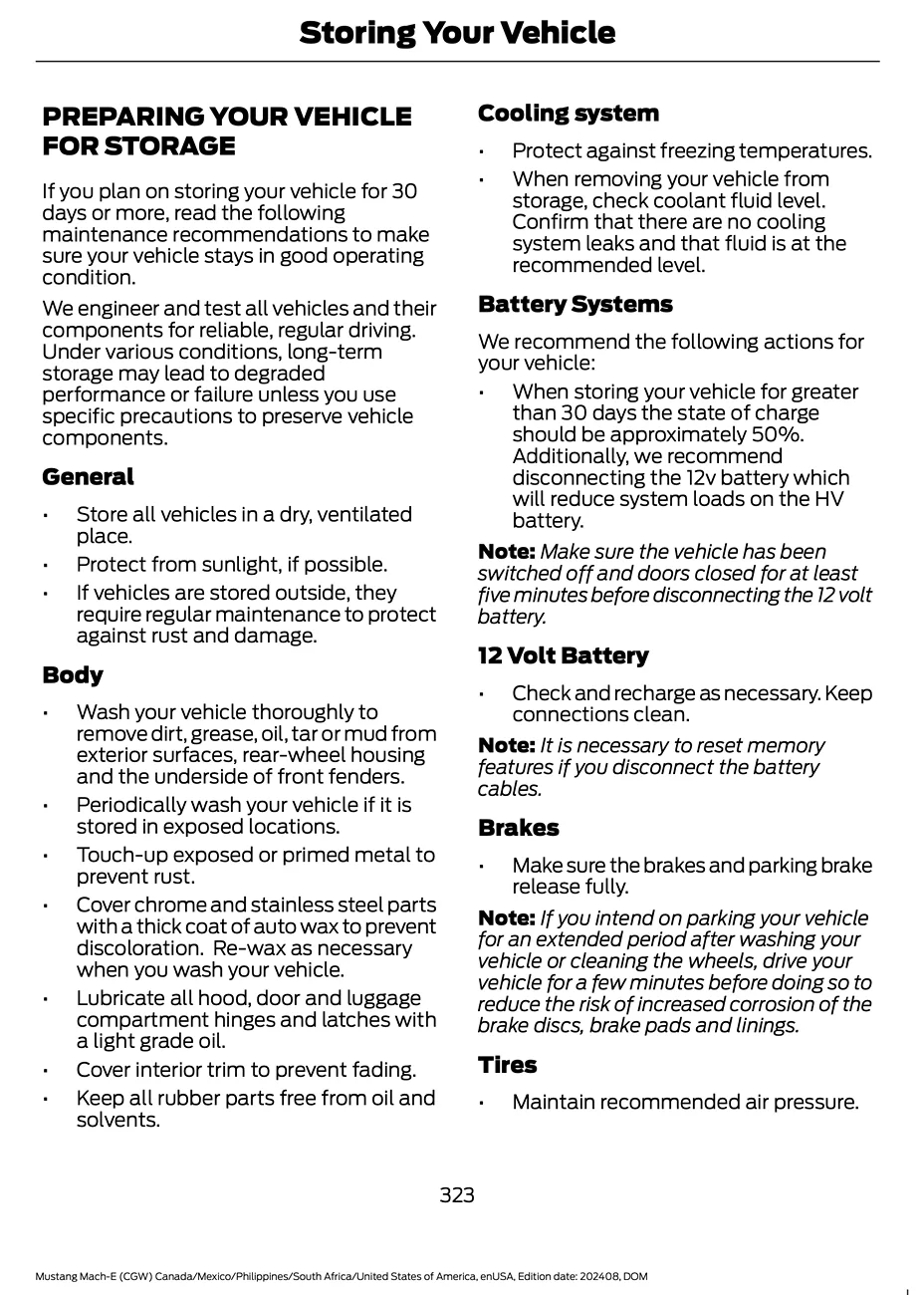

You could also use the port in the front bumper and run a wire pair externally through a door that would go to your solar panel inside the car. The only problem with this is that those connectors are dead until the voltage drops below some point.
I run a scan gauge off the OB2 port. If I do not unplug it at night the voltage will be just below 12v and the alarm to take my car to the dealer is in. When charging the car the 12v system stays charged up, but the 12v charging goes away when the charging stops. Someone came up with this info below if it helps.
The port in the front bumper does not supply power to the 12V battery. It only works to pop the frunk when the 12V battery has actually died.
I had a ScanGauge always hooked up to my 2005 Prius and 2012 Plug-in Prius and they never had a problem with the 12V battery drained. Unclear why the Mach-E would be different, unless the ScanGauge is keeping the various system modules active even after powering off the car and waiting 12-minutes.
