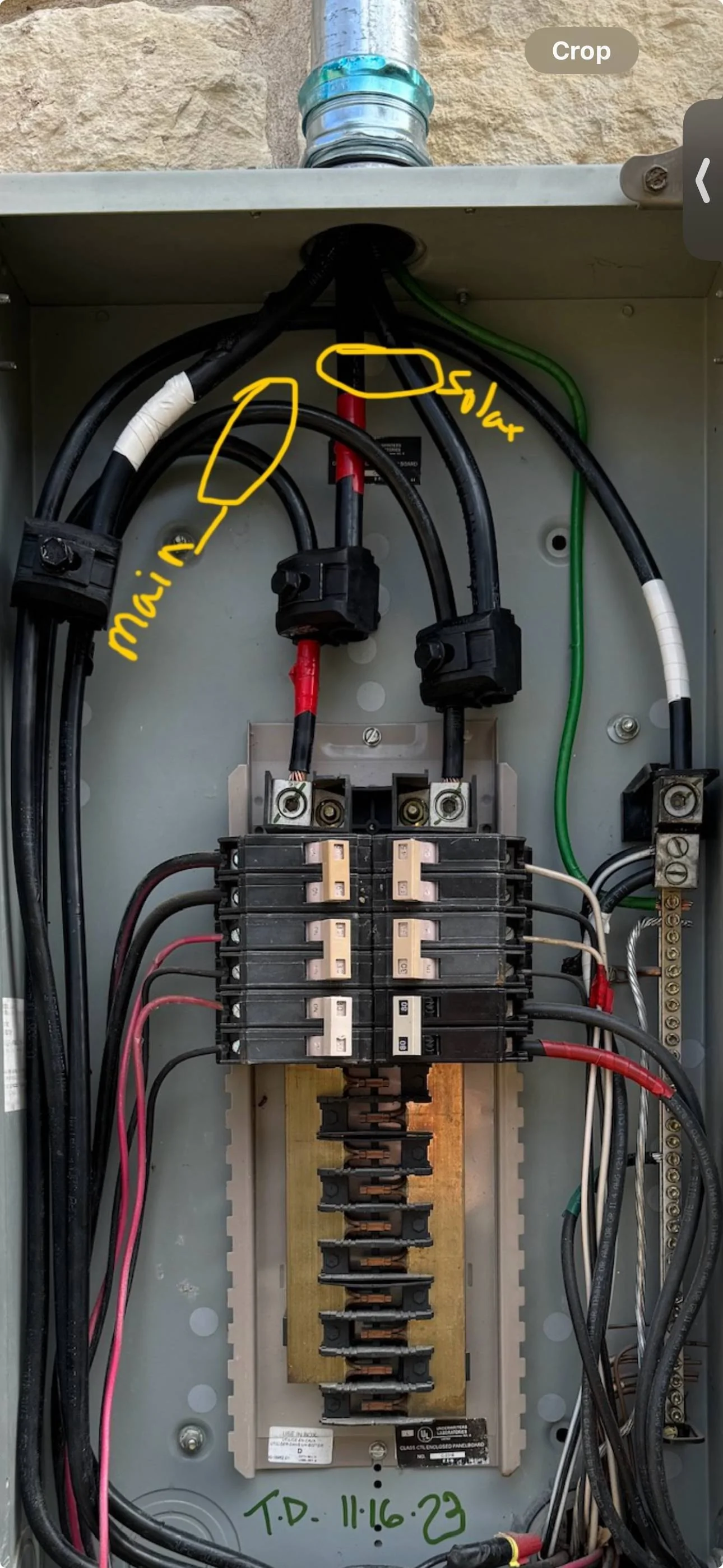

Thanks so the EMPORIA LEVEL 2 EV CHARGER WITH LOAD MANAGEMENT should be what I want for charger and sensors in my main panel? Also, does it look like the regular 50amp CTs will be big enough for the diameter of the solar incoming cables?
Yes it should. As long as they are not wider than 10mm.
