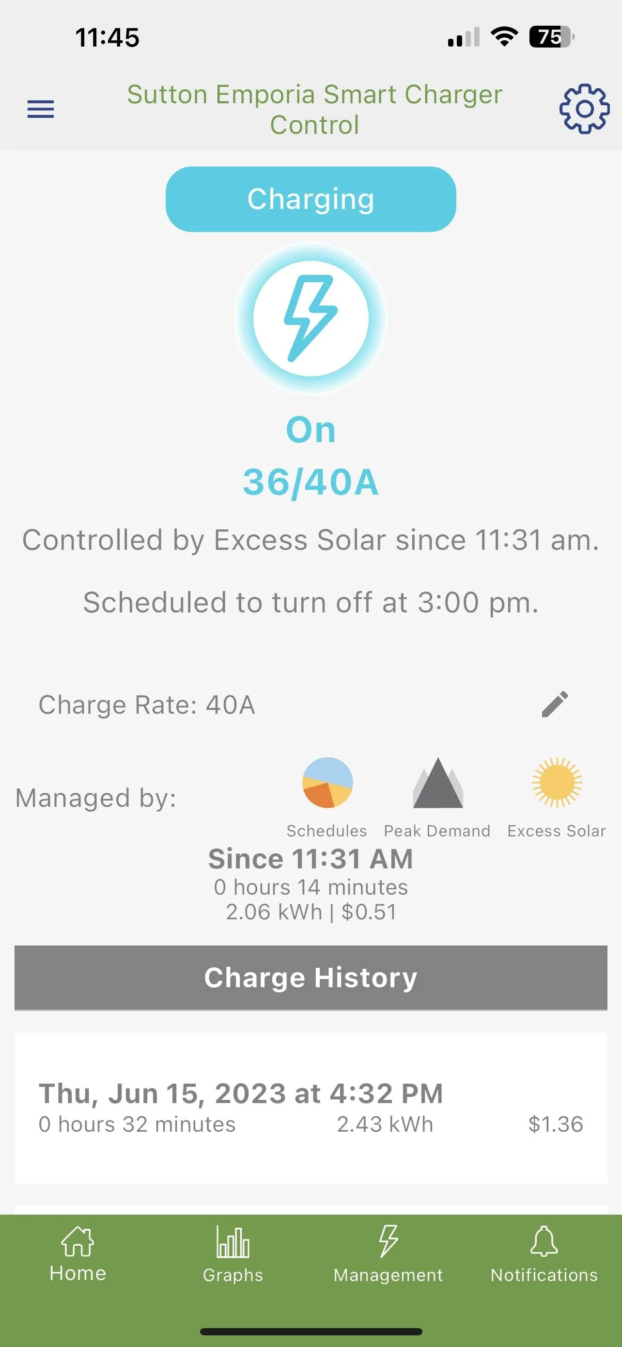

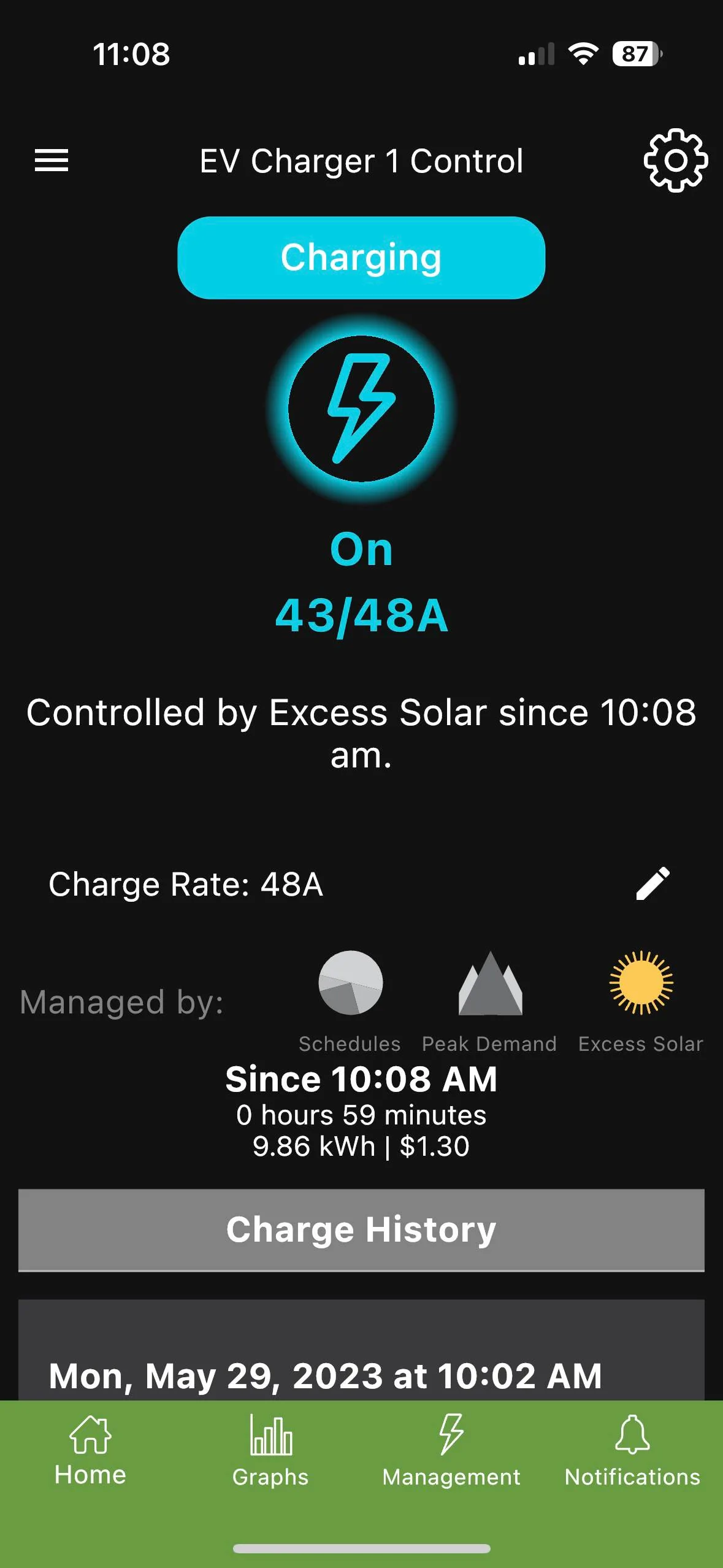

John, on your Emporia app, charging screen, why doesn't it say "Controlled by Excess Solar"? Like this:

Thanks Mark / Michael. I am still waiting for a call back from Emporia. It is charging a little better and not draining my Powerwalls as much. What is still a problem, it starts a EV charge when it hasn't pushed any energy to the grid. The app appears to be seeing the energy level just fine. I have reset and rebooted and such to no avail. Hopefully they will call tomorrow.
John & Mark: Based on my own experience and system, I'm convinced the settings in the Tesla app are one of the keys to resolving the situation we're experiencing with the Emporia charger.
When I set my Tesla app on "Self-Powered", the Tesla Gateway pushes Powerwall energy to the Emporia charger. That means the charger maintains its maximum rate of charge, in my case 40 amps. The Powerwalls make up for any shortfall in excess solar production. That scenario can drain the Powerwalls pretty quickly, as you've pointed out.
However, when I set the Tesla app on "Time-Based Control", it works far better. The Tesla Gateway knows not to draw any power from the grid during Peak or Part-Peak hours. It also doesn't rely on energy from the Powerwalls to power the charger. That means the Emporia app is free to sense excess solar energy being dumped to the grid, and begin charging accordingly.
But here's the rub: I have to switch between "Self-Powered" and "Time-Based Control" every morning! That's because if I leave the Tesla Gateway set to "Time-Based Control" overnight, it will make use of off-peak grid energy when I'd rather be using energy from the Powerwalls. But if I leave it set to "Self-Powered" during the day, the Emporia charger won't be able to restrict its use to excess solar energy alone.
What we really need to figure out is the optimal way for three different but related apps to interact: the Tesla app, the Emporia app, and the FordPass app. How have you got yours set to work well together? The problem is they each are capable of doing similar things. For example, I set the FordPass app to "charge when plugged in" because otherwise it wouldn't allow charging during peak grid hours, even if there is excess solar energy available.
Thanks for your thought-partnership here; I'm learning a lot from you guys!

Michael, I have mine set to Self-Powered and the Emporia charger only charges on excess solar. It makes no difference how I have the Powerwalls set, the charger only charges on excess solar.
Maybe this whole issue has to do with the way the Powerwalls and Gateway are setup. I also have the older Gateway 1 while you guys might have the Gateway 2. I have a separate backup panel that the Powerwalls power in case of a grid outage however when I set it to self-powered, the Powerwalls power the entire house, not just the backup panel. My solar inverter and Powerwall breakers are in he backup panel while the EV chargers are in the Main panel.

However, I don't have this problem with my PowerWalls when they are set to either Time-Based or Self-Powered. Maybe this issue only affects some of their EV chargers? I have two chargers and neither one have this issue. I assume they said your sensors were connected properly and your app set up correctly?
Yes everything connected properly. I sent them the screenshots and they confirm the Vue is seeing the power going back to the grid and it does match up with what Tesla is displaying.
I sometimes see controlled by excess solar but not all the time. This morning it starts charging immediately even though the Powerwall is not fully charged and it has yet to sell back any power.
Frustrating. Hopefully the fix is not long off. They did not have a ETA just said it is taking longer than expected.

My Emporia app looks the same as Mark's.
Ford Mustang Mach-E Smart Solar Charging Emporia A
