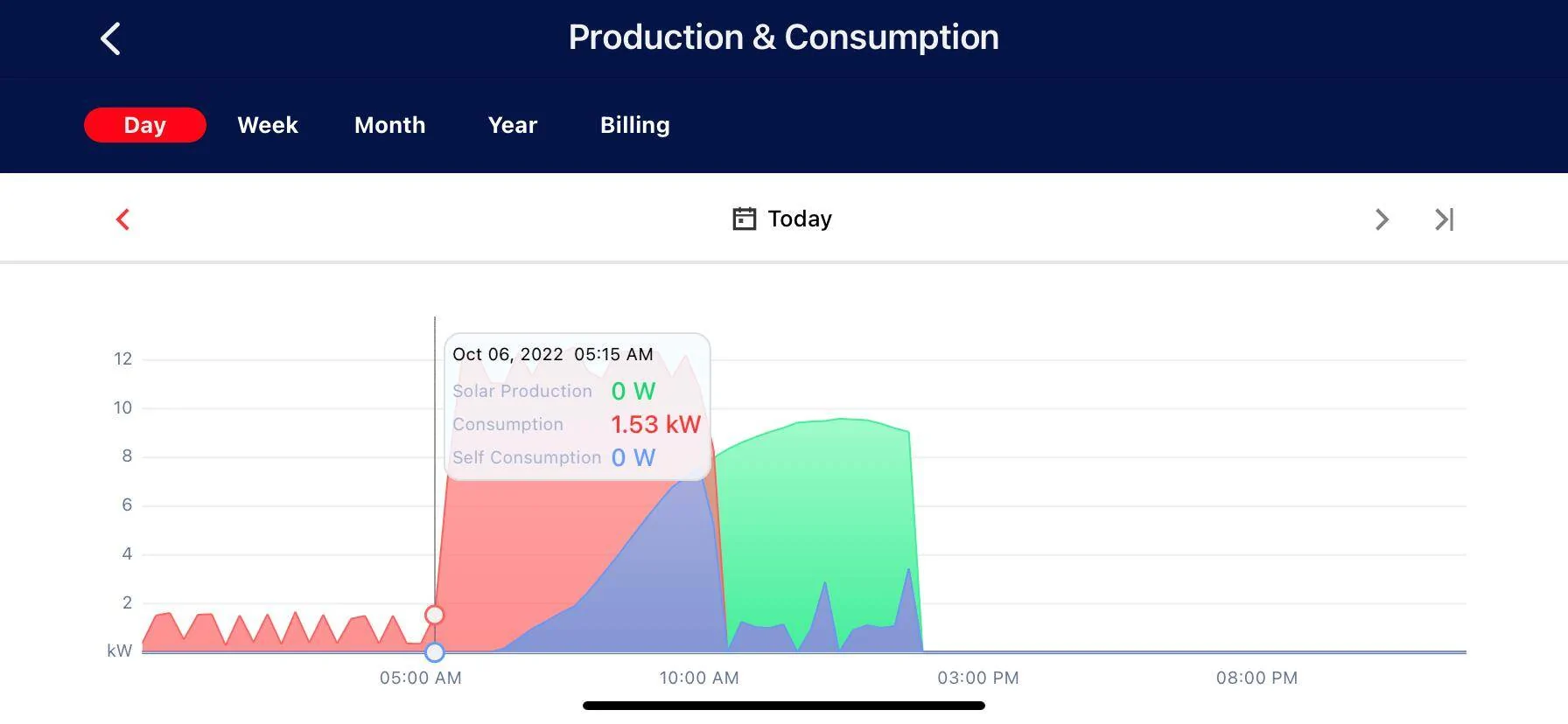

Below is a pic of my current solar production today in suburban Phoenix on a clear day. System peak production when activated in July was just over 11 kwh. Notice on the graph that I plugged in early this morning to charge and you can see what the impact is on consumption. I have a Grizzl-e Classic set at 40A. By adjusting what I'm drawing, I could fall within the production curve but probably wouldn't be able to fully charge when starting at a low SOC. The session below delivered 47% over 4:47 hours with estimated 142 miles.
Ford Mustang Mach-E Optimizing Home Charging for Solar SolarConsumptionOct6
I would charge every night off the Powerwalls, to 90% from 12-6am. Then you won’t get a 13,000 watt spike just as the Sun is coming up. Your graph will thank you.

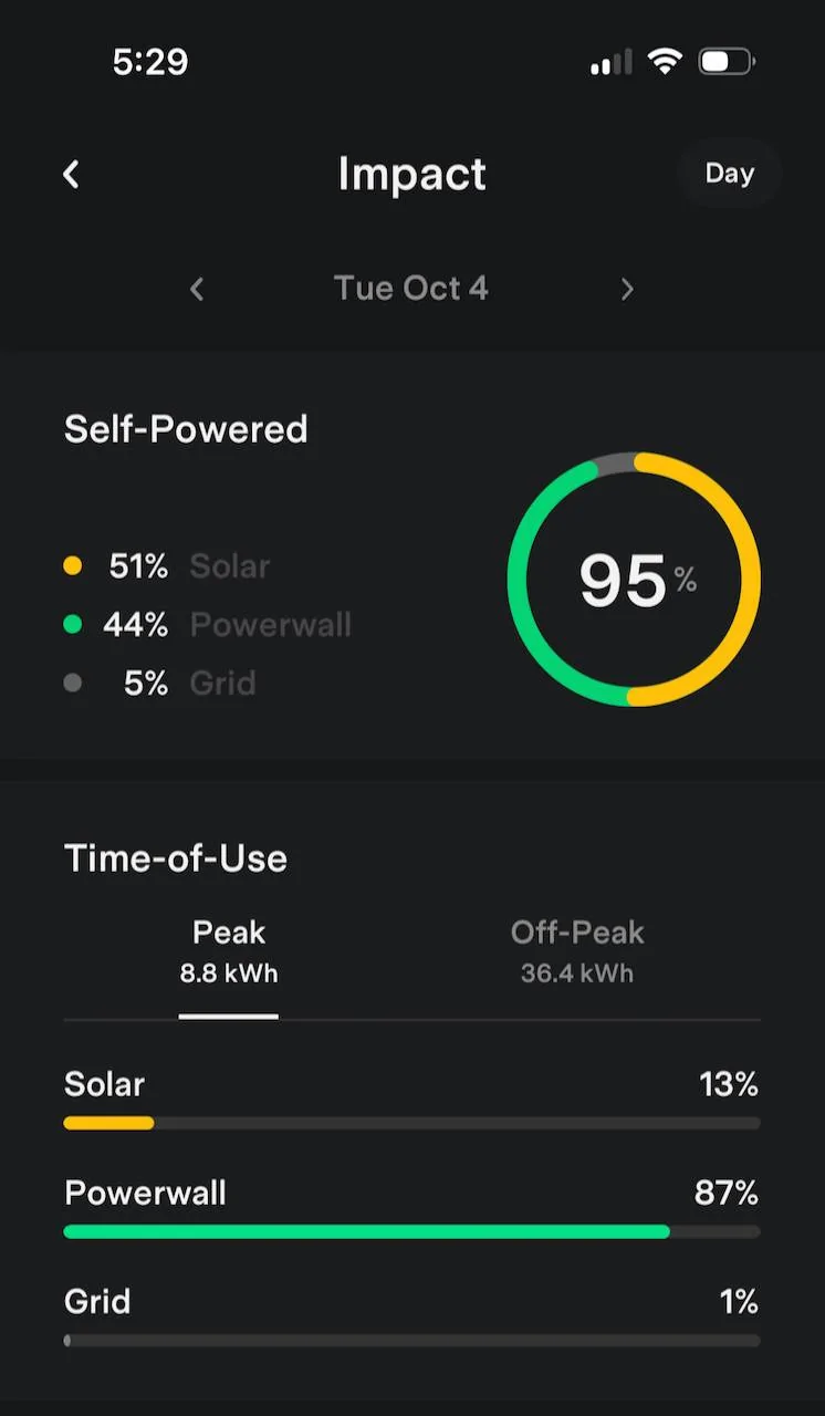

My typical daily power broken down:
Ford Mustang Mach-E Optimizing Home Charging for Solar IMG_3101
