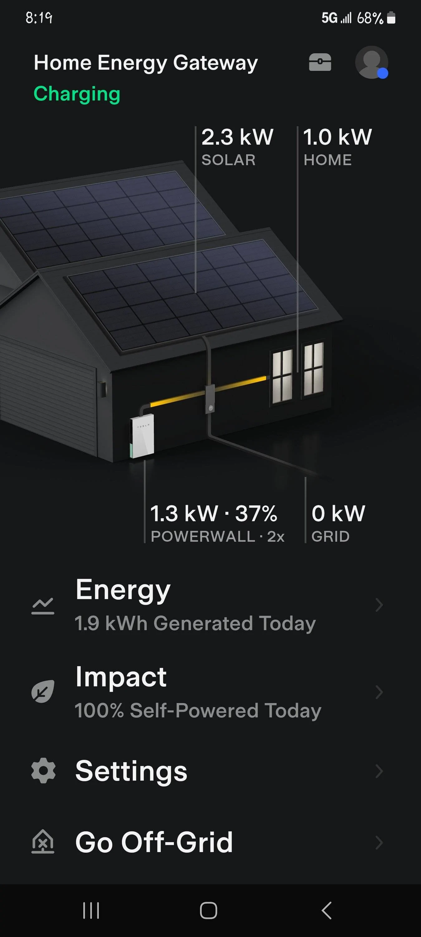

No. I moved the two 200A over to the backup gateway. Maybe I am wrong but the two 200A feeds into the main panel would also receive power from the two Powerwall’s. In the picture above in post #97 I am monitoring the supply line as labeled in the backup gateway. I did move around which way the sensors are pointed and located to troubleshoot.

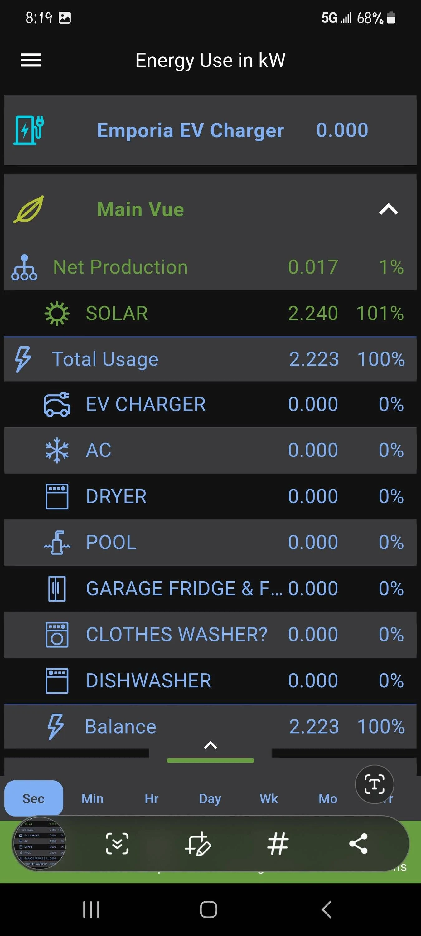

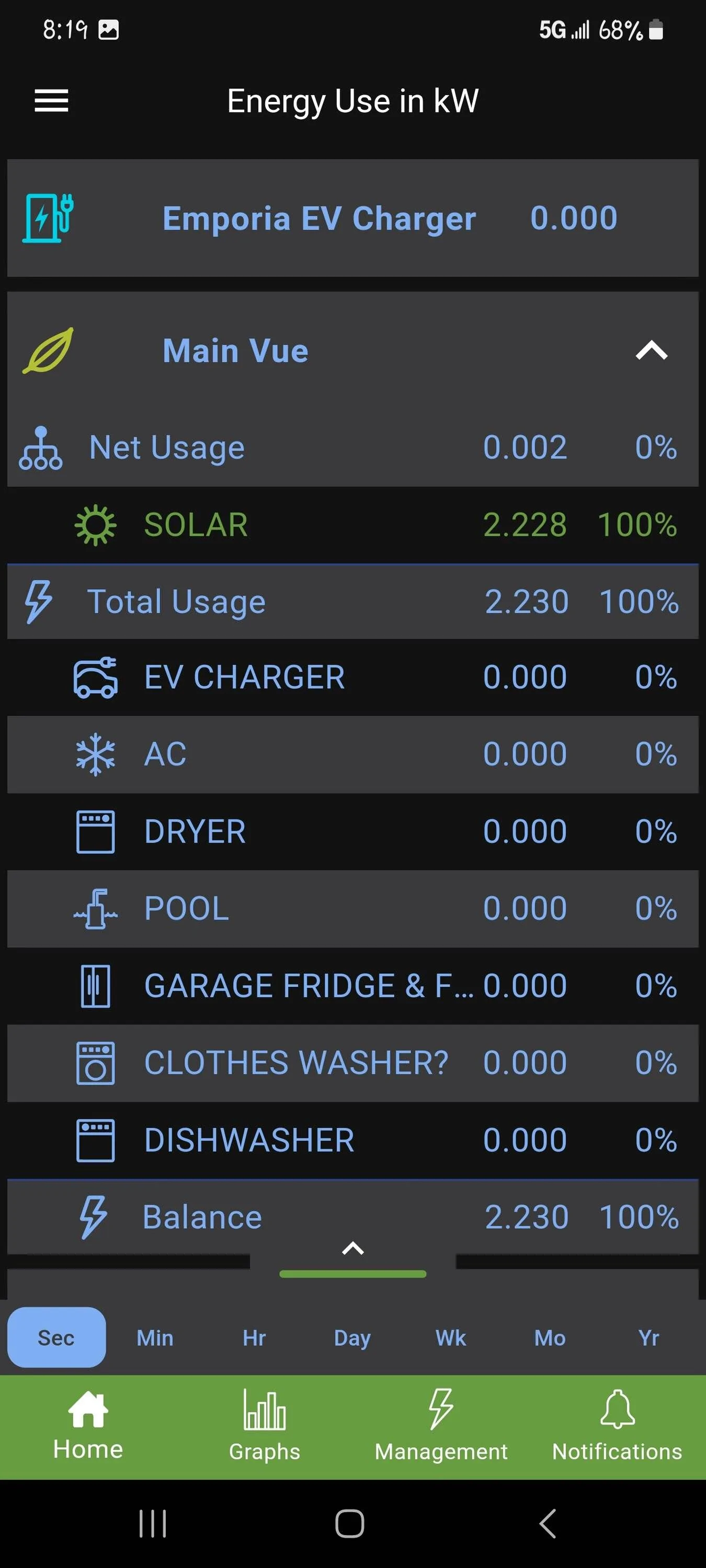

Yes. Net Usage / Net production appears to bounce around a lot. Goes in and out green/blue randomly. Pictures of this are below.

Ford Mustang Mach-E Smart Solar Charging Screenshot_20230605_081906_Tesla
Ford Mustang Mach-E Smart Solar Charging Screenshot_20230605_081912_Emporia Energy
Ford Mustang Mach-E Smart Solar Charging Screenshot_20230605_081913_Emporia Energy

Let's start here. You are showing an "EV Charger" under devices in your "Main Vue". You don't have a generic "EV Charger". You have an Emporia EV Charger which you can see is ABOVE the Main Vue and it should be nested IN the Main Vue. Go to Manage Devices > Main Vue and remove that EV charger. Then go back to Manage Devices > Emporia EV Charger > EV Charger Info > Nest Under > and choose Main Vue

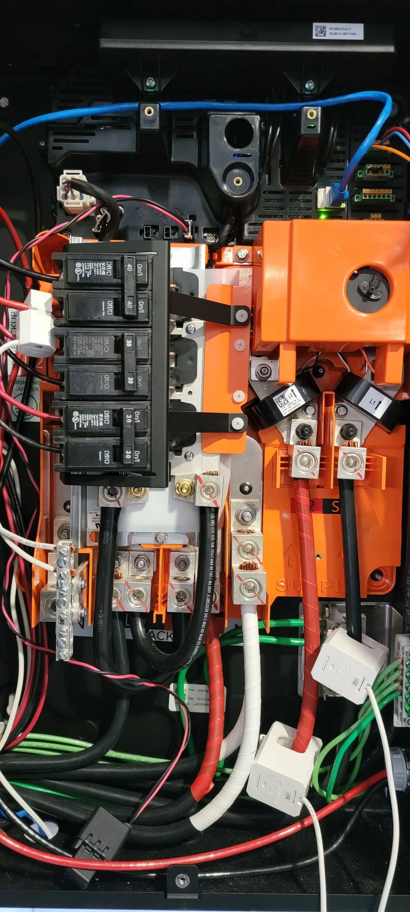

A question in regards to the probes pointing towards breakers. My Backup gateway has the two large probs, pictured below. Technically there are beakers in each direction. Currently I have the probes pointing away from the main service disconnect breaker on the outside of the house. The Solar probes are pointing at the breaker in the backup gateway. Thanks again guys I will test away
Let's go one step at a time....
What is that 50A sensor for on the left side connected to one leg of the 40A breaker?

Ok, figured it was. That makes no difference how or even if you have it connected to the Emporia Vue for your EV charger to charge on Excess solar. It all has to do with the two main 200A sensors and that must be where your problem is.
I don't think you should have your main sensors connected to the supply power in your backup gateway. They should be connected between the Main supply feed coming in from your power company to your Main panel.
I will remove the small 50a solar sensor. Sorry I am no engineer but if the supply from the grid was directly hooked up to the power panel there would be no backup/supply from the powerwalls. Isn't this the purpose of the Backup gateway to switch between grid and Powerwall?
