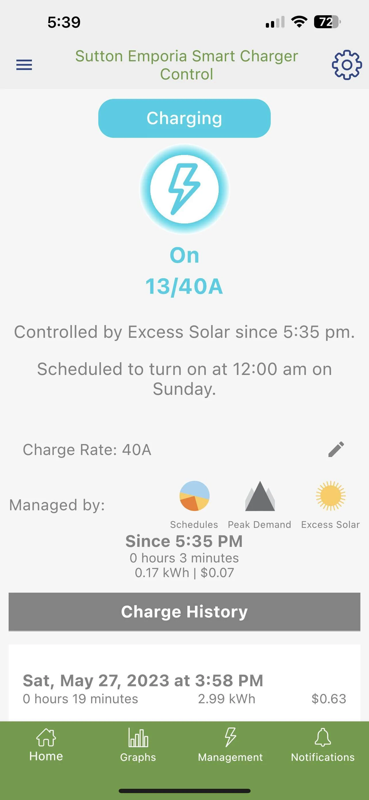

My newly-installed Emporia Level 2 smart charger immediately recognized my Emporia Vue Utility Connect, and began charging my GTPE using only excess solar energy. The MME seemed to accept a lower rate of charge without any problems.

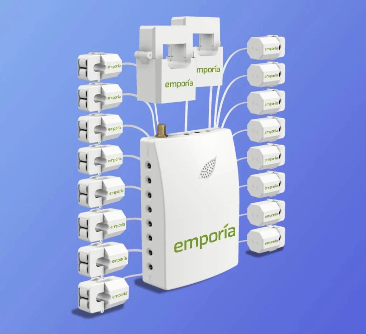

Do you have the Vue Utility Energy Monitor?

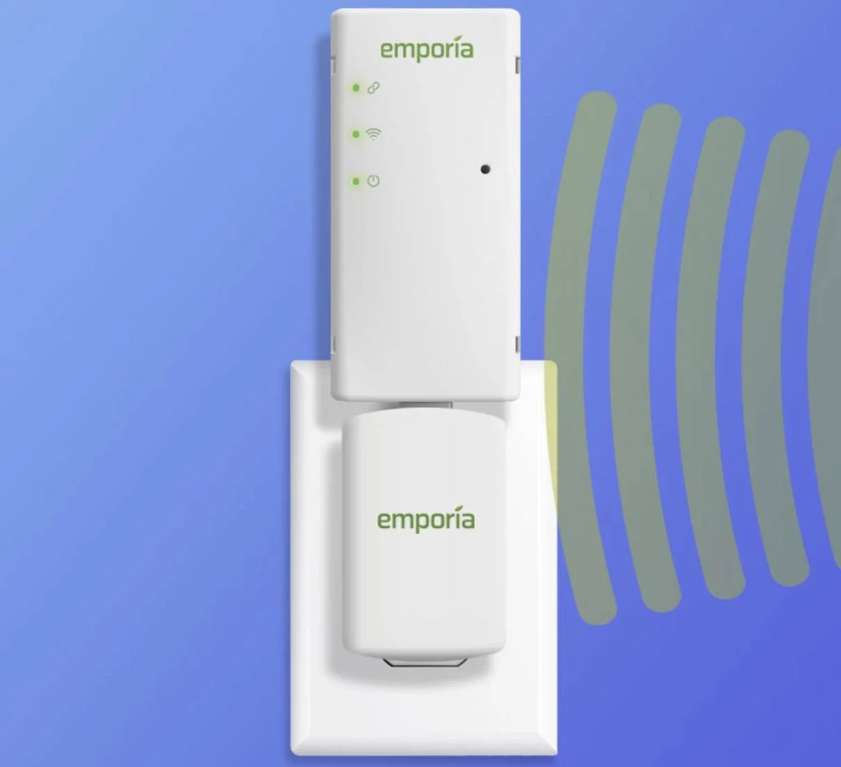

Or the Vue Utility Connect Wireless Energy Monitor?

To set up my Vue Utility Connect, I had to call PGE and ask them to authorize my Smart Meter for wireless access.
Unfortunately my city utilities smart meters do not have wireless access. Otherwise they are amazing with rates (buy .098 kW / sell .059) and plenty of rebates for energy saving devices. I probably need to monitor in different spots, ie Tesla Backup Gateway and the electric panel.
John, I will send you a DM and help you troubleshoot if you want.
