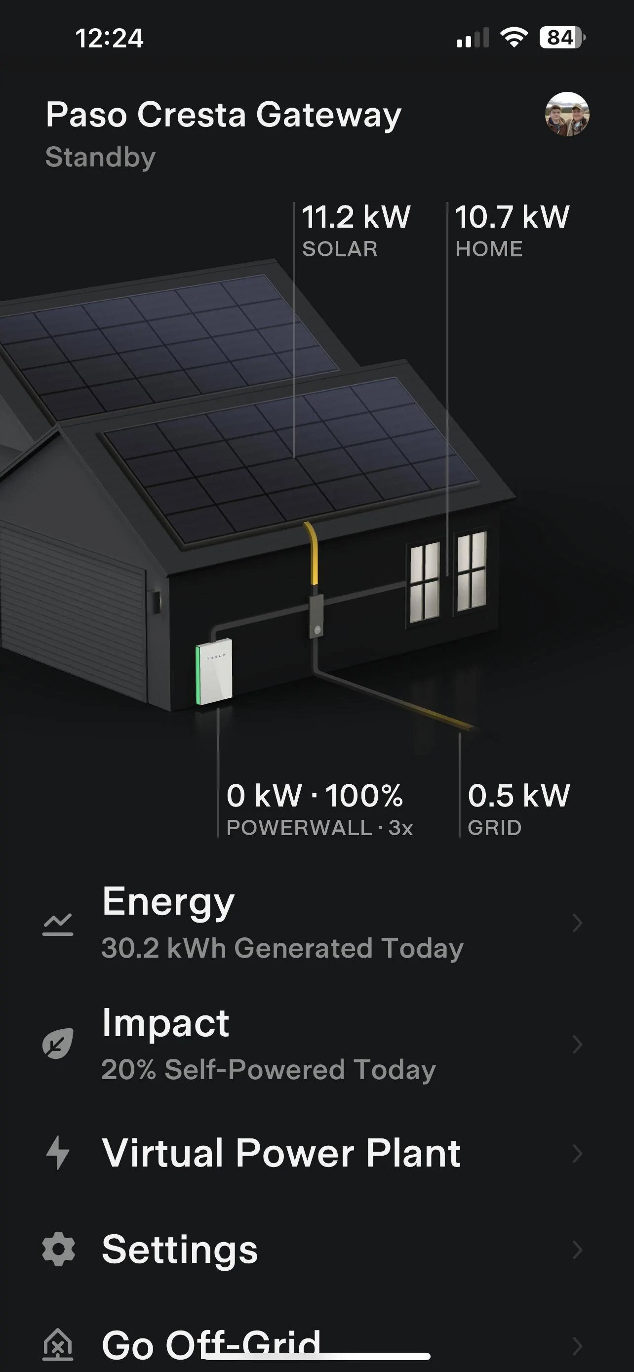

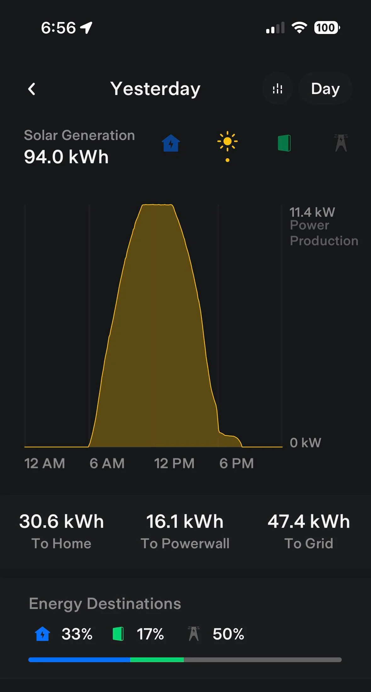

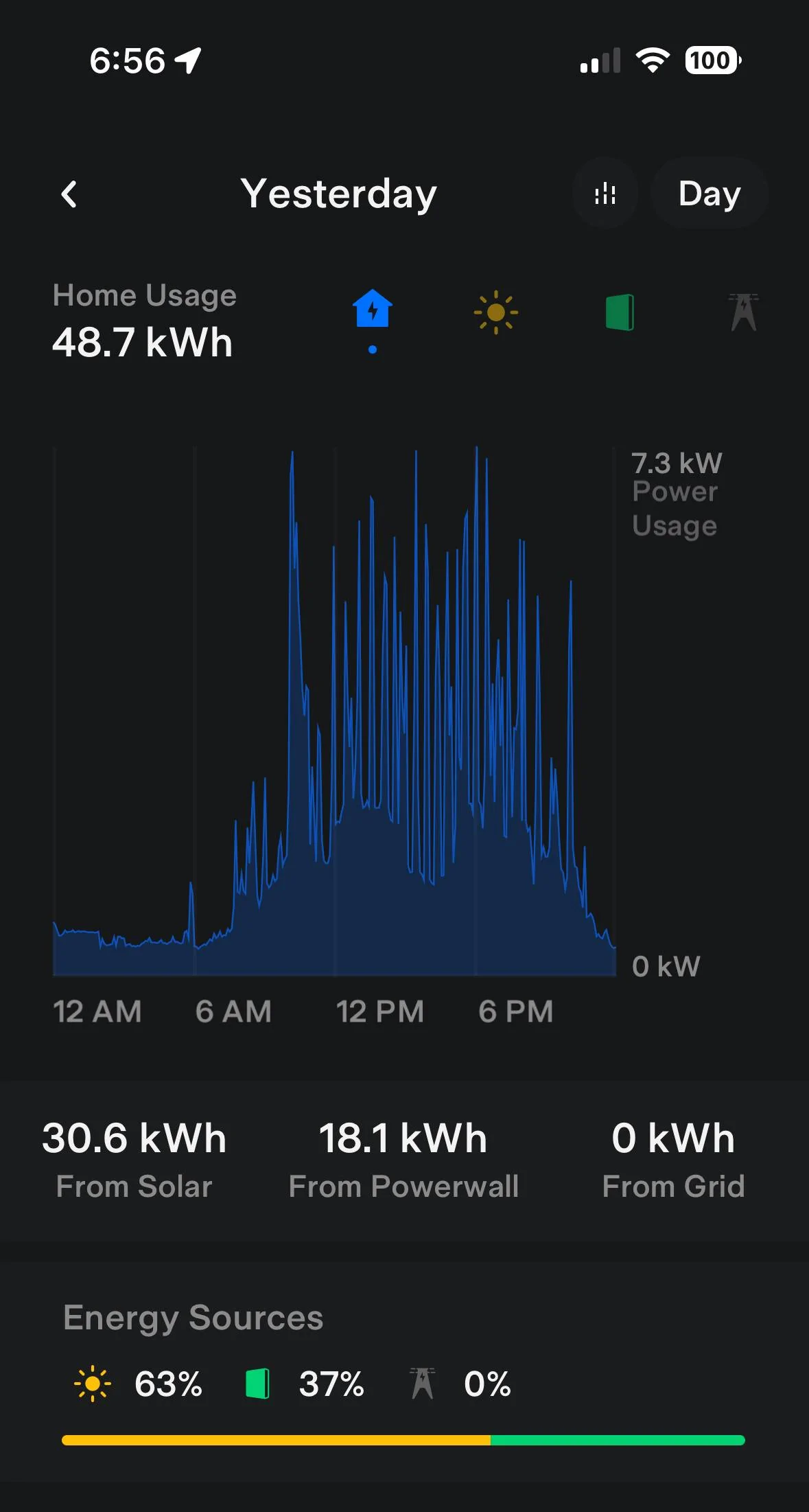

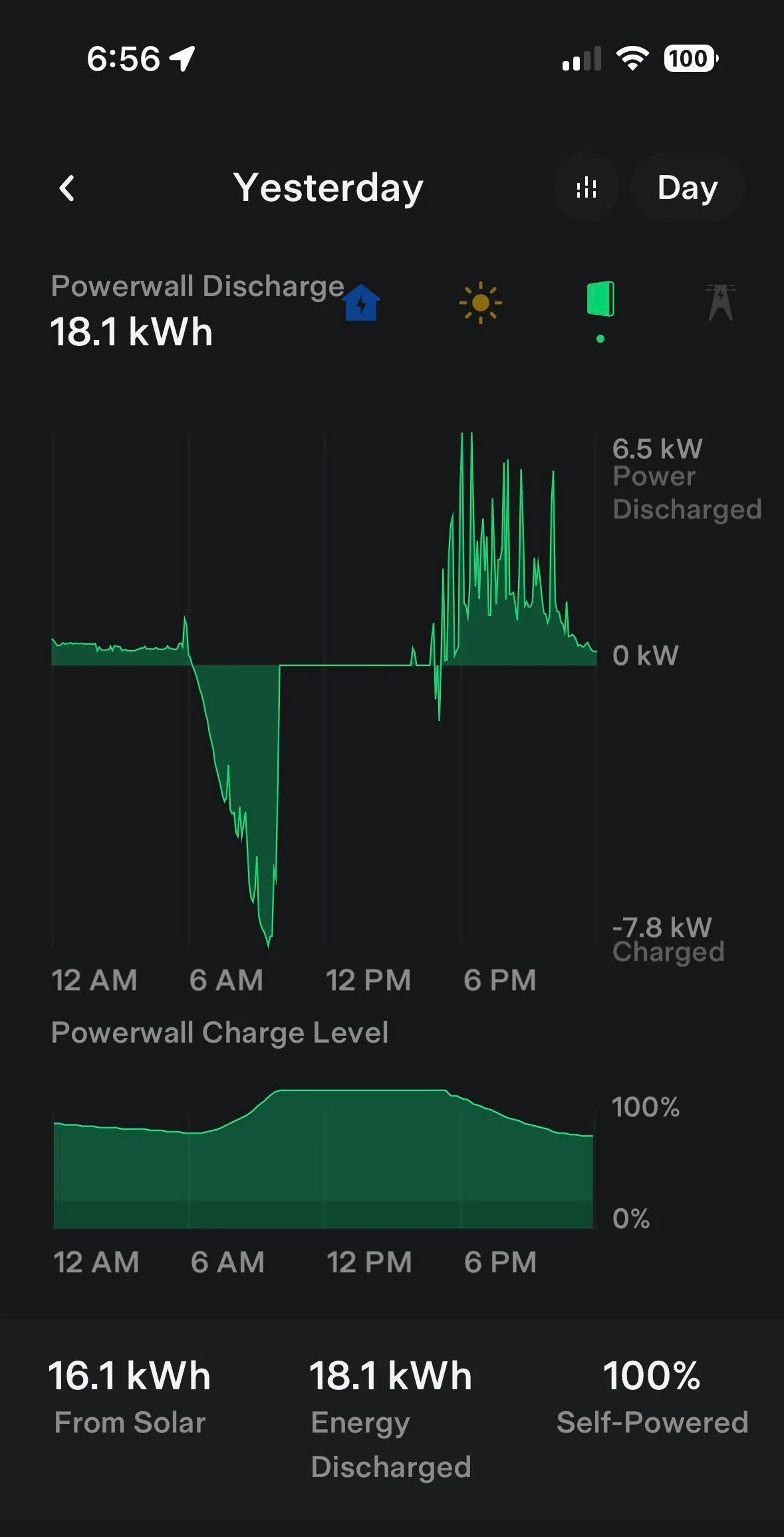

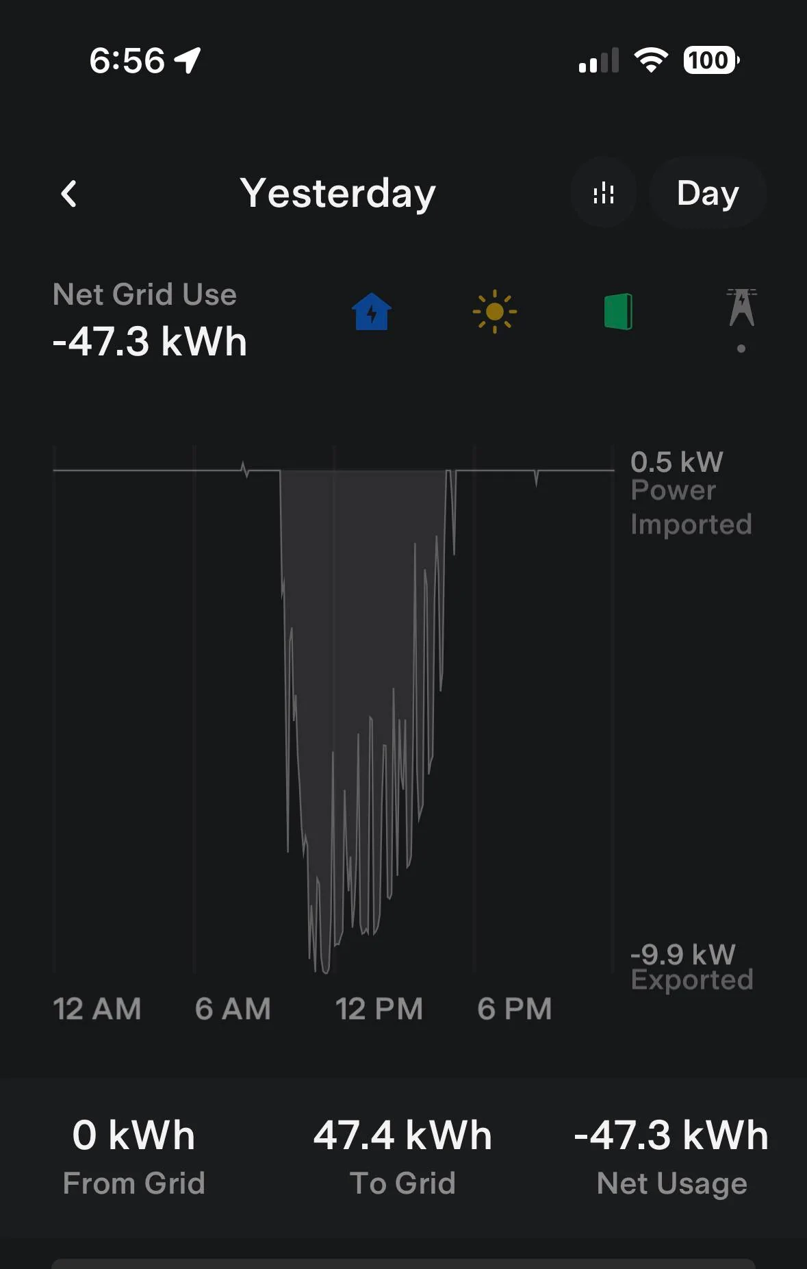

While we’re showing off solar apps, here’s my Tesla app illustrating my solar production and Mach-E charging using most of that solar power. Since the Powerwalls are fully charged, the small amount of excess solar power is being sent back to the grid.
Hey Michael, thought I would share yesterday's energy figures. Since you are familiar with the Tesla app, thought I would post these instead of ones from the Emporia app.
Yesterday I was out with my parents most of the day so I didn't have the A/C set as cool as I would have if I were home. It was still running quite a bit though as it was 90+ yesterday. I also didn't charge my car so there wasn't as large of a power draw as there would have been if I were home.
Home Usage:
Ford Mustang Mach-E Smart Solar Charging IMG_6002
Solar Generation

Powerwall Discharge

Net Grid Use
