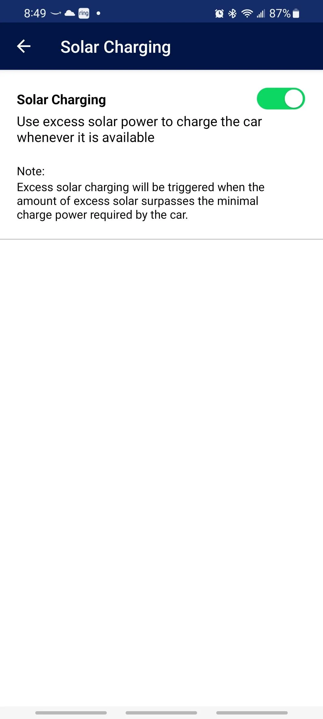

Not sure why a variable charging rate would trigger a charge fault?
Because of my electrical service, my current EVSE is derated to 40 amps rather than the 48 amps the Mach-E can accept. Other chargers are rated for even less power. So we know the car is capable of AC charging at a range of amps.
Anyone with an Emporia charger care to comment whether variable charging rates cause a fault in the Mach-E?
I posted earlier in this thread ( #5 ) that I use the Emporia EV charger and have the option "Excess Solar" enabled. The charger constantly varies the amperage in 1 amp increments from 6 to 48 amps. I have not seen any faults or issues on the Mach-E with this variable charging rate in the 7 months I've been using this charger.
Edit:
As a side note, the EV charger needs to see a minimum of 1.4kW excess solar for 2 minutes before it starts charging the car.

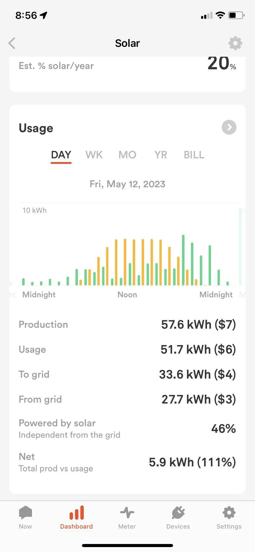

I am lucky enough to have a power company that doesn't differentiate between time of day and power generated. I get essentially a one-for-one exchange with my local coop. What I cannot tell you is how much I've generated vs what I've used (I know I've generated more than I've used since months where I use more than I generate I still only pay the base load rate of 21/mo). Regardless of that, I charge my MMe only on the weekend since I seldom use more than 50% of the battery over the course of a week. I also have a Nissan Leaf and a Jeep Grand Cherokee 4xe that get charged almost daily. So far I have managed to keep my usage below what my solar array (~12kw) generates in a given day (assumes sunny weather). We are also in the process of adding a battery, but that hasn't happened yet. I can only hope that my coop doesn't decide to reduce my reimbursement rate anytime soon.
I have a Sense Home Energy Monitor installed. It has a good App, that shows how much Solar is generated, and how much you pulled from the grid. It also "learns" which loads are on in the house, so you can see real time when the hot water heater, toaster, basement light, etc. is on.
Ford Mustang Mach-E Smart Solar Charging IMG_0003
