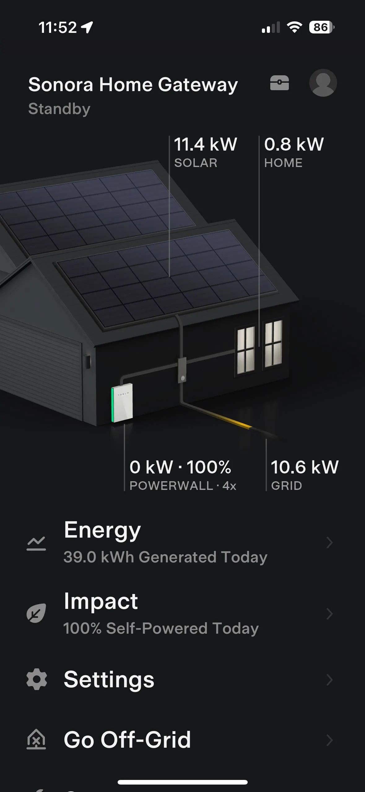

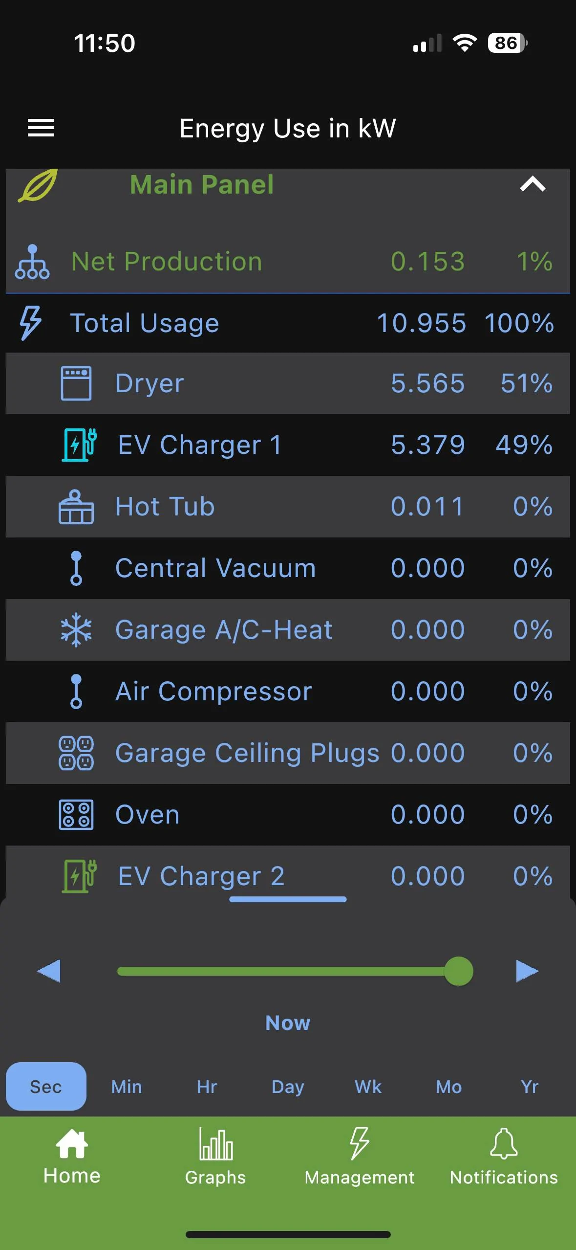

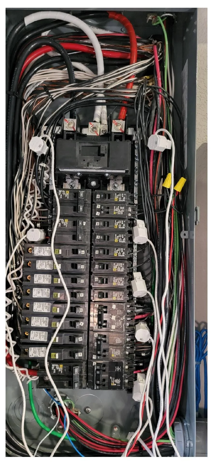

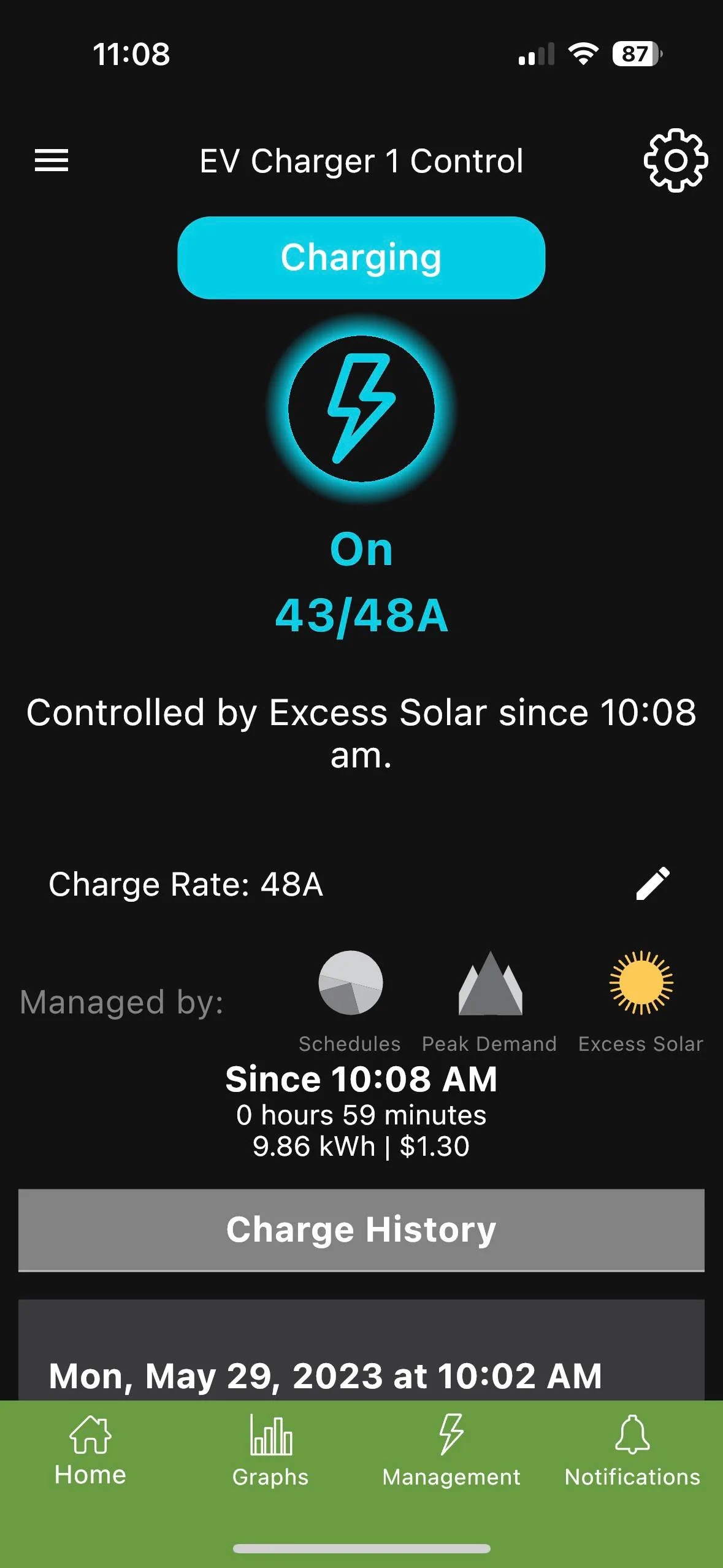

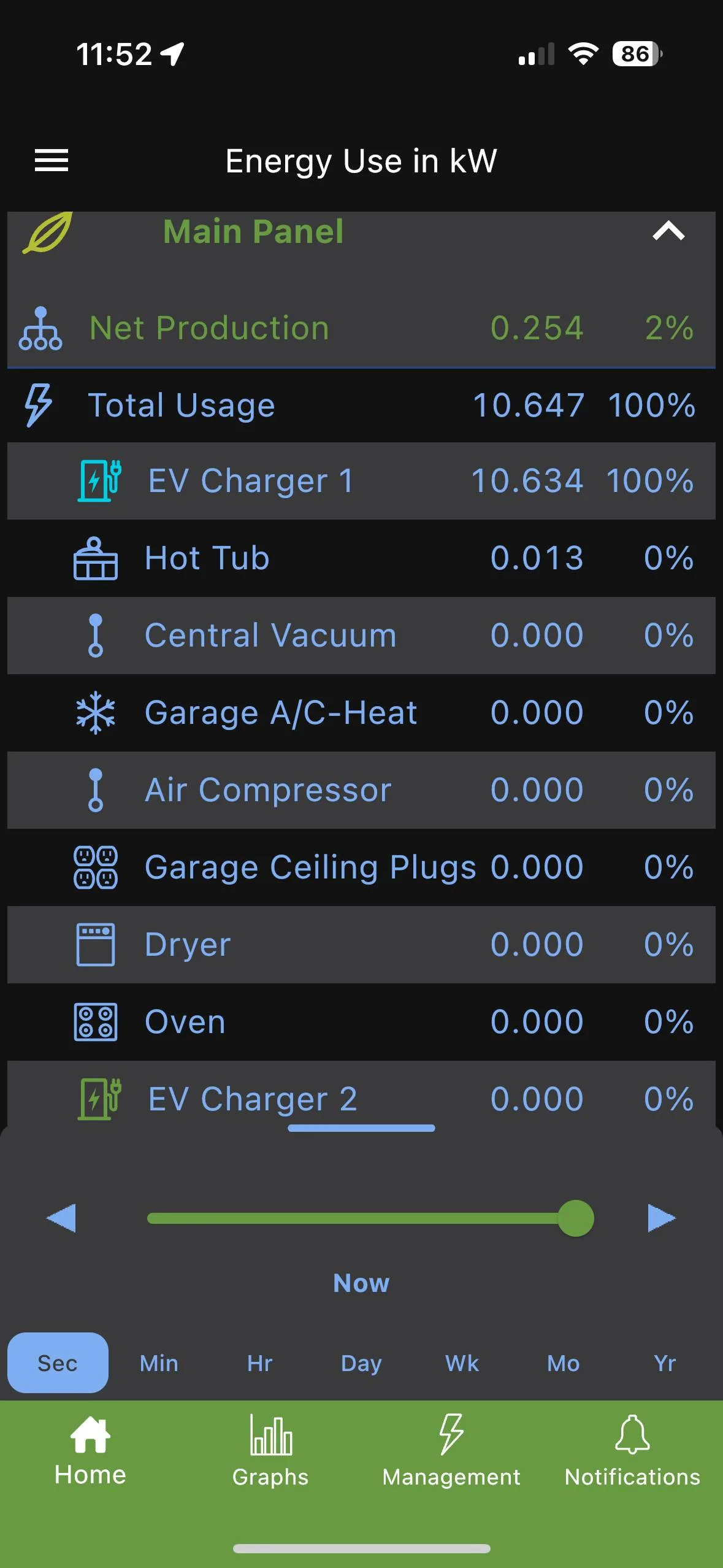

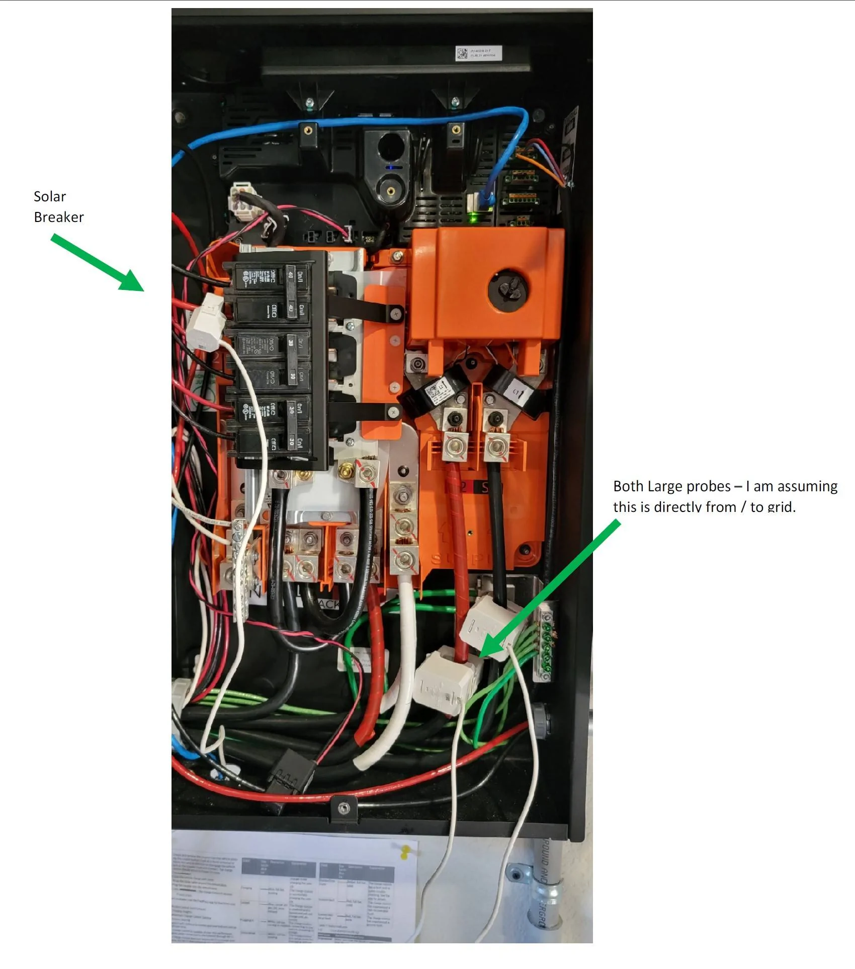

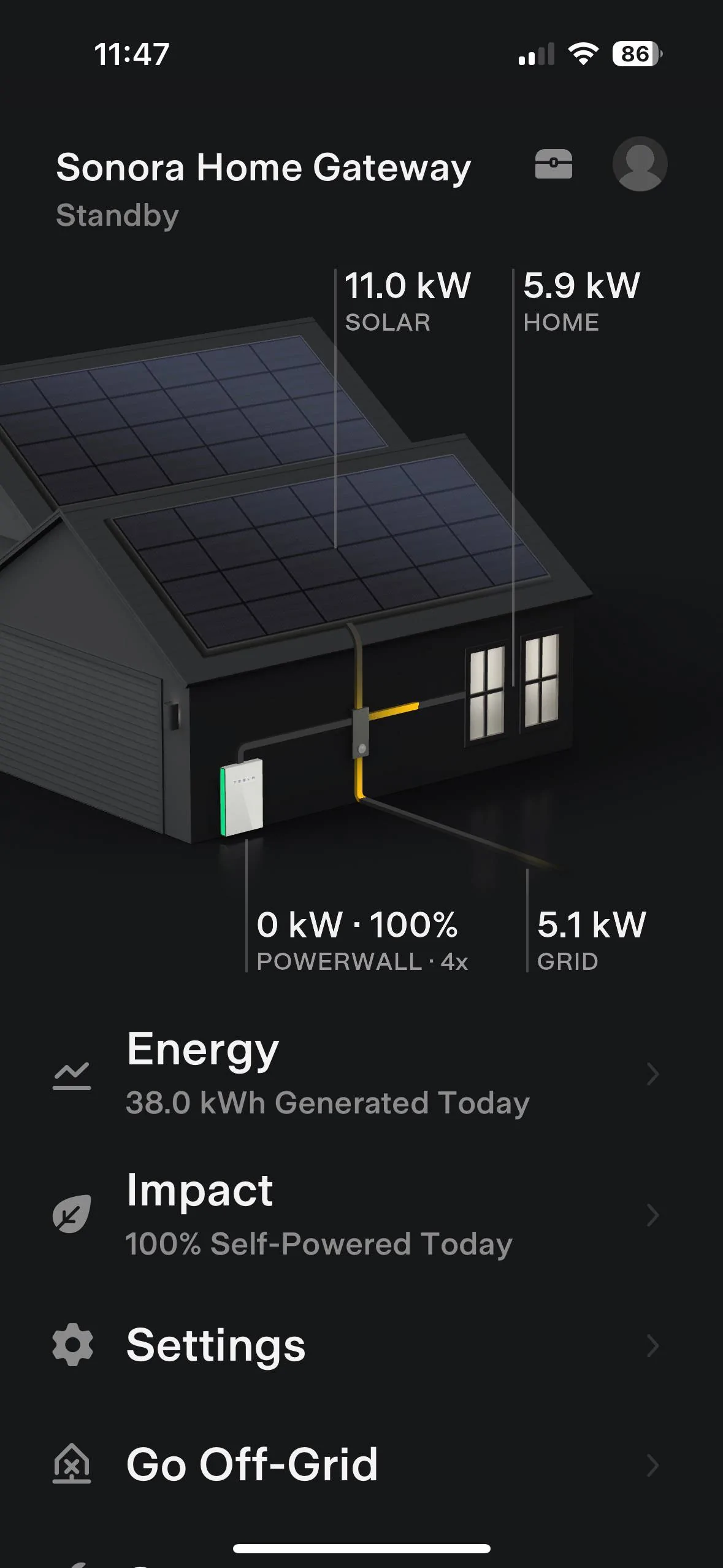

John: I should also mention that to get the Emporia charger to use excess solar energy, you need to set your Tesla Gateway Powerwall operational mode to âTime-Based Controlâ rather than âSelf-Poweredâ.Thank you everyone for the informative info in this thread. Today I installed a Emporia EV Charger and Vue Utility Monitor. I have Tesla Solar with Powerwalls. I don't think I setup the Vue correctly. I will contact support on Tuesday. Can't wait for it work correctly, managing the Ford Connected Charger and the MME with excess solar has been a pain...
If itâs set to âSelf-Poweredâ, the charger will drain your Powerwalls to charge the EV, which you donât want. @markboris can verify or correct this advice as Iâm still learning!
