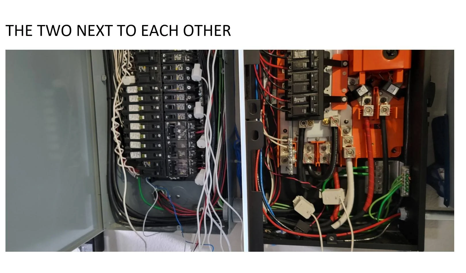

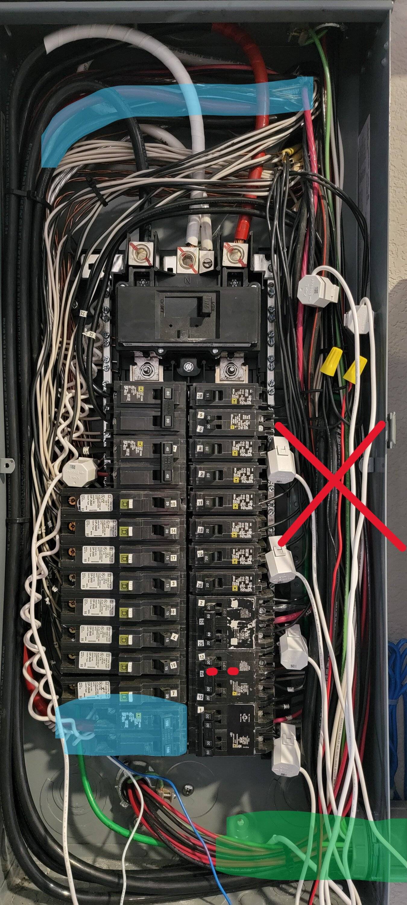

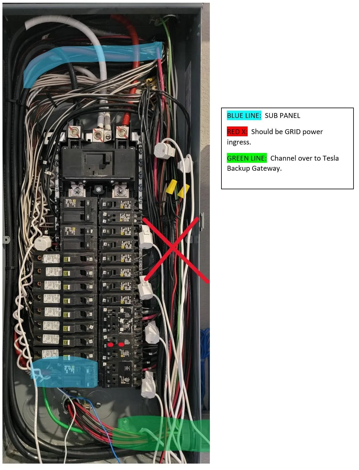

Sort of. Grid power does come in there but runs down the side of the panel and is very hard to see. They run over to the backup gateway where it gets hard to see which one of six large gauge wires goes where. All six wires go to the main service breaker panel. One set of three should be the grid and the other set should feed off the backup gateway for battery power. At least that is what I am thinking. I will take a few pics and make annotations.

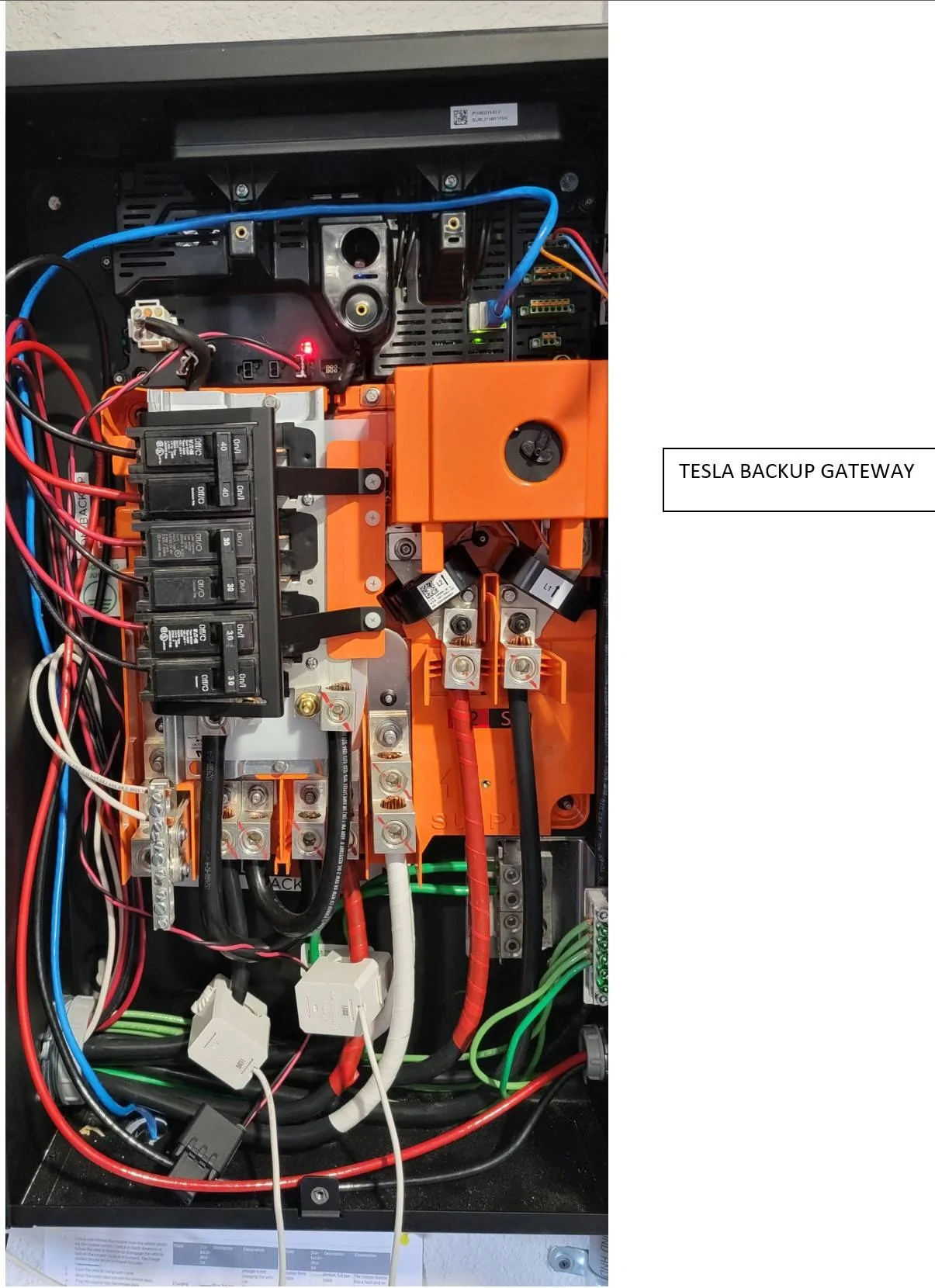

A question in regards to the probes pointing towards breakers. My Backup gateway has the two large probs, pictured below. Technically there are beakers in each direction. Currently I have the probes pointing away from the main service disconnect breaker on the outside of the house. The Solar probes are pointing at the breaker in the backup gateway. Thanks again guys I will test away
What the heck kind of panel is that? It looks like something Tesla would design.

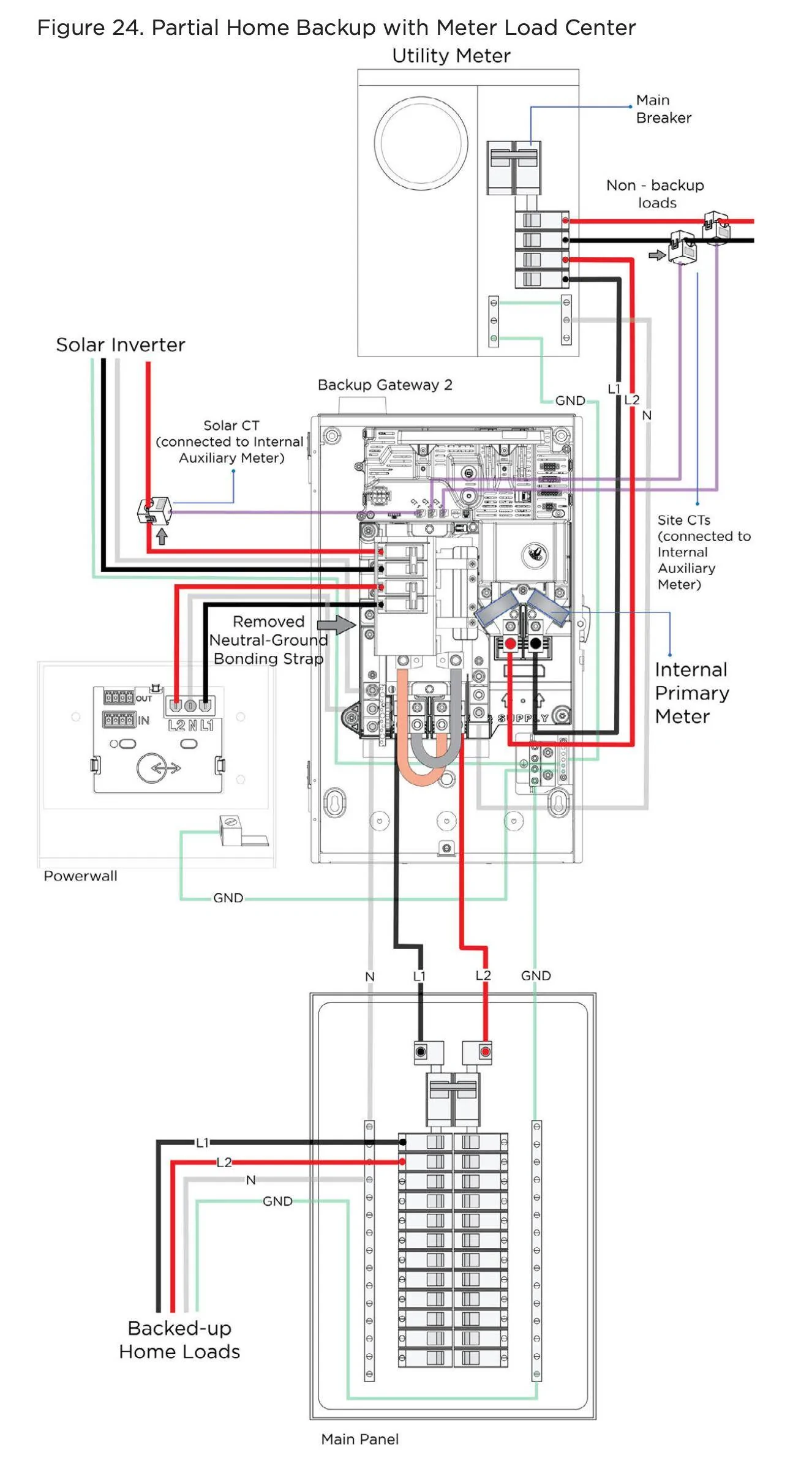

I believe this is the system diagram, not sure if you have non-backed up loads off the outside panel.
