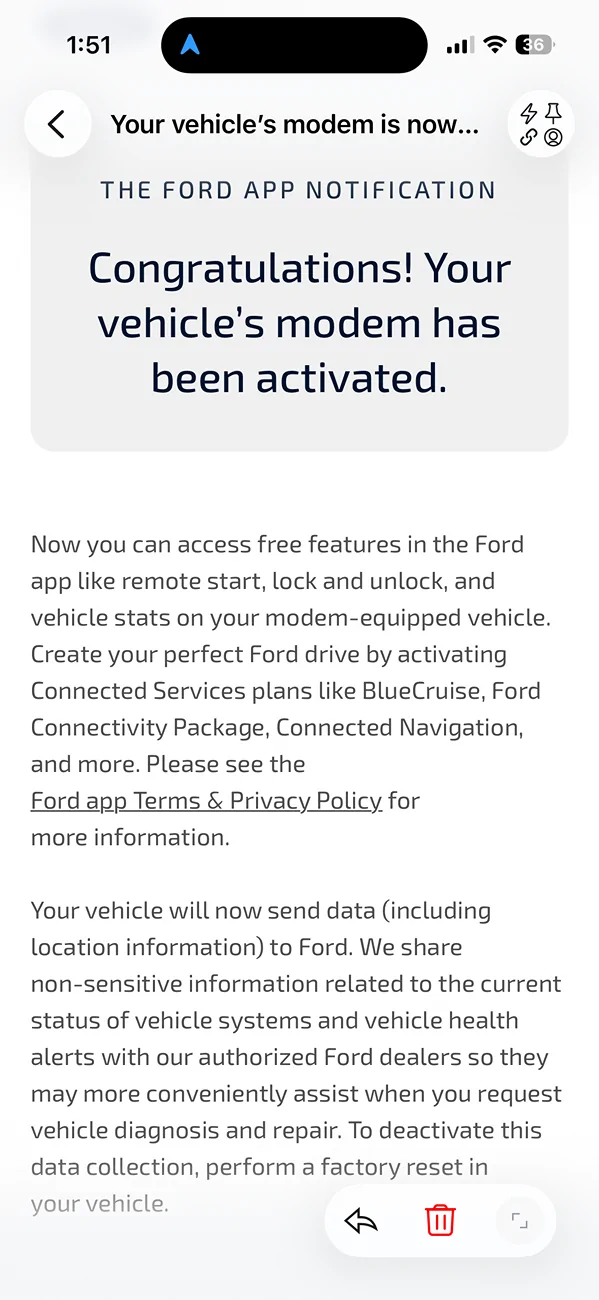

Quick update - I had the dealer complete the LED OTA recall while diagnosing this issue. Somehow the data sharing icon was back and running when i returned to the dealer. They didn’t say exactly what they did, or how they did it. They apparently didnā€˜t touch the fuses or the 12V battery. They couldn’t even give me an explanation except to say, it works, maybe it was my phone…
So, a bit of an anticlimactic ending, but there you go. I’m a bit annoyed, and relieved. Basically, in 8 months of ownership, no issues with the car at all, outside some glitches In the system.

Curiously, after activating my phone at the dealer, I received this email, which I’ve never seen before.
