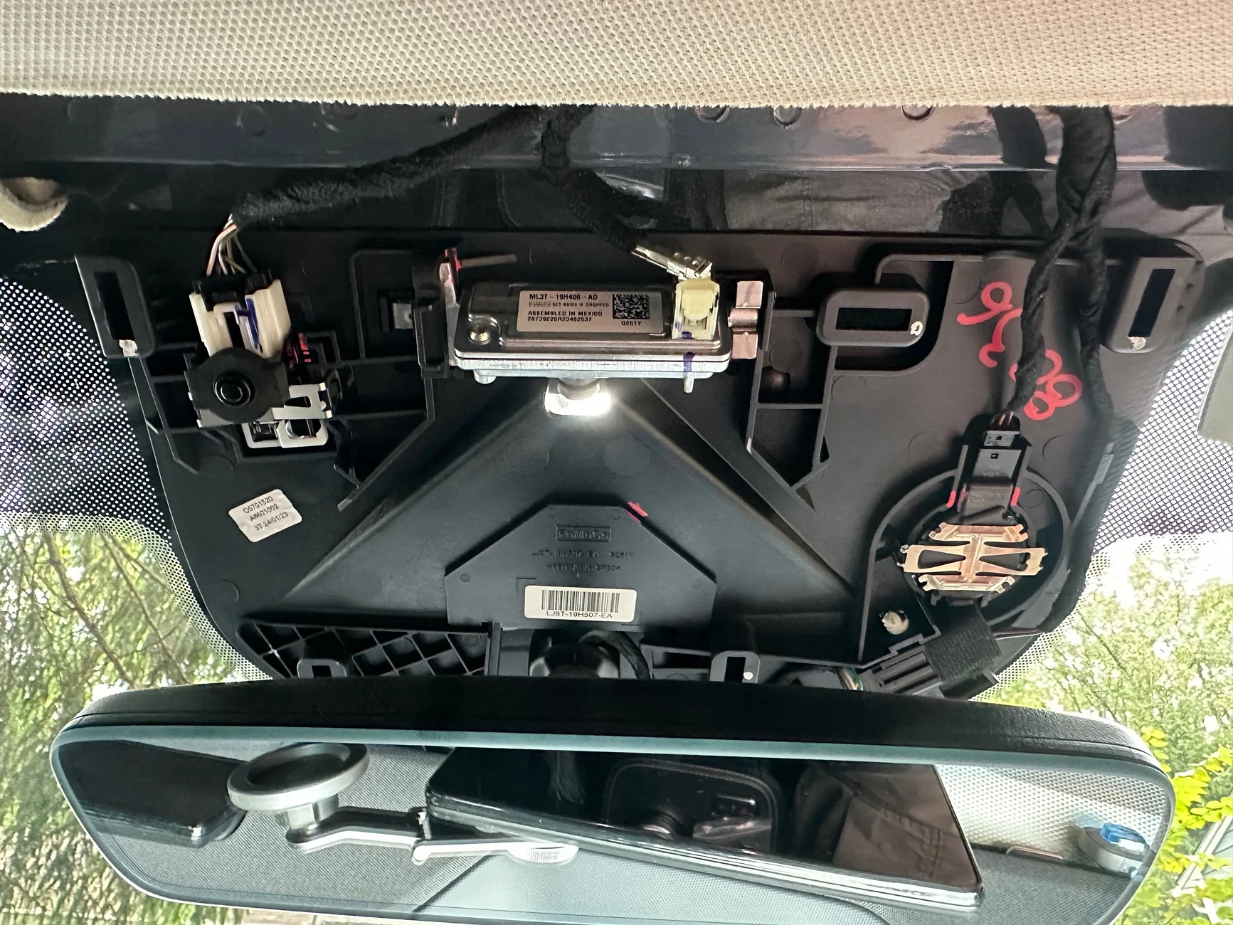

Here's what it looks like under there. You can see where the cover clips in, and the wiring connector is a bit obscured by the mirror, but you can see it there on the right.

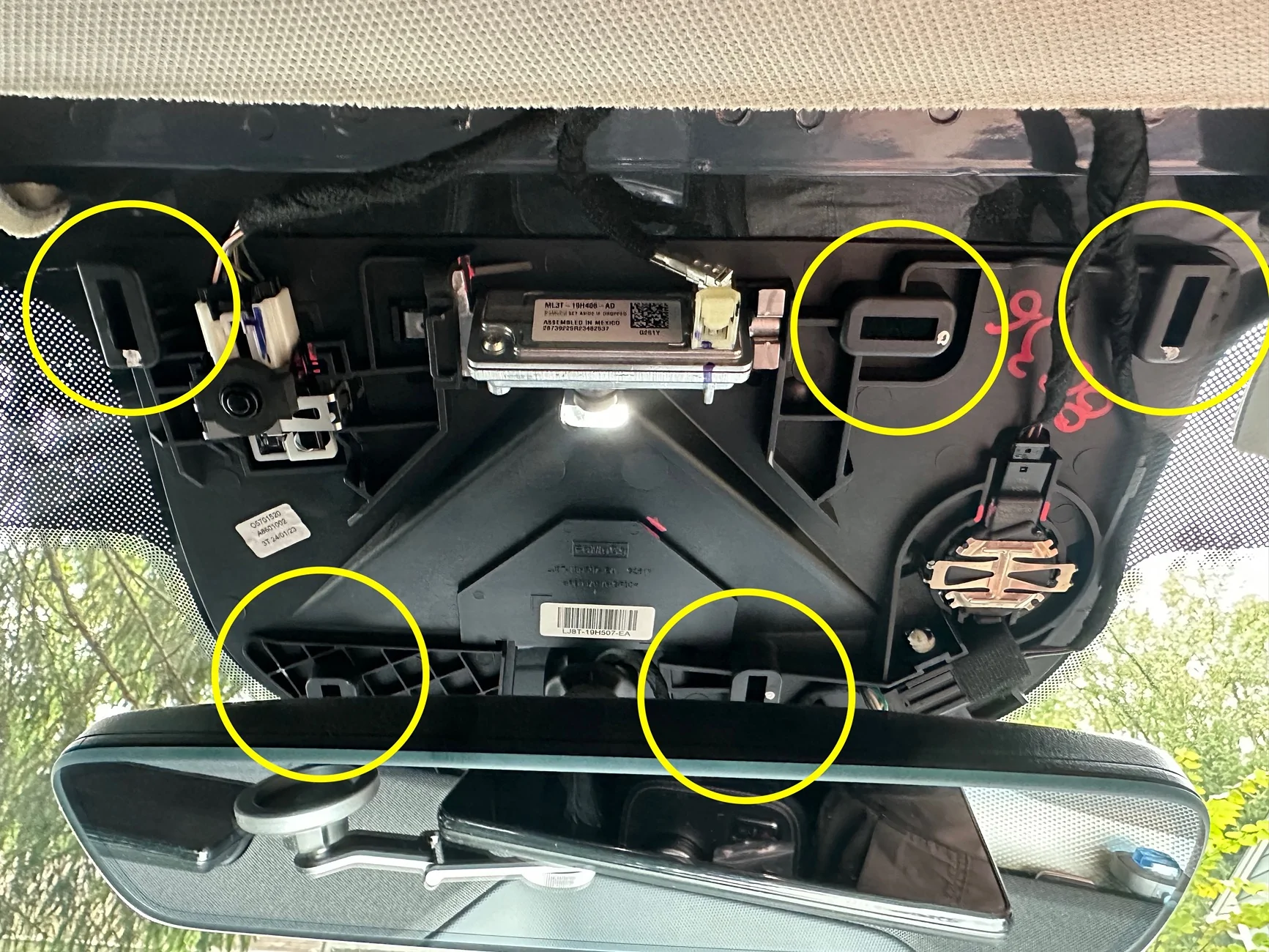

I circled the slots that the clips go into. You can see here that what you want to do is pull down away from the windshield. Start with the upper left clip and then you can really get your fingers under it.

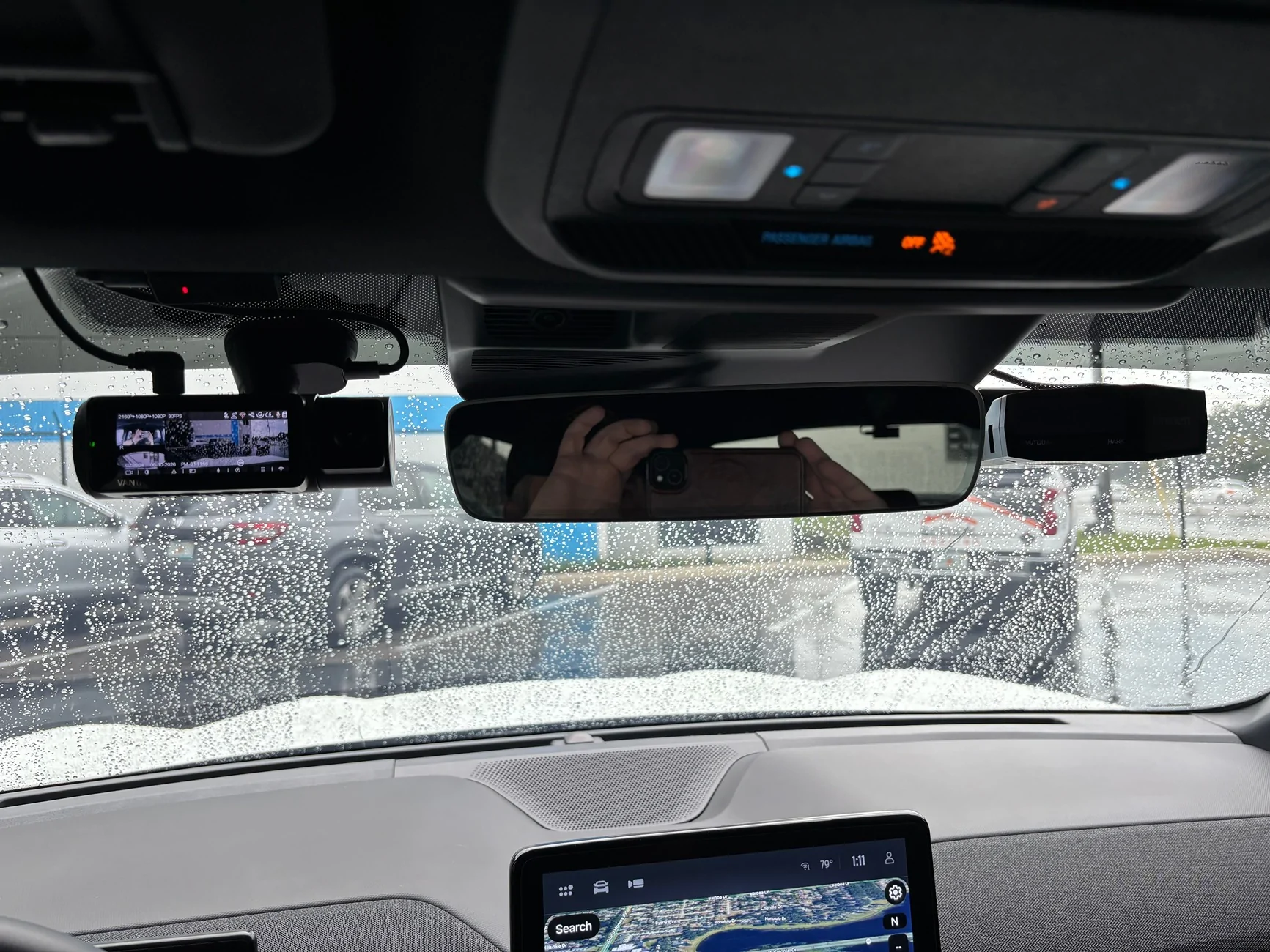

I have a 25 GT and my Uniden R8 works perfectly. I installed that as well as a Vantrue N4 Pro S using the Dongar adapter that Jesseand Tom mentioned. I installed everything after the entire windshield was tinted with the UV blocking film along with the darker strip along the top. The detector has phenomenal range, and have had zero issues since installing it about 4 months ago. I even have a Sunpass Pro portable transponder for the toll roads mounted in the upper corner behind the dark tint strip. All okay in my car.

There’s a lot going on up there! Ha!
Yeah, my daily commute is about 80 miles or so, depending on which way I go, and have driven almost 11K miles since December. The 3 channel dash cam saved me from a potential insurance scam in my other car a while back, so I believe in them (as well as a good detector)! You can see the rear facing camera in the mirror's reflection. I had to get a little creative with mouting that one inside of the car, as I did not want to mount it to the glass and have the cable exposed enough to flex with the rear hatch opening.
I used a piece of 1/16" x 1" aluminum flat metal bent to a 90, and inserted it through a carefully cut (and cauterized) slit in the headliner material. Camera (of course) is mouted to that. Just painted it black to match the interior, and all you can see is the camera, and about an inch or so of the connection cable as it loops back towards the aluminum bar. I hated to do that, but it came out pretty clean, and is positioned well. I realize this isn't related to the original post, but thought I'd share.
