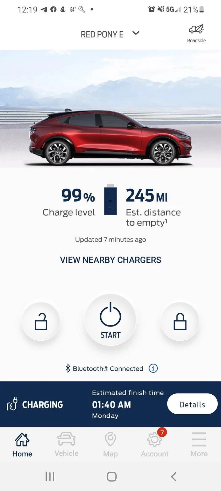

On Friday I picked up my MME that I have ordered on Aug 24th of 2020 in RWD in the premium trim with the extended battery range in red.

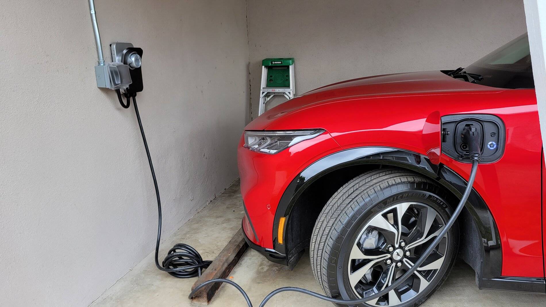

I have been charging the car today at home with a chargepoint unit.The battery now is at 99% of charge, but it shows only a 245 range. It seems that I got the wrong battery placed in the car , even though there was a $5,000 option added to the price of the car for the extended range battery, or in an hour and 40 mins, the battery fully charged it will reach a 300 range?
Any clarifications or comments?Thank you.

That is just a guess. The car being brand new to you, it doesn't know your driving history and conditions, like weather, acceleration, typical speed, etc. So it is being conservative in guessing the range. As you drive it more, it will adjust based on YOUR driving patterns and actual drives.
That's the case for all cars. It's just that people don't notice it so much in gas cars.
In short, I don't think this is something to worry about. Go drive the car and have fun! :)

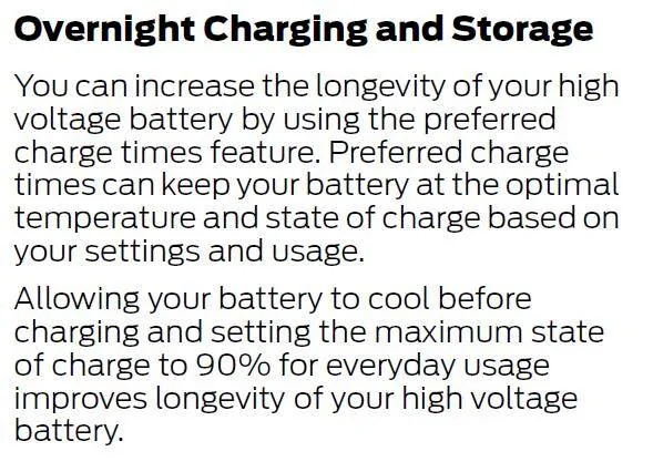

did you do the reset trip meter? Ford recommends doing a reset when you first get the car, then it will "learn" your driving habits, it will be a more accurate measure. It seems unlikely they would mix up batteries.
Also, just a reminder, Ford recommends your home charging should max out at 90%. this is probably just them being conservative, this is the text from the manual.

The GOM (Guess O Meter) on the Mach E is extremely conservative. Almost to a fault. My ER AWD Mach E keeps showing just over 200 miles on a full charge that I know is ridiculously conservative. There are already rumors out that the GOM will be improved with the first OTA update.
